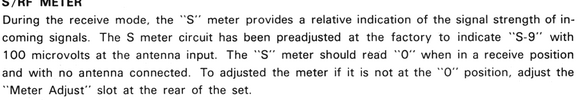

Assuming you have the S-9 setting done as well?
I would check the 2-1N34 diodes connected to the meter circuit for forward voltage. Should be very closely matched.
David

I checked the one diode close to the meter, the other one I couldn't find... Dan

Dan,
It just occurred to me that the Teaberry has a switch under the meter for "S" signal or "RF" reading (where the Robyn is a "Range Expand" On or Off). Perhaps the switch is a bit flaky??
David
