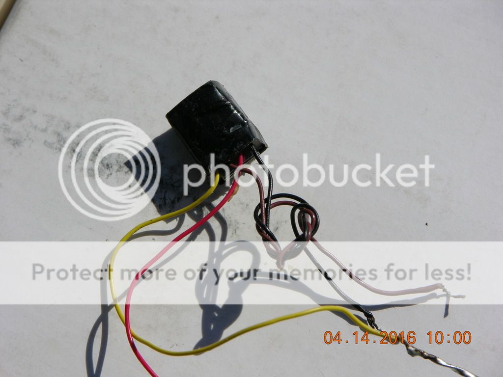

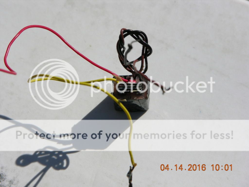

I have piles of Electro-Voice microphones that need this matching transformer. Has anyone found a suitable replacement with a 4:1 impedance ratio since Telex sold Turner?
The new manufacturer of the Chinese built Road King 56 refuses to sell parts. Here Is the transformer:

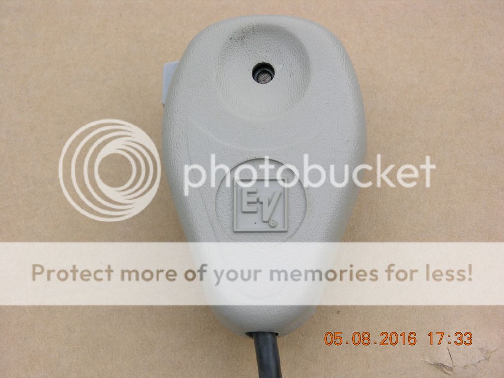

Here are a couple of the Microphones I am trying to impedance-match:

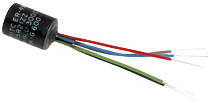

Maybe this fella will workView attachment 18032
5/16" diameter.
Sold here:
http://www.surplussales.com/class/inductor/audio_sealed_lowimp_transformers.html
About the 7th one down on the page.

You beat me too it. i did a Google search and was working my way down the page from Hammond to Digikey and was looking at Surplus Sales and thought "AH-HAA That is what he needs" then I came here to spread the good news but you beat me too it. LOL. (y)
