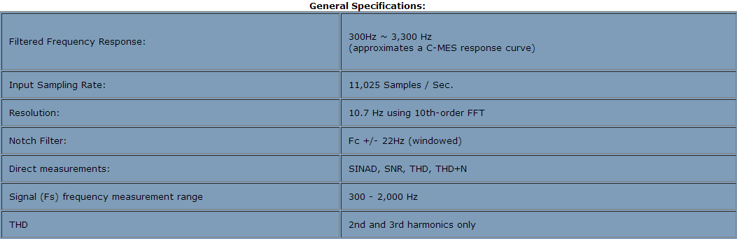

One more tool you might want to consider is ComTekk's SINAD v1.20. Using a SINAD ('SIgnal to Noise And Distortion ratio') meter to adjust receiver alignments can make a considerable difference. Or, using a real SINAD meter will accomplish the same thing. Less noise/distortion; same signal strength. I think the ComTekk SINAD software is better than a meter, as it has many more usable features than a real meter does - IMO. Not too hard to figure out and use as well . . .
ComTekk SINAD - Distortion Analyzer
