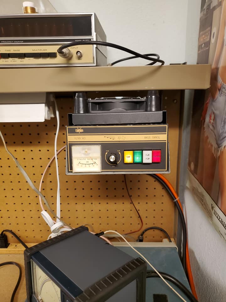

On both of my 667V's, I bypassed the two fuseholders and installed a single inline fuseholder on the positive lead going to the power supply (since I run them on a base radio). I run 18W PEP SSB into them and I just run it on low with the variable wide open (which is also my recommendation, BTW... run the variable wide open). I also run a fan kit on mine and the amp is ran upside down so the warm air rises up off the heatsink, and the fan exhausts heat up off the heatsink as well. The amp doesn't even get warm to the touch even after I yack on it for a couple hours.
