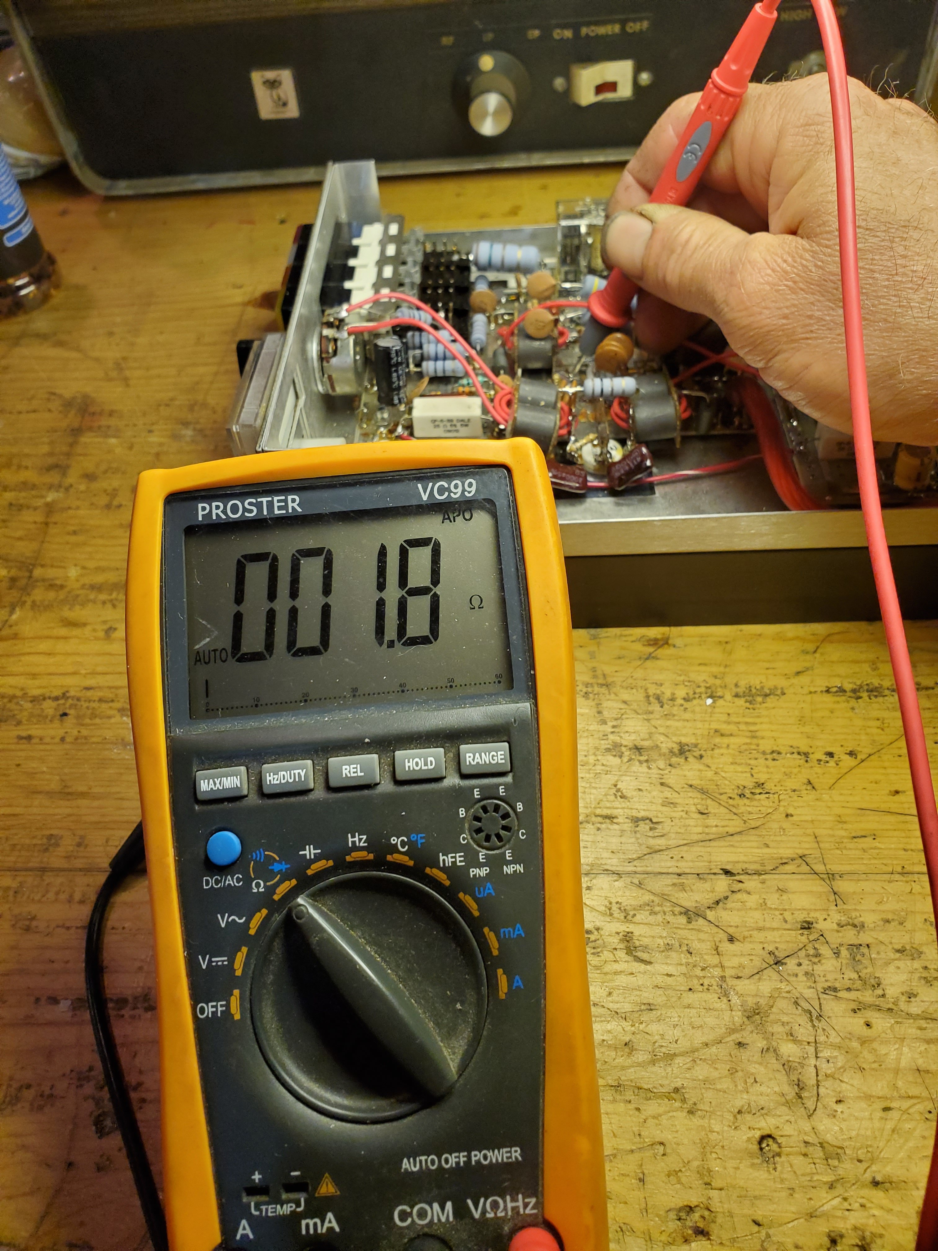

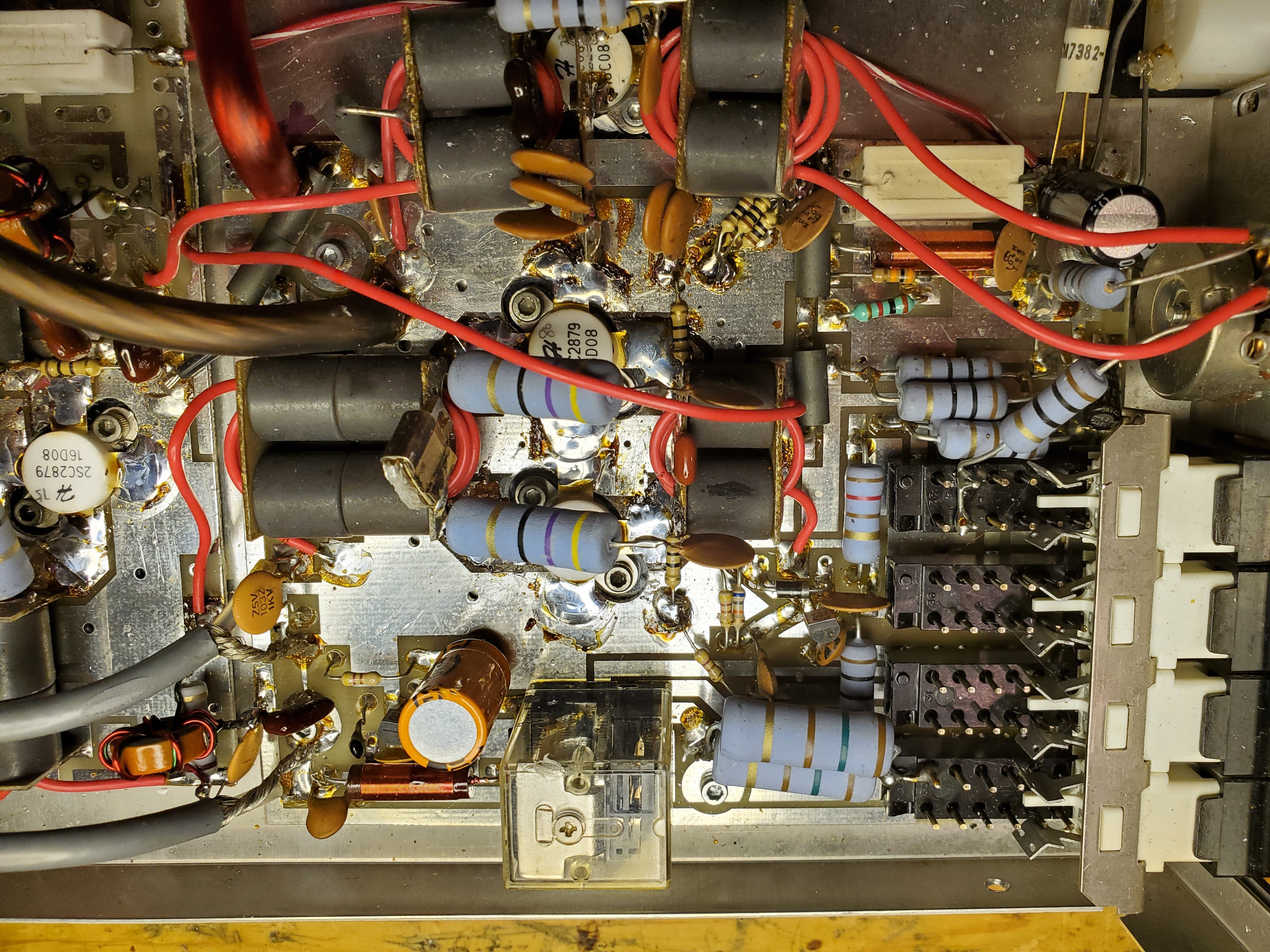

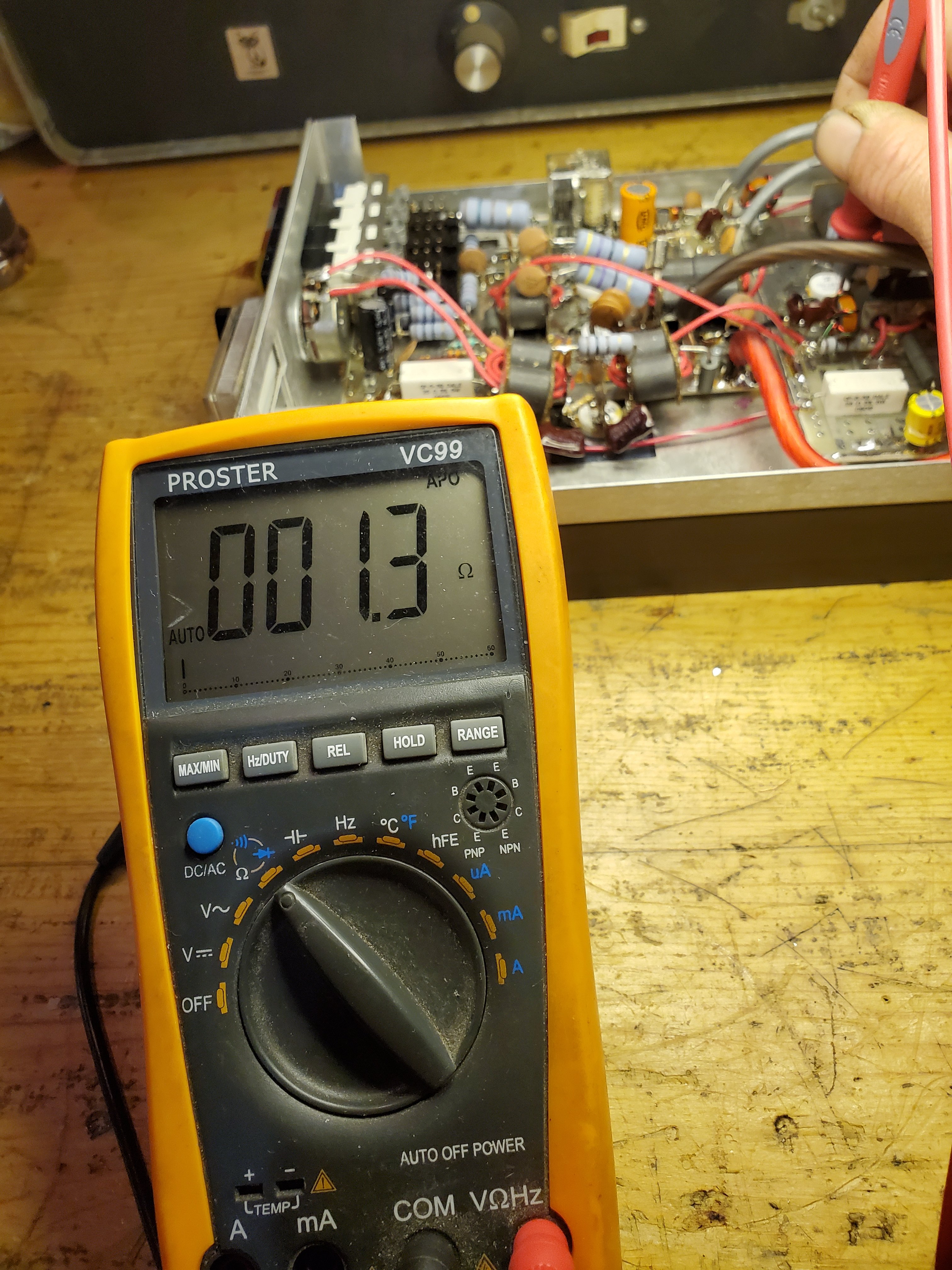

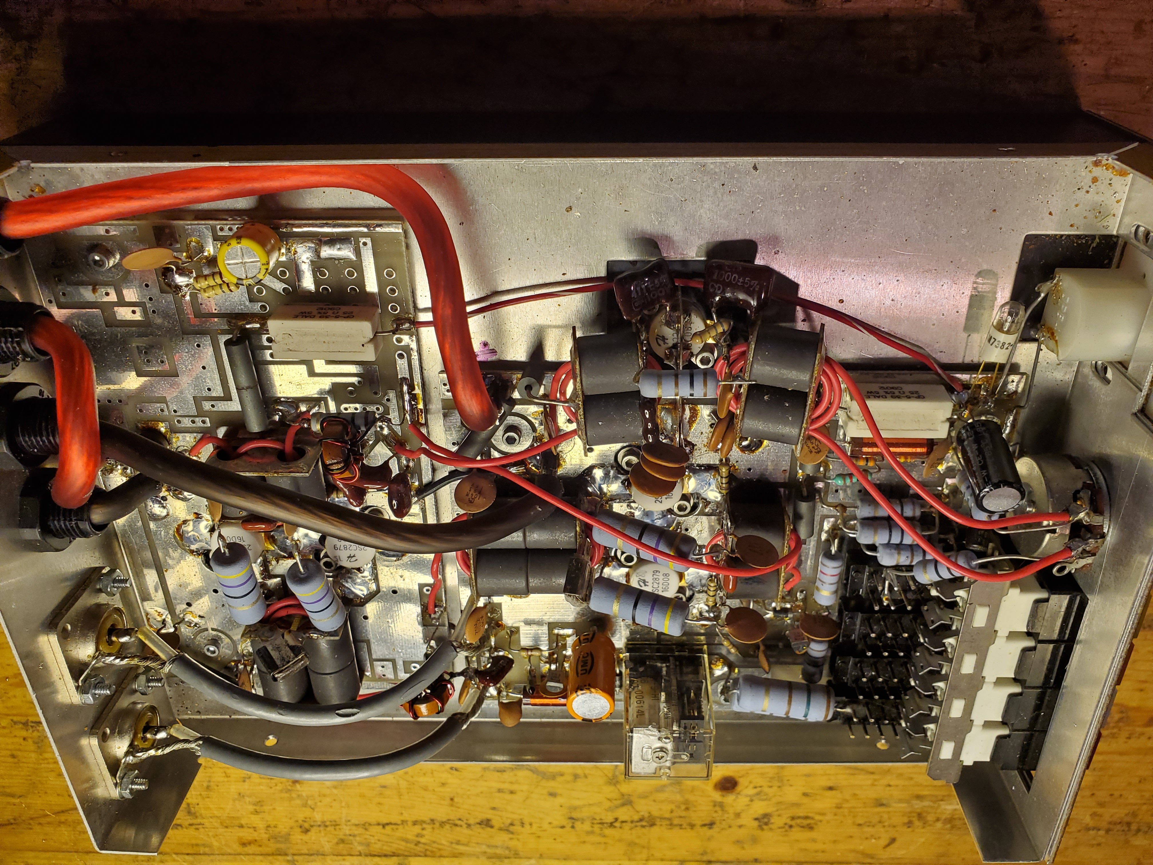

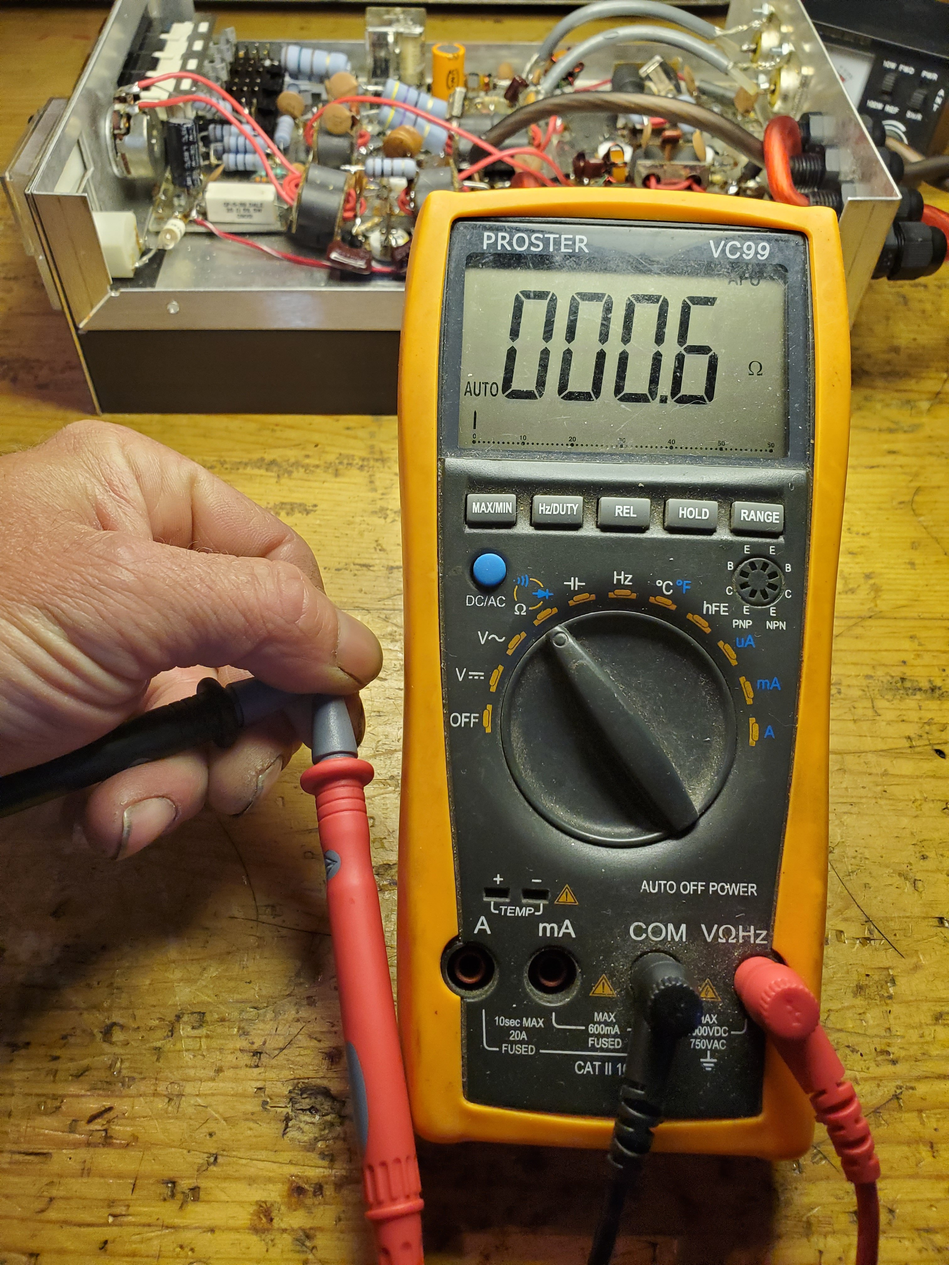

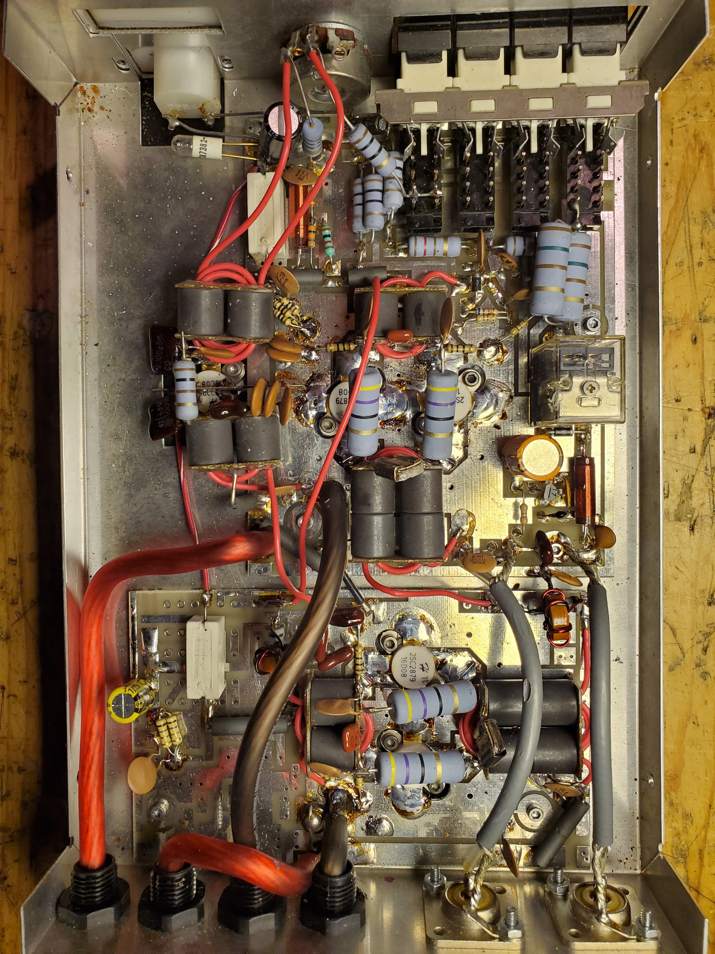

Pics per request and yes my multimeter read up to 000.8 ohm with the prongs together and I know the resistors are not to be doubled up like they are, I am just testing this to see if I could get better readings. It didn't test as bad today as I thought it did before but I bet it will go back after I replace these resistors but possibly it's just the multimeter is off ! However last time I put power to the unit the 10 ohms turned into candles and blew 2 brand new HG's so now I am scared lol !

I am going to put the resistors back in the unit like I had it before and test again, I should be subtracting the 000.6 ohm from my readings then or grab my other meter and check again probably
