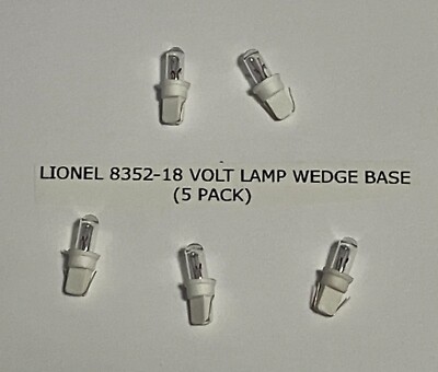

I used Lionel 8352-18-Volt Wedge Base Bulbs and bought them at a hobby store for $1.00 each. Then I replaced the base with the texas star push in base. You should be able to get the bulbs without the base BTW.
Example:
Well there are two different types, the wedge that fit into the socket of the older units made up until about 2014-2016 and then there's the current kind of Mickey mouse switch bank where a pin ball machine bulb is soldered in.
The solder type I found doing a pinball machine bulb search. The wedge as shown above might be your best bet.
Part number, who knows and it's like pulling teeth sourcing anything from Texas star through any of the wholesale joints.
Maybe give John at galaxy a call and get the scoop.
