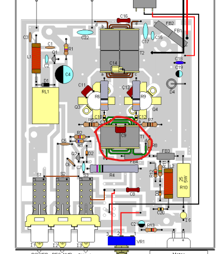

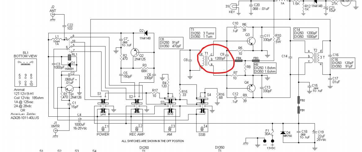

I’m sure this is covered elsewhere but I’m struggling to find the info I need. What position is the input capacitor in on a dx250? I’m working on this amp and have high input swr. I’d like to replace the cap with a variable...location and size of the variable would be awesome...thanks guys!!
The input is C9 @ 1200 pf
