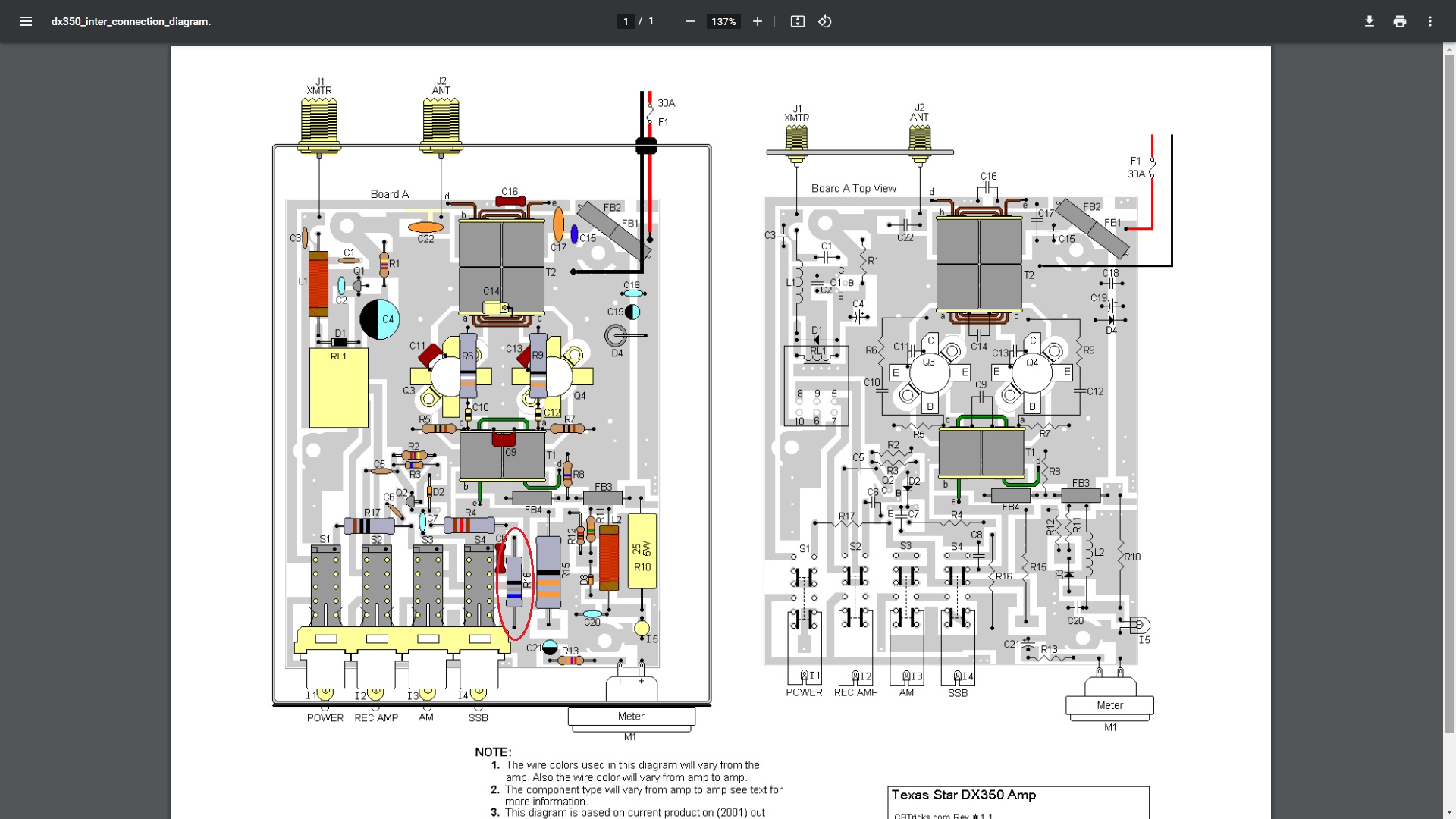

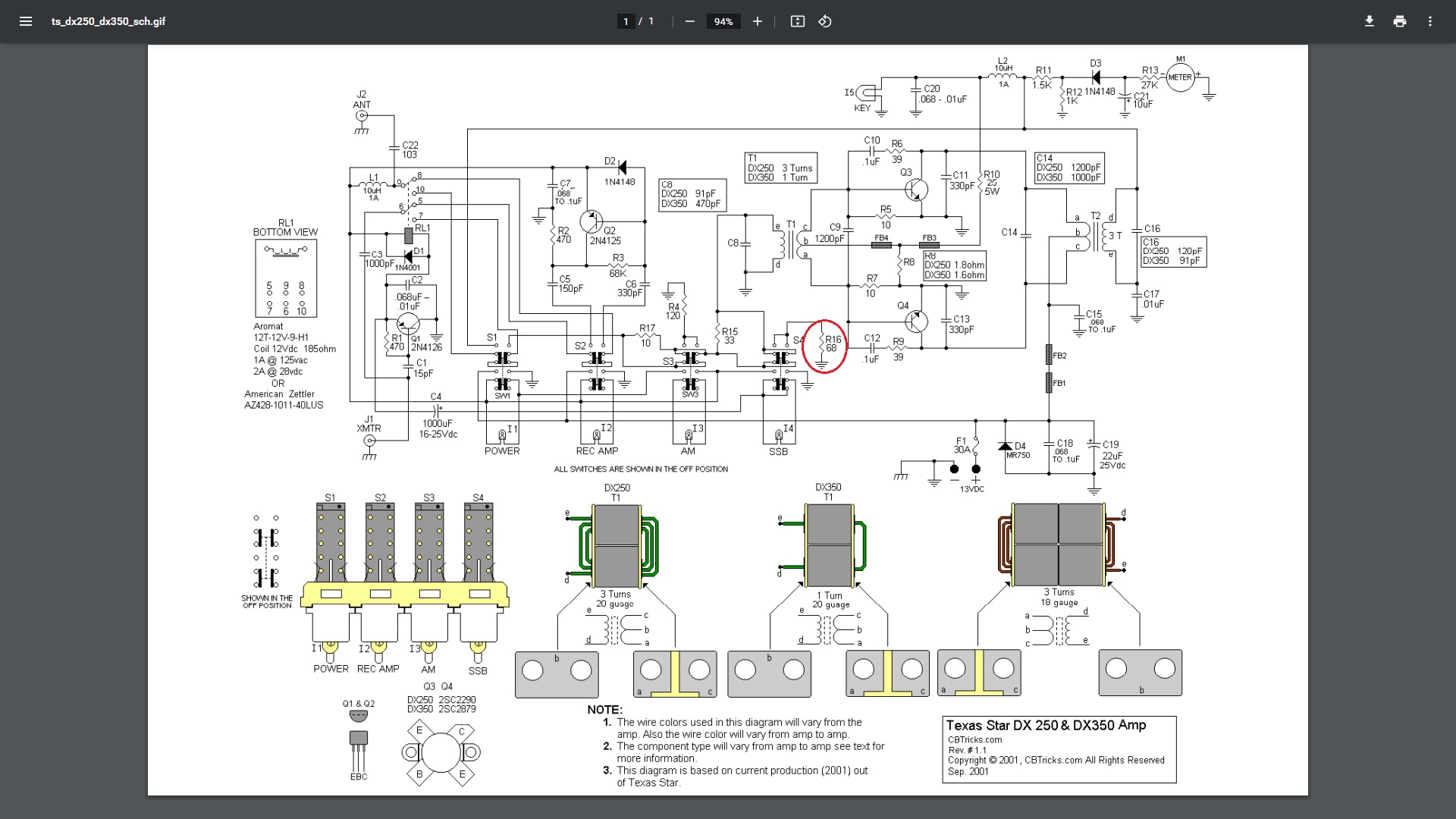

This is the resistor in question.
Reactions: Eldorado828

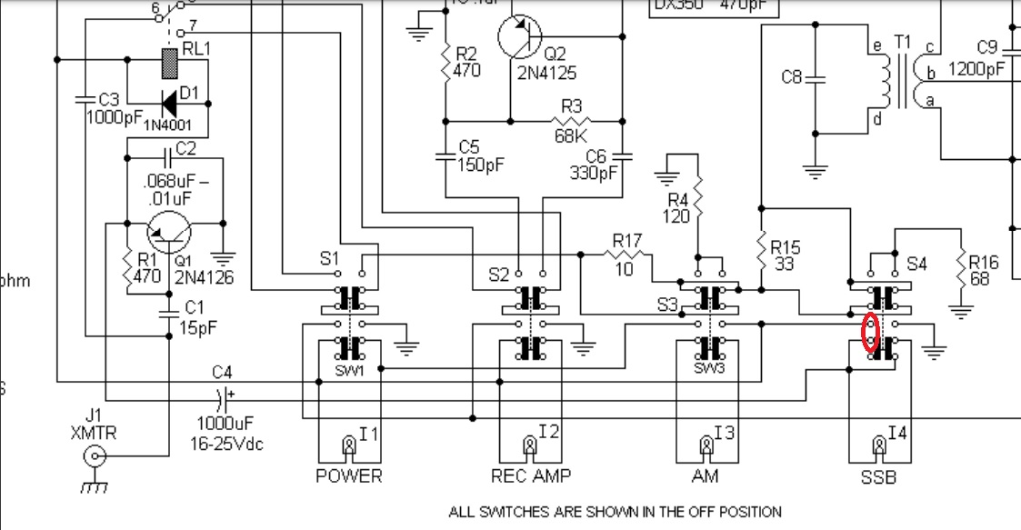

Thank you, Jeff. It sure is an awkward design. It appears I can simply bypass the ssb delay (and accompanied resistor) by adding a jumper between pin 2&3 on that gang. This will give me full power but also give me a delay at all times. I can install a toggle switch in the back to turn that on and off.
I don’t understand the purpose of this design but it appears I’m not the only one.
Thanks for the help. Unless otherwise suggested. Il will do this mañana.

I've done it to a couple texas stars. Works perfect with a switch mounted on the back panel wired to those pins in the red circle. Full power SSB with delay and no pushing in the button obviously.
The 4 power levels on AM are:
green & yellow buttons IN is LOWEST power output
yellow ONLY IN is next higher power
green ONLY IN is 3rd highest power
green & yellow OUT is HIGHEST power

I wasn't happy with losing the full transmit power when I kicked into ssb. I never bothered to run a switch for the full power delay. I figure that if I need lower transmit power I can always push a button and reduce power that way. I really just wanted to be able to run WFO with the ssb delay.
Be sure and listen to it on another radio before and after.
The designer combined those two functions on the SSB button because sideband doesn't tolerate overdriving the transistors as well as AM mode does.
If you're okay with how it sounds, that's the opinion that matters, right? The drive gets reduced by that button to reduce flattopping. The peaks of your SSB RF envelope get clipped with full drive. The resistor reduces this effect by reducing drive level.
And a glance at this with a 'scope would confirm my suspicion, that peaks are getting flattened with the a jumper on that resistor.
Then why doesn't DX350HD drop the output power on SSB?
Either the factory changed the setup, or someone did after it was built.

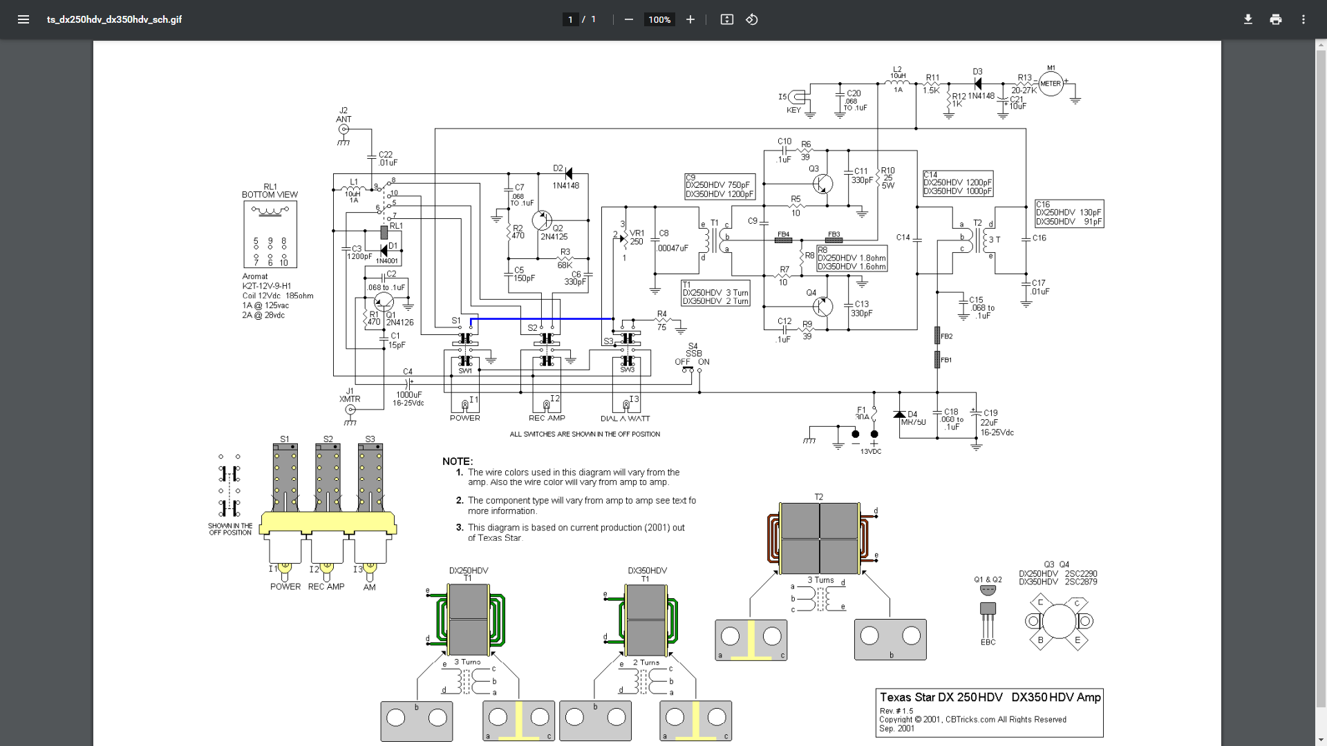

Original schematics for Texas Star amplifiers, and for the last 40 years or so show the relay delay and drive-power cut combined in the sideband button switch.
And if they changed the way it's produced , I'll only hear about it this way. Don't see a lot of late-model Texas Star amps these days.
Reactions: 999

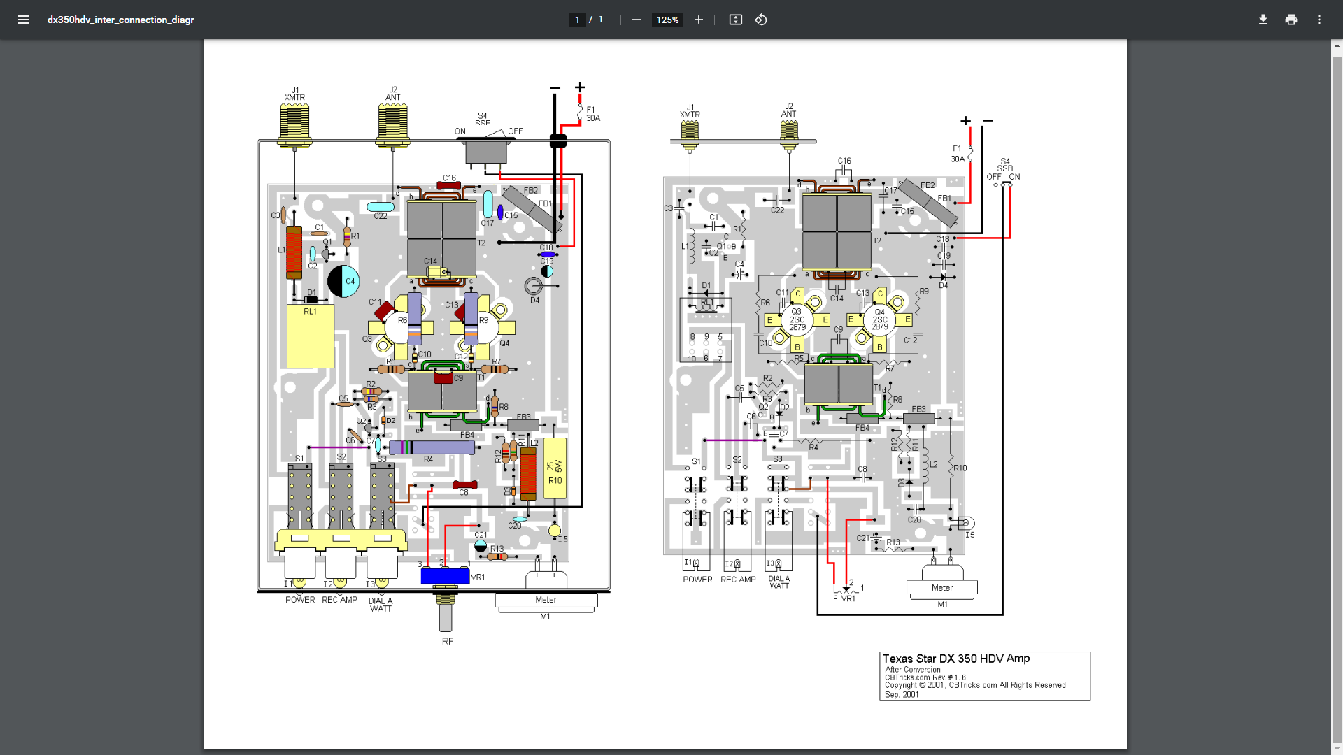

This is the schematic for the HDV 250 and 350. Note that the switch (mounted on the rear of the cabinet) only controls the delay cap with no power level setting. This is how they manufactured the HDV 2 transistor amps for decades.
