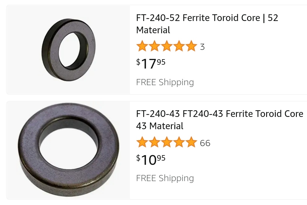

At one point I was unable to locate a 52 under $20 each.
Add in the shipping on these eBay examples and the price is still high.
https://www.ebay.com/sch/i.html?_nkw=ft240-52+&_trksid=p2380057.m4084.l1313
And here is examples of Amazon.
Clearly my frustration bled through on the 3x to 4x price thing, but stacking 52's at $18 each starts making a wire antenna slightly costly.
