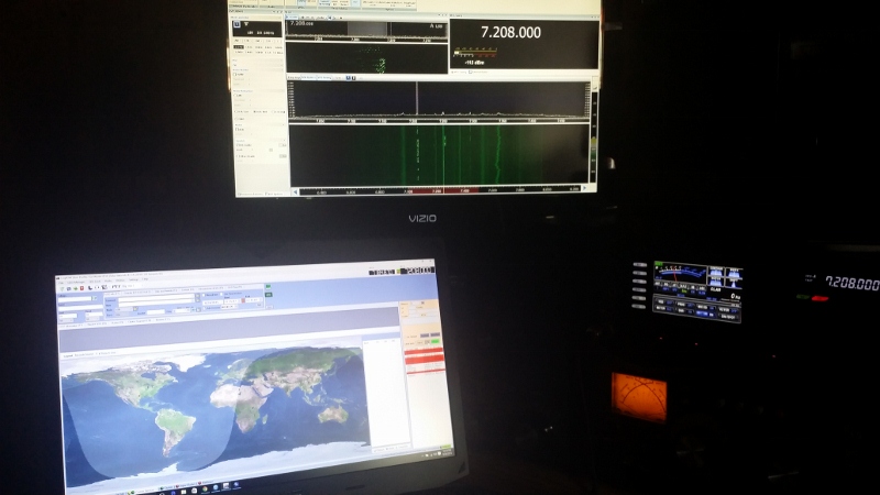

Well, it's been a long time since I posted about this! I actually tried a Soft66RTL2, and it worked ok. I ended up deciding to buy a SDRPlay, mainly because it has filtering, 8 mHz of bandwidth, 12 bit processing, and only costs 150 bucks. I plan on running it with SDR-Console, which is a pretty impressive software package. It is written by the same Simon Brown that wrote Ham Radio Deluxe, so I know it's got to be good. And the software is free at this time, so I'm going to roll with that. I found another FTDX-3000 user that has his SDRPlay hooked up to the RX out (rather than the IF out) and says it works great as a panadapter. I should receive the SDRPlay by the end of the week. Hopefully I'll have time to play with it and get it set up correctly.

I've seen those, but aren't they a R820T (or similar) dongle with an upconverter? I considered going that route, and to get a panadapter for that minimal price is a heck of a deal. However, I'm still dabbling around with SDR, and wanted to get something with some filtering in it. The dongle that I have now gets overloaded very easily, and I get false signals. I'm hoping that the SDRplay will let me play both with a panadapter, and as a seperate receiver when I want to.

I did a lot of reading on what seems like a bazillion SDR's out there, and did read the comments from the first link. I also read some forum comments from an SWL forum, and the author of the video you are talking about said he didn't use the proper driver for the SDRplay when he tested it. The 380-420 mHz gap that they complain about (where all the UK police play) has been remedied recently with a software update. It was not an issue for me, since I'm only using it for HF.
People can argue these things until the cows come home... this one is more sensitive, this one has better selectivity, this one has this feature, this one has that. I'm very happy with my purchase so far. It was 165 dollars total with shipping, is in one neat/tidy little box, and I hooked it up to SDR-Console and it worked right on the first try. The receiver is not as good as my FTDX-3000, but offers me some flexibility that I didn't have before, plus it gives me a point and click panadapter for hunting stations. Pretty cool stuff, that used to cost a fortune to set up!
