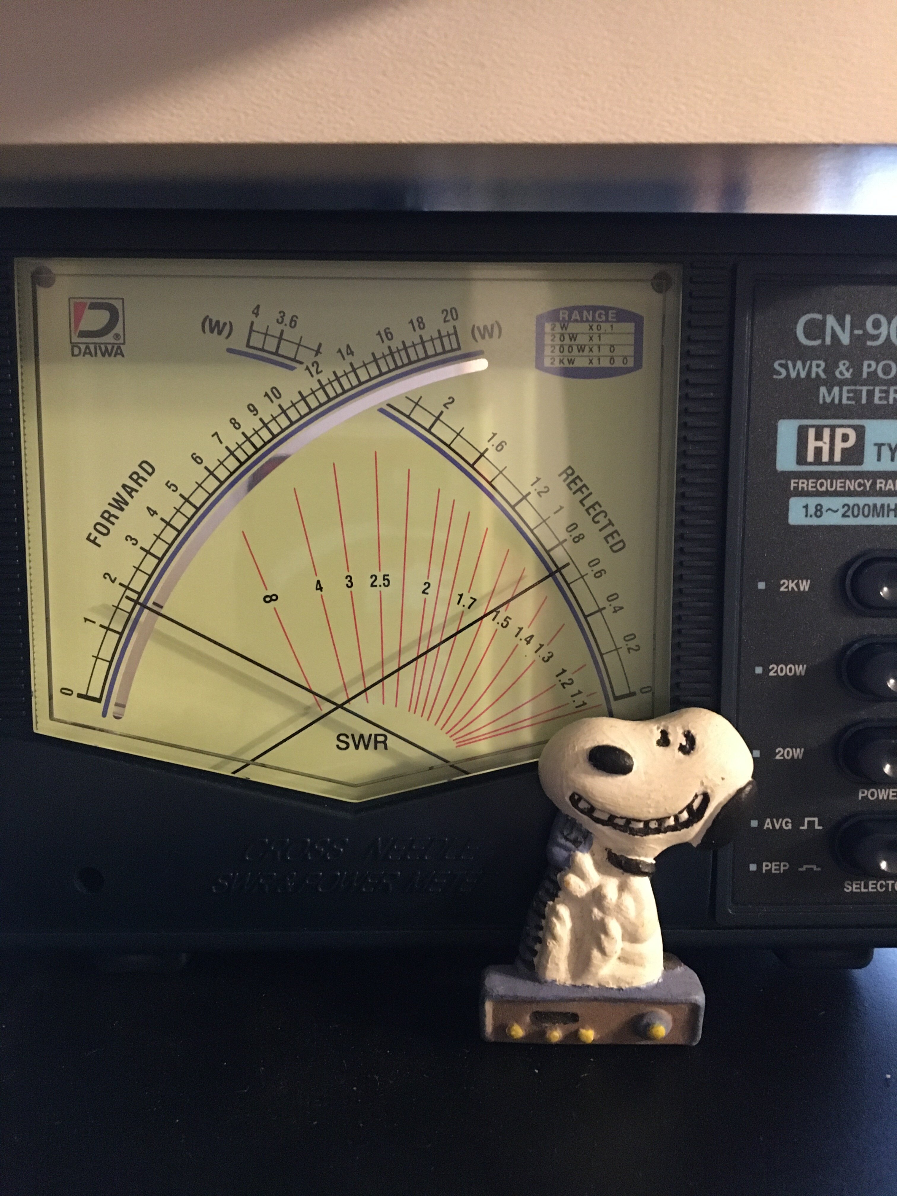

Here is the SWR on lowest 3/4w dk power with amp on.

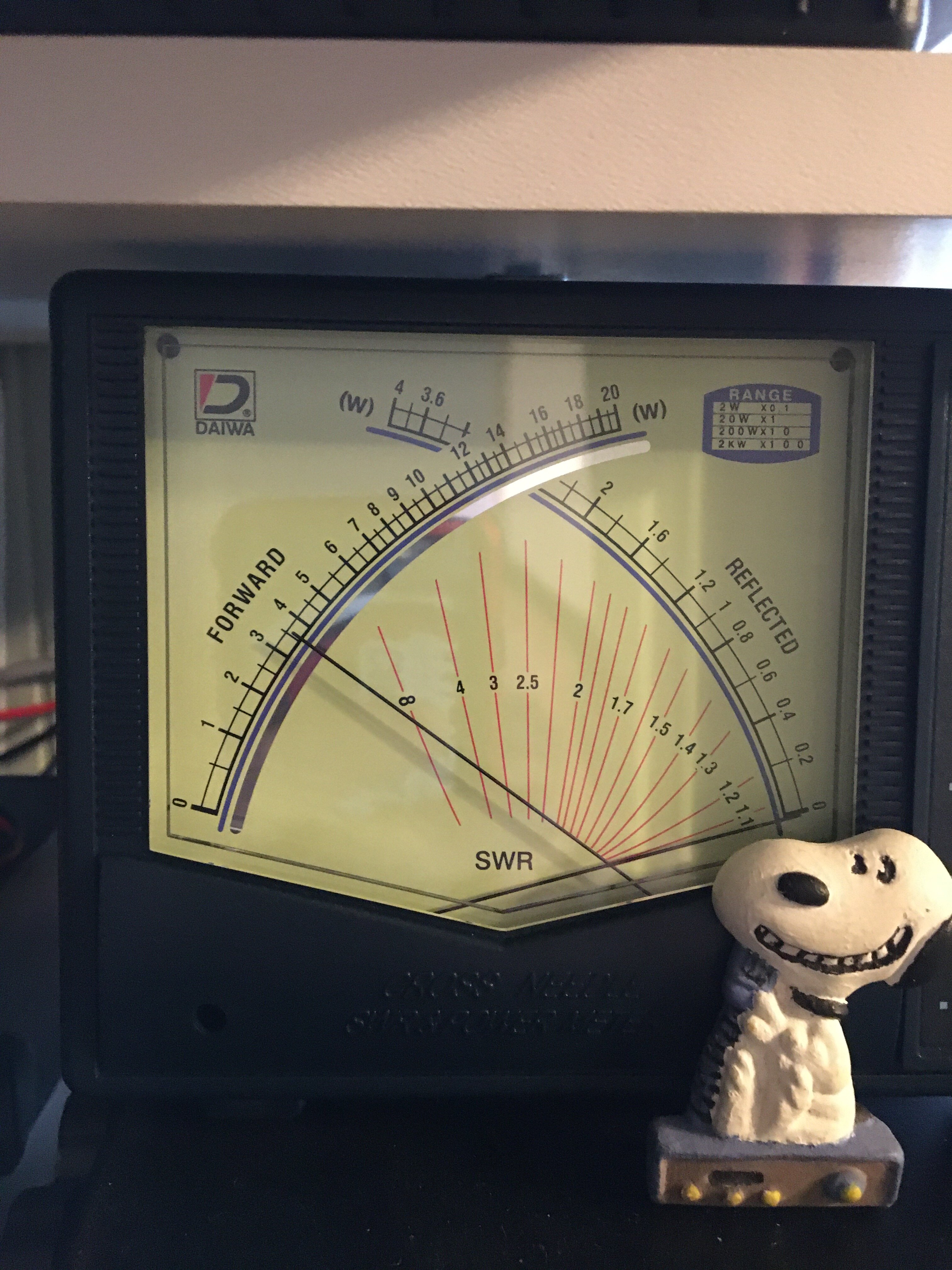

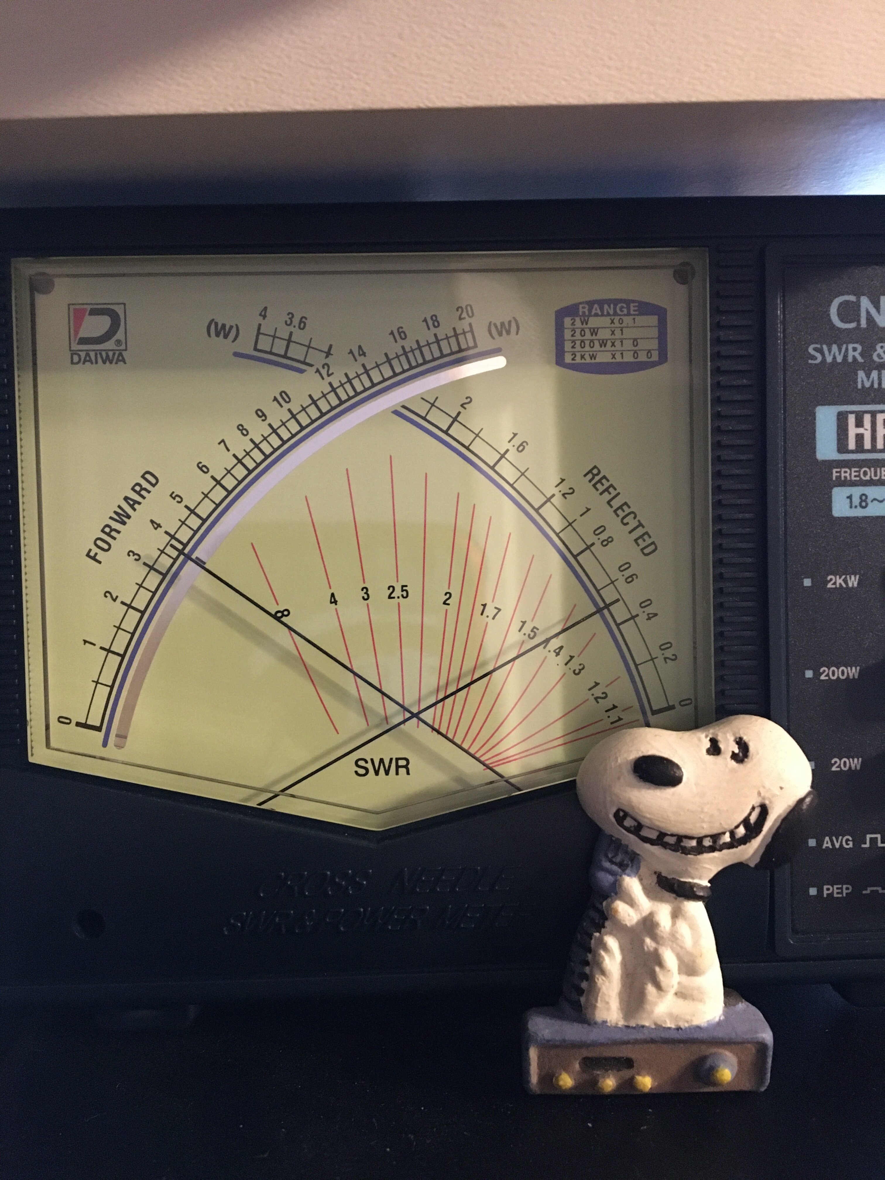

Here it is with higher 7-8w dk and amp on. Shows as 1.9:1 on the radio display. I still get about 50-60w I'd swing on PEP mode. To like 475-500w.
Starts at the 175w dk and swings to like 350w pep with the 3/4w dk.

What’s the plan for now, CB? I think I’d be a bit uncomfortable running HGs at those SWR levels.
Do you think the amplifier is generating harmonics that give the higher reading?
From what I can see thru messenger Carl hasn't been online in like 2 days. As my last messages are not even received yet. So I hope he is well.
Probably stick with SSB with it for now. Or run the 296 with it if I decide to do AM mode. Like you said I don't like the high SWR either. Still waiting on RadioWorldUK t send me my Sirio 2016 missing parts so I can get that up and hope it cuts my SWR issues and high qrm issues too.
I dont know if someone said it yet but you need to put it on a dummy load and then look at the numbers. It will help rule out any variables.
I need to find a nice high load. I currently have none and have to buy car/truck tomorrow as my trucks been in shop a month and I'm done with the shop. After that gets squared and I get funds I will check out getting one. Need a 300w one at the minimum. I know my A99 has had issues when the wattage goes up. Thinking it just sucks with high power.
