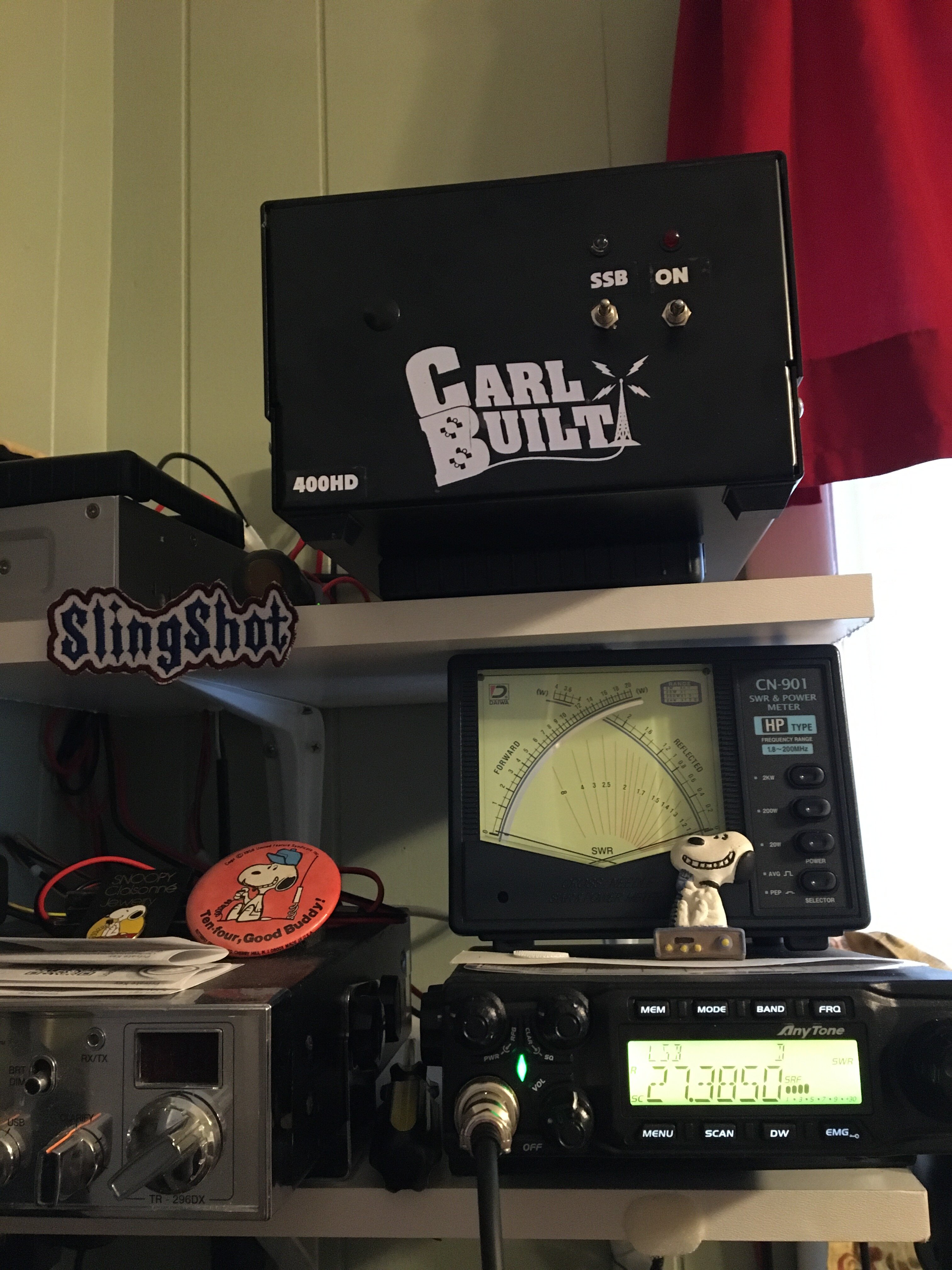

Thinking CarlBuilt 400HD for AT6666 combo

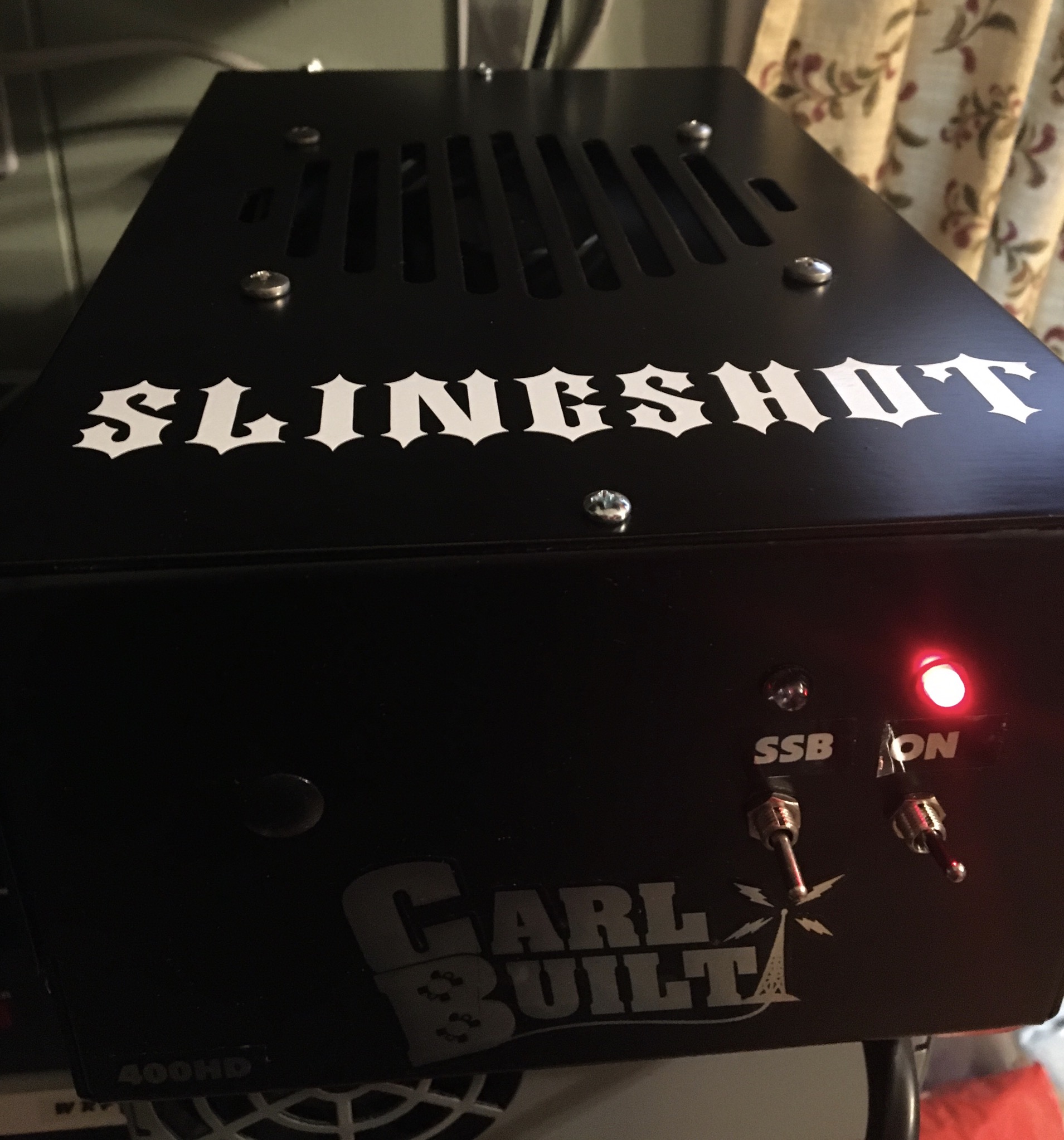

Had a decal made while I was waiting for the amp to arrive.

Only downside this far is fan level. Kinda loud. Great air flow. Moved to top shelf. PS is on bottom. I'll take the nice easy swing to 500-525 without hollering in stride though.

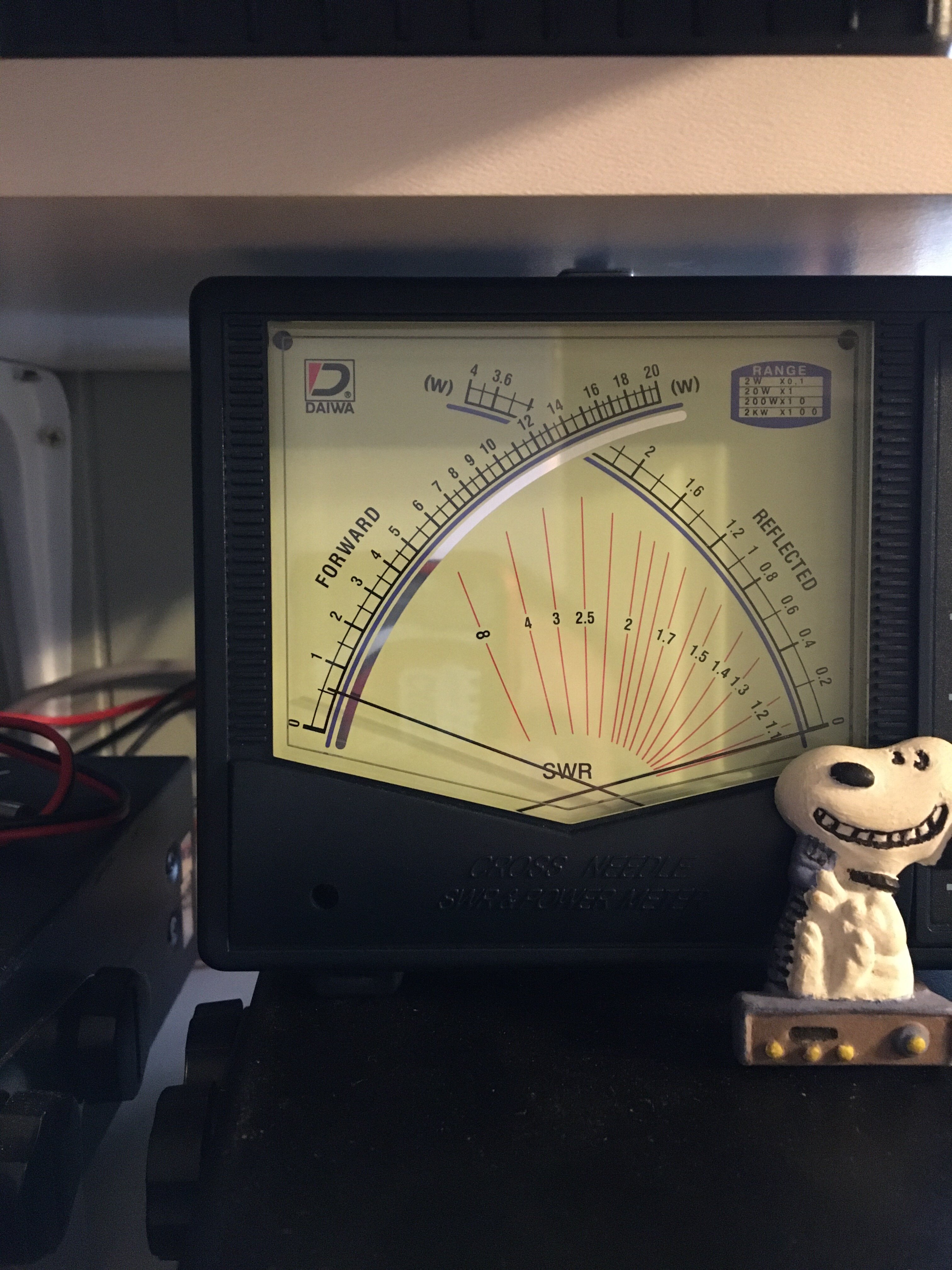

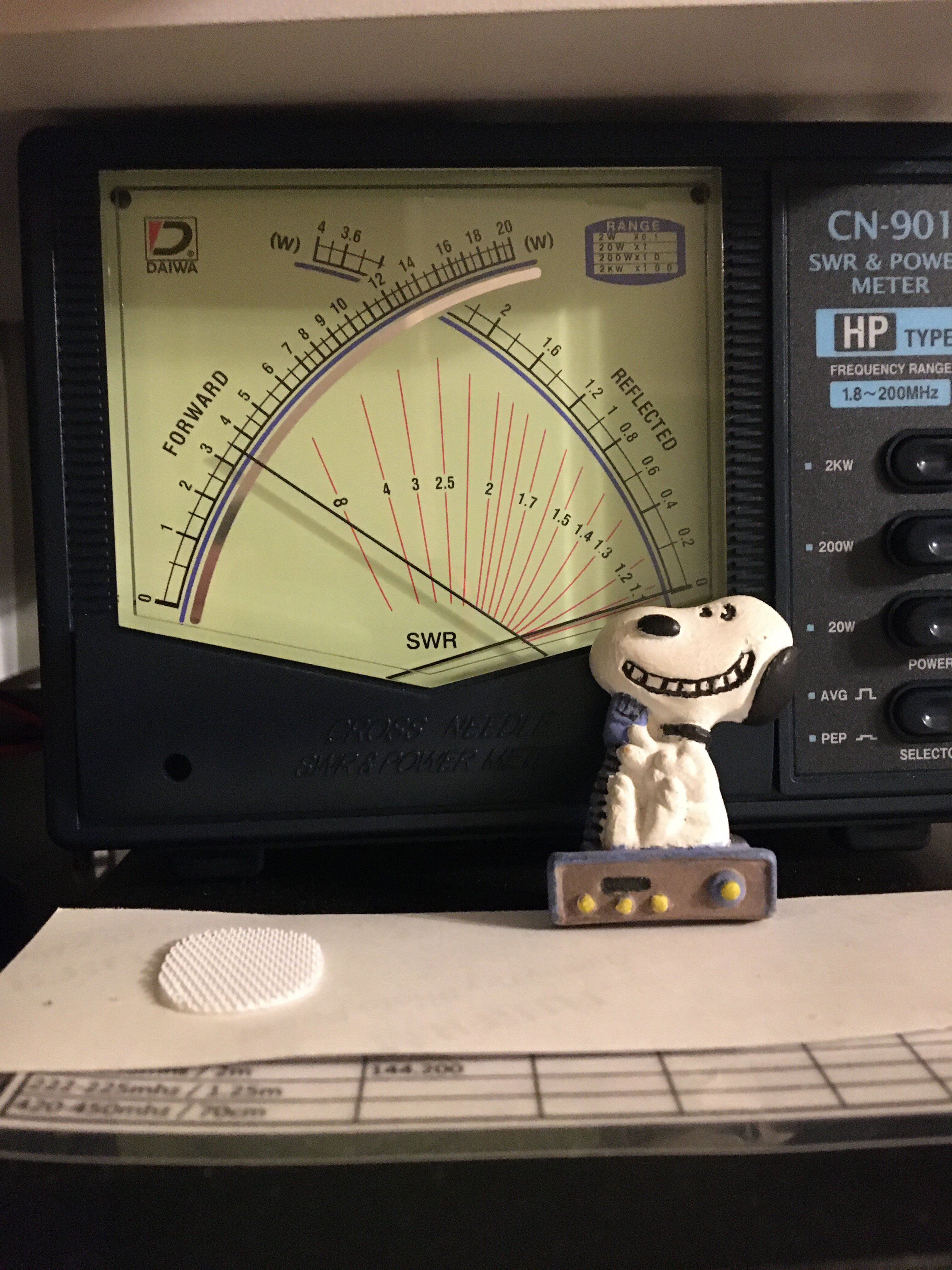

(n)Ok. Here's the radio AM DK on lowest setting. Like 2w. Swings to like 14w pep.

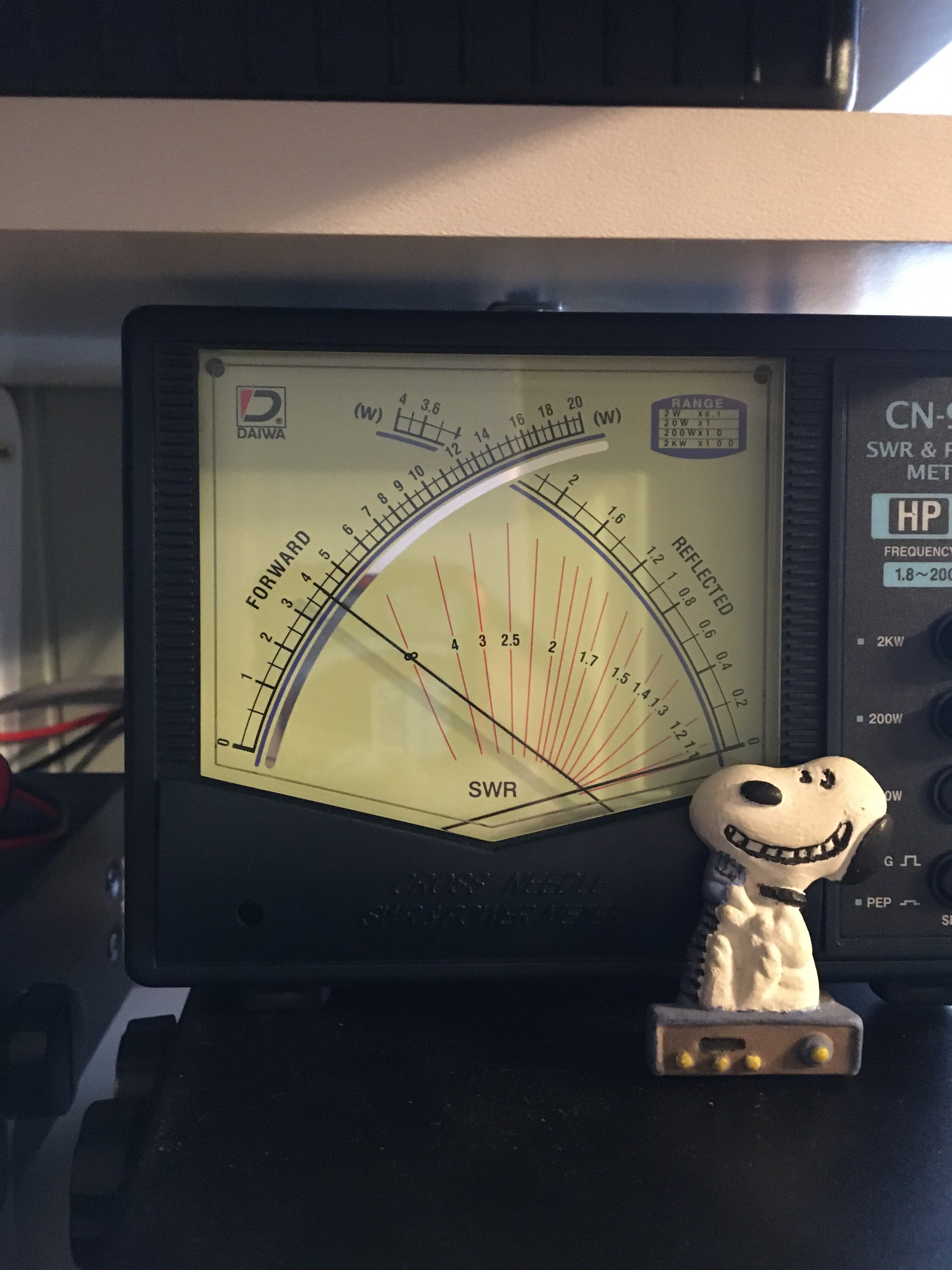

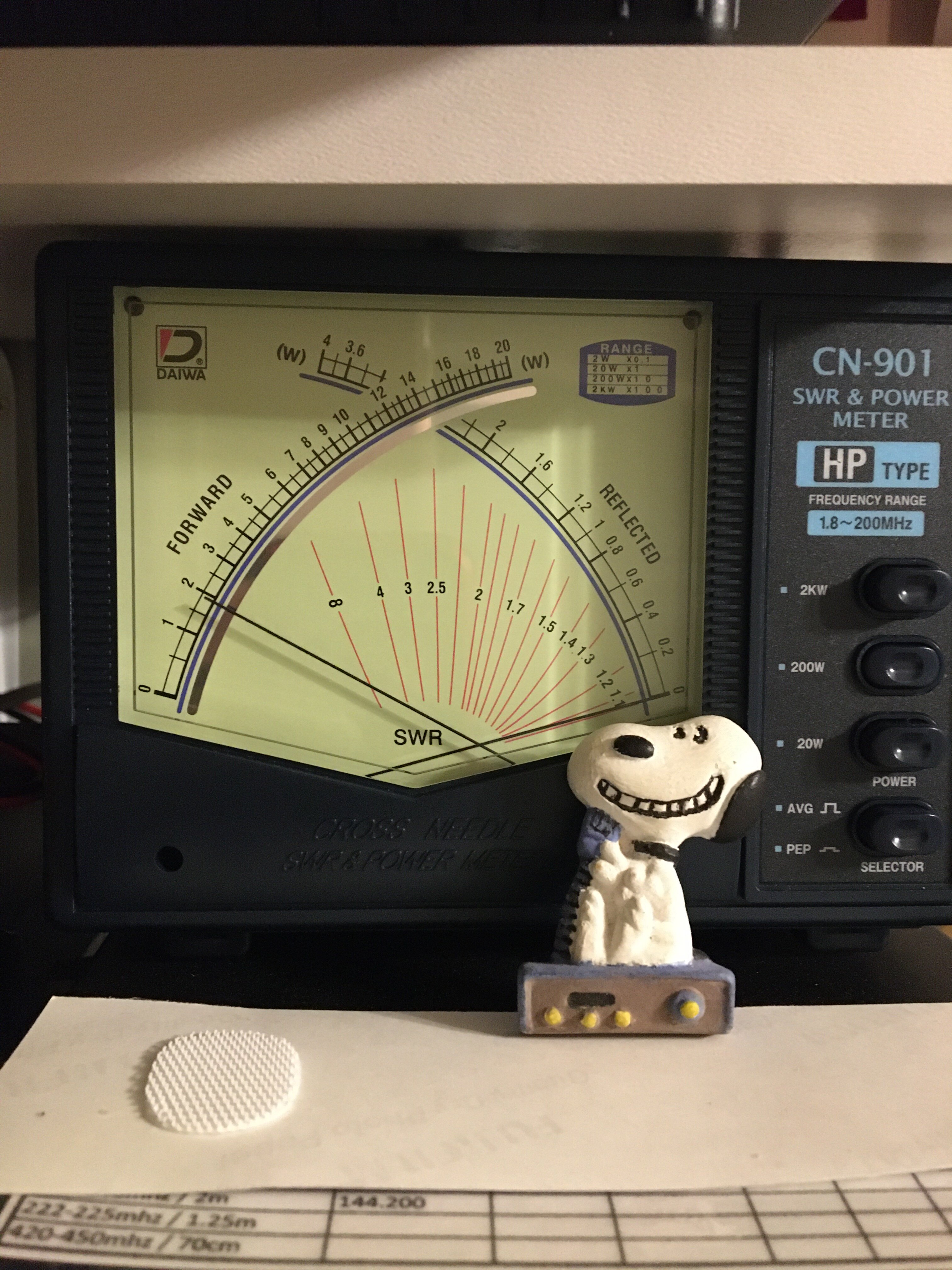

Amp on DK (like 260-270w). Swings to like 450-500 pep.
Reading online about some competition HD amps can take upto 200w pep (which is this ones spec). Some actually due start with a high DK and go up from that. Supposed to be 10w dk max from radio or 200w dk from the amp. So that's my concern as I'm over that by like 60-70w. (n)

Adjust your dead key on radio so you get 100w dead out of amp... 260-270 is to high and try and keep 4:1 ratio
the lowest the AT 6666 will go is the 2w as shown. (was turned down inside when I had it setup for me). Just can't figure out why I'm hitting such a high DK with amp on and only 2w dk. Even my old 4 pill Palomar I just sold didn't get that crazy high of a dk. Hence me scratching my head.

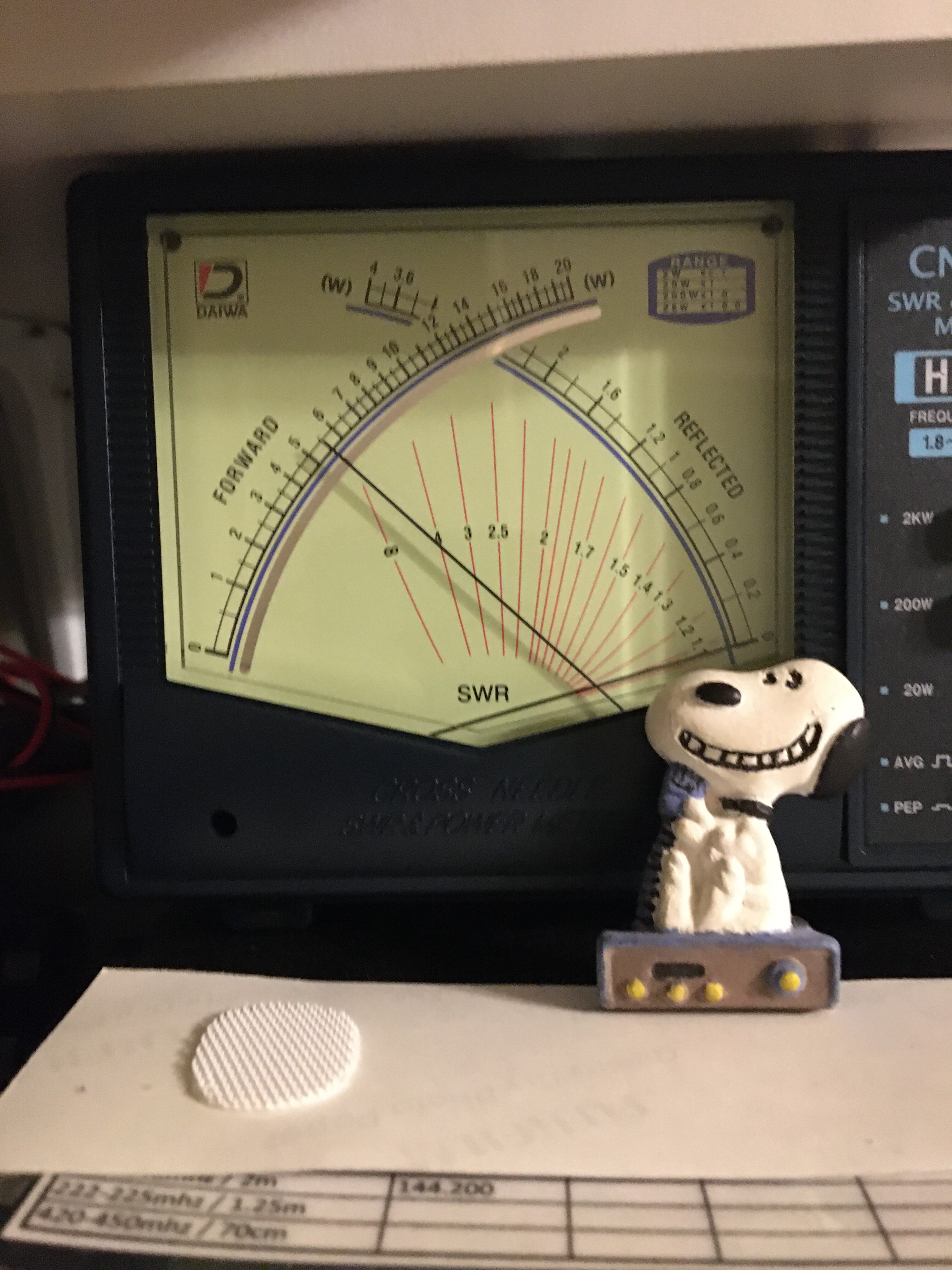

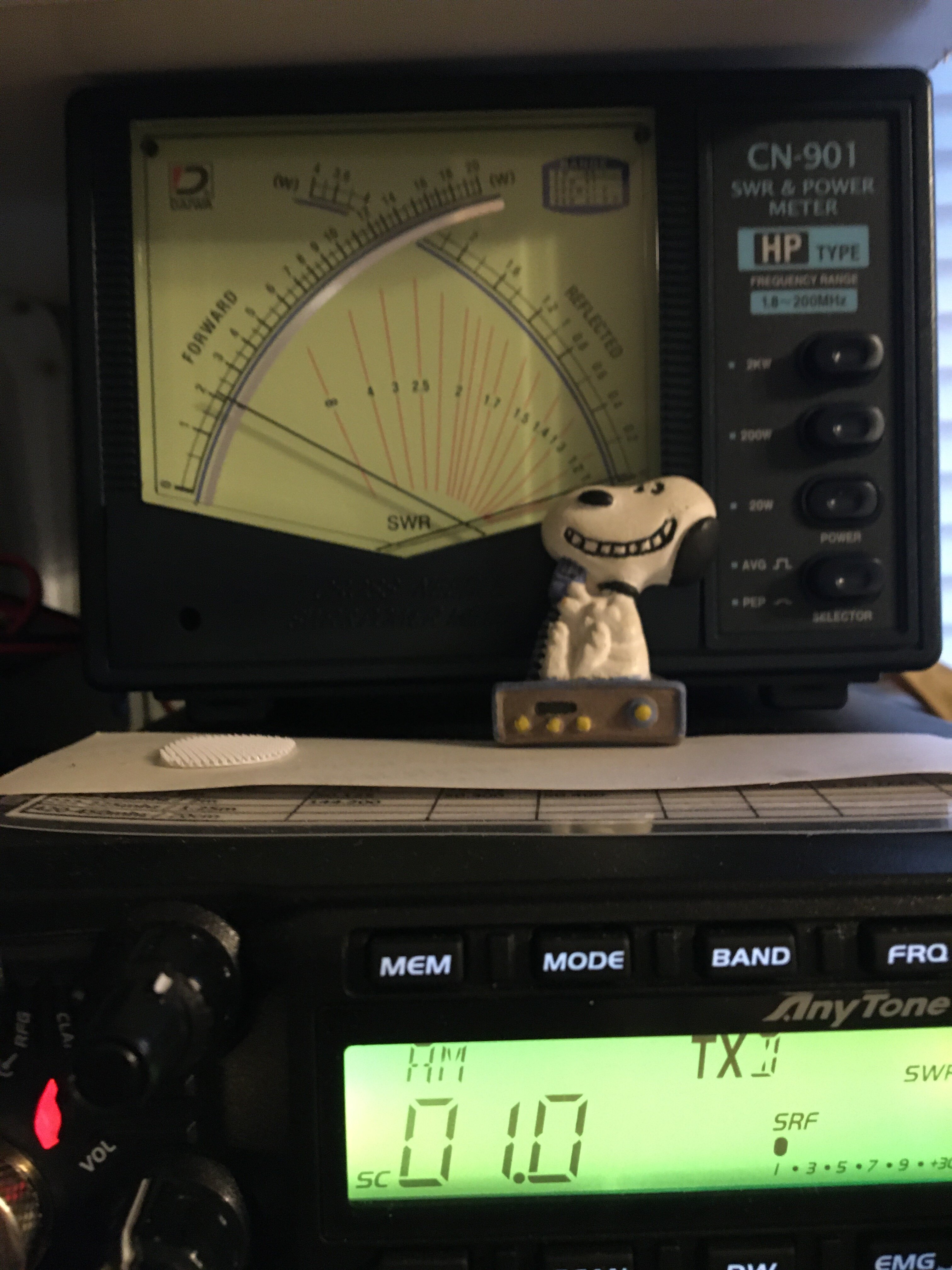

Ok. Here is my Ranger 296 numbers. 3/4-1w dk on AM swings to 5 1/2 pep.

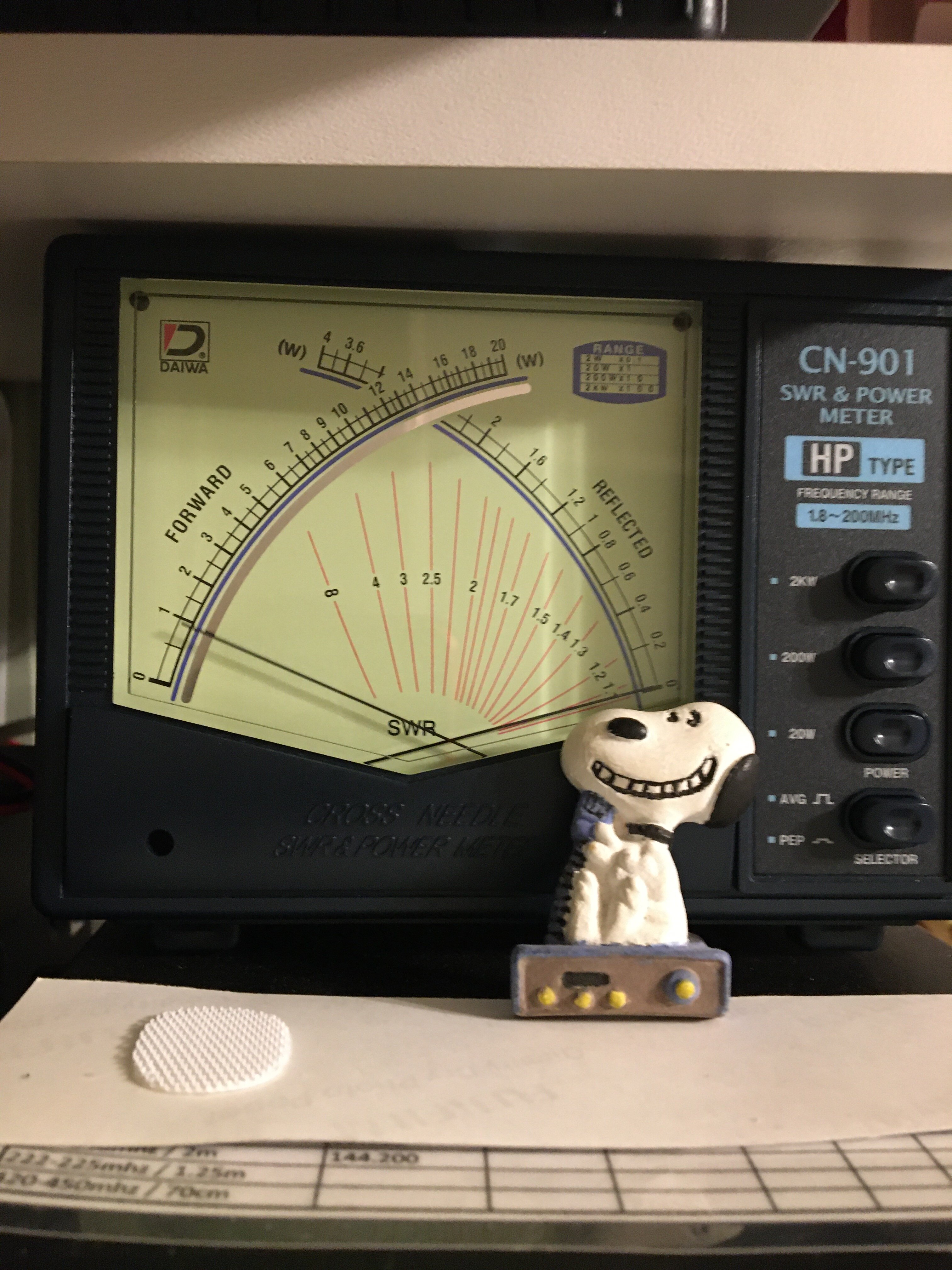

Gets a very tiny 20w dk with AMP on (meter on 200w) and swings to 350w (peak hold is on for this shot) (meter on 2000w)
So at 5 1/2w I get 350w pep. Which kinda lines up with the 250 for 2w dk. (n):unsure:
I will probably try to adjust the AM low pot on the 6666 to knock it down abit. I don't see how 1w extra on dk can make a 10 fold increase on the Amp dk when on.

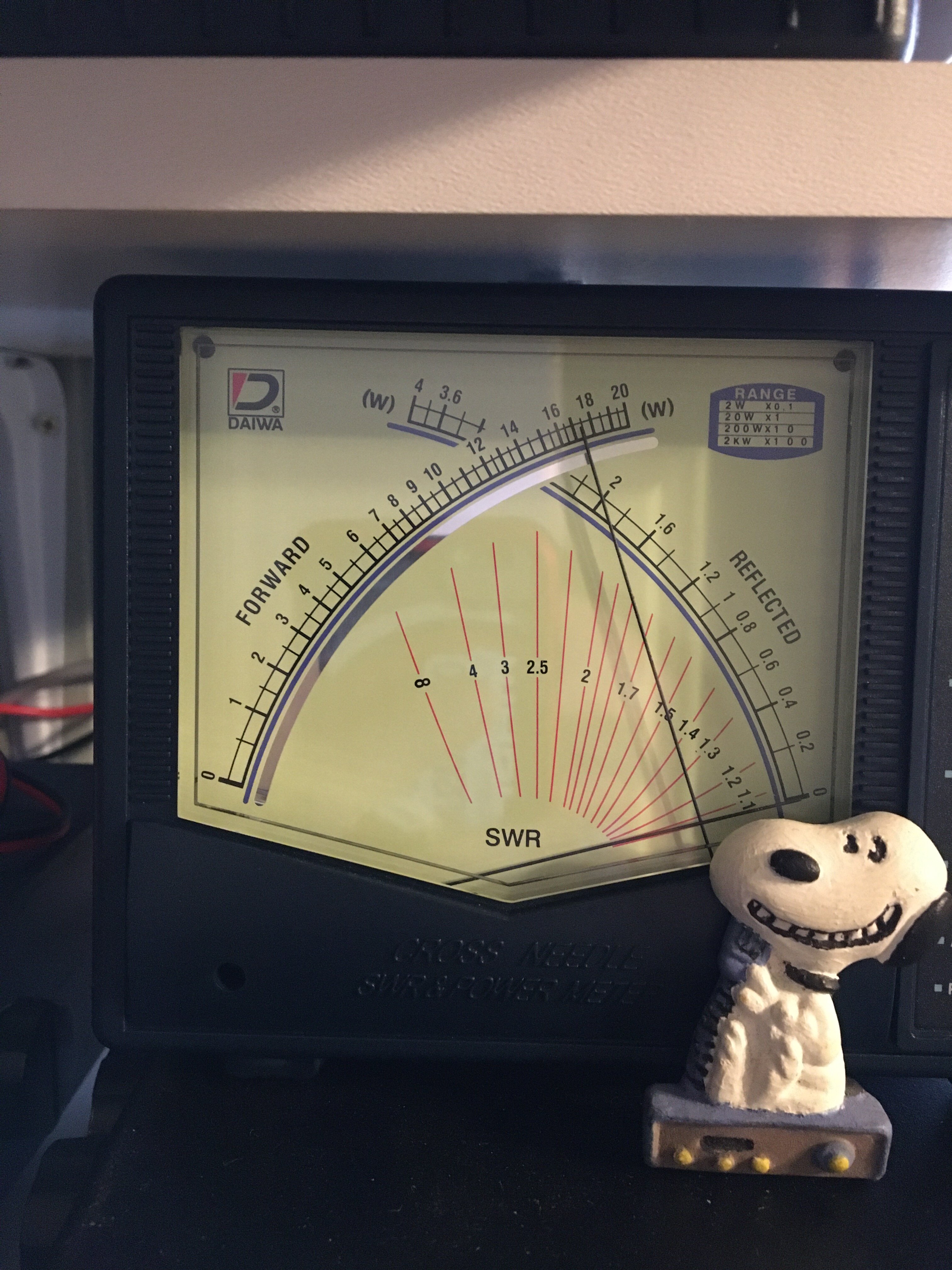

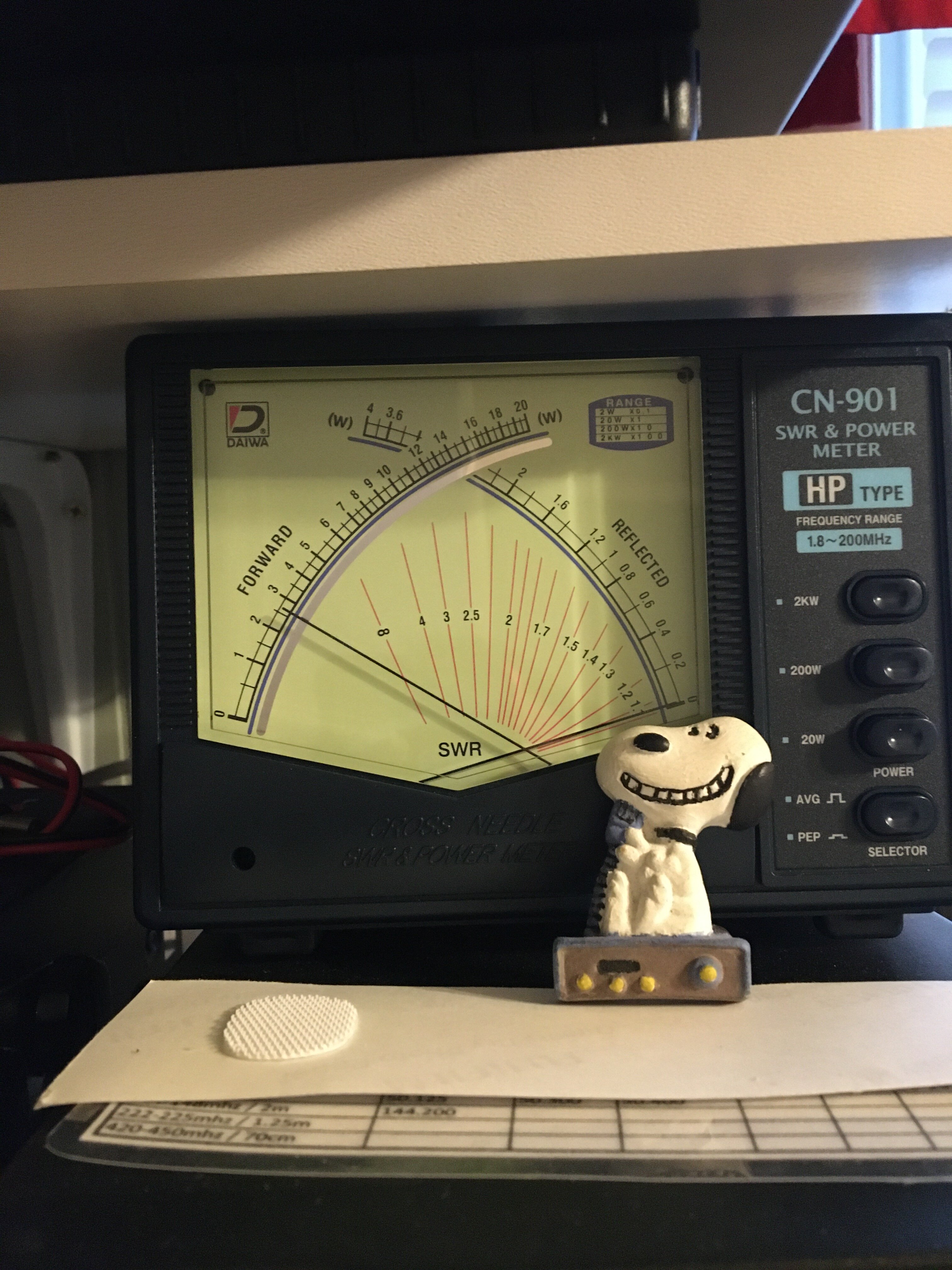

So I opened up the 6666. Lowered low power to like 3/4w. Lowered HI one also to like 15w. (Was at like 18w dk)
3/4 swung to like 4w with PEP hold on to get the pic.
on low 3/4w I get like 175 dk on amp which is under his 200w dk mark. Just still think something is up with the AM "tune" side of amp. Also noticed the radio (not the Daiwa) is saying better SWR with higher AM dk. 6w dk is getting me 1.9:1 and with the 3/4w and amp on I get like 3.3:1. I do notice when I modulate the SWR on the radio drops a couple points.
