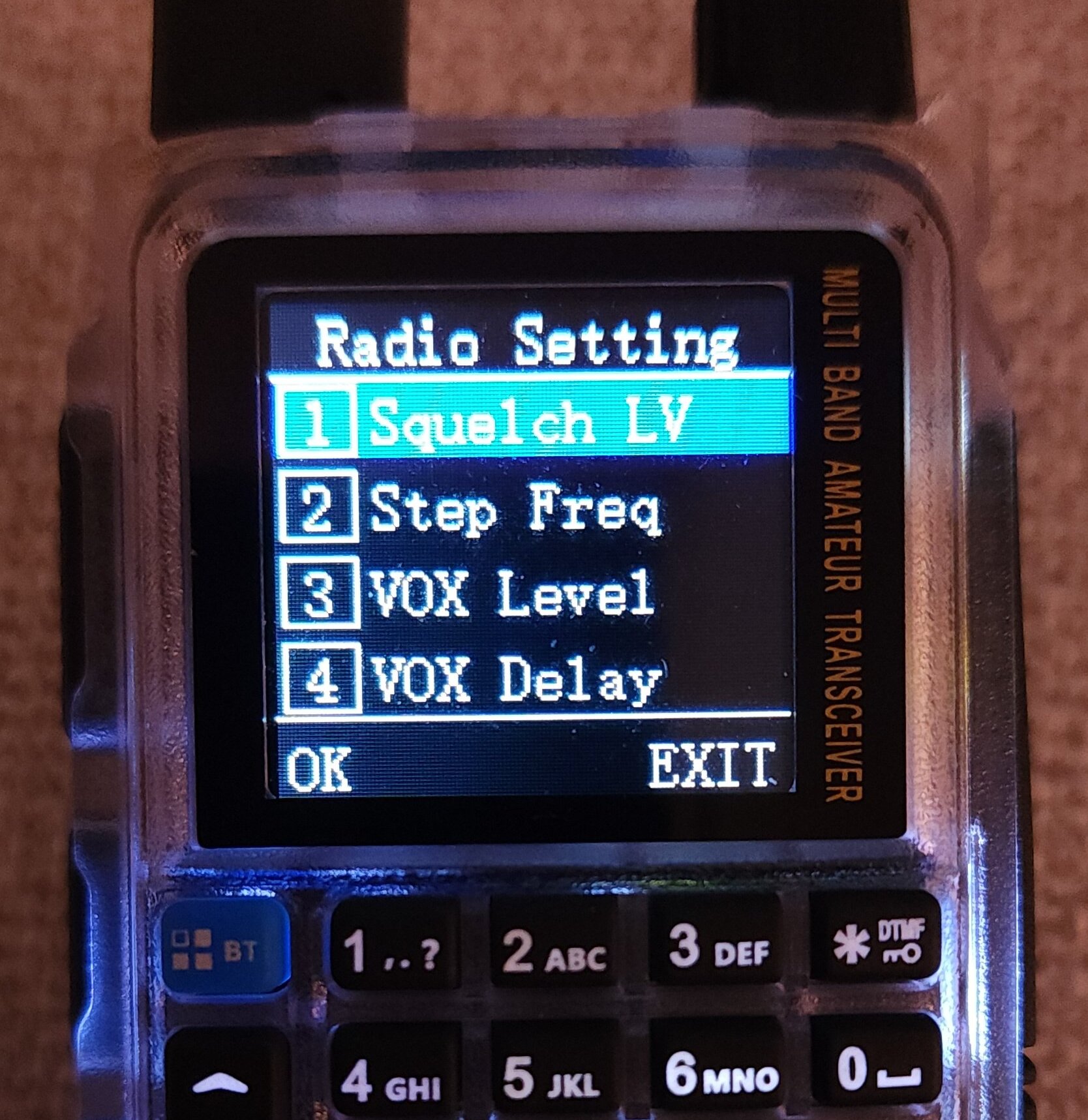

Radio Settings Menu:
full

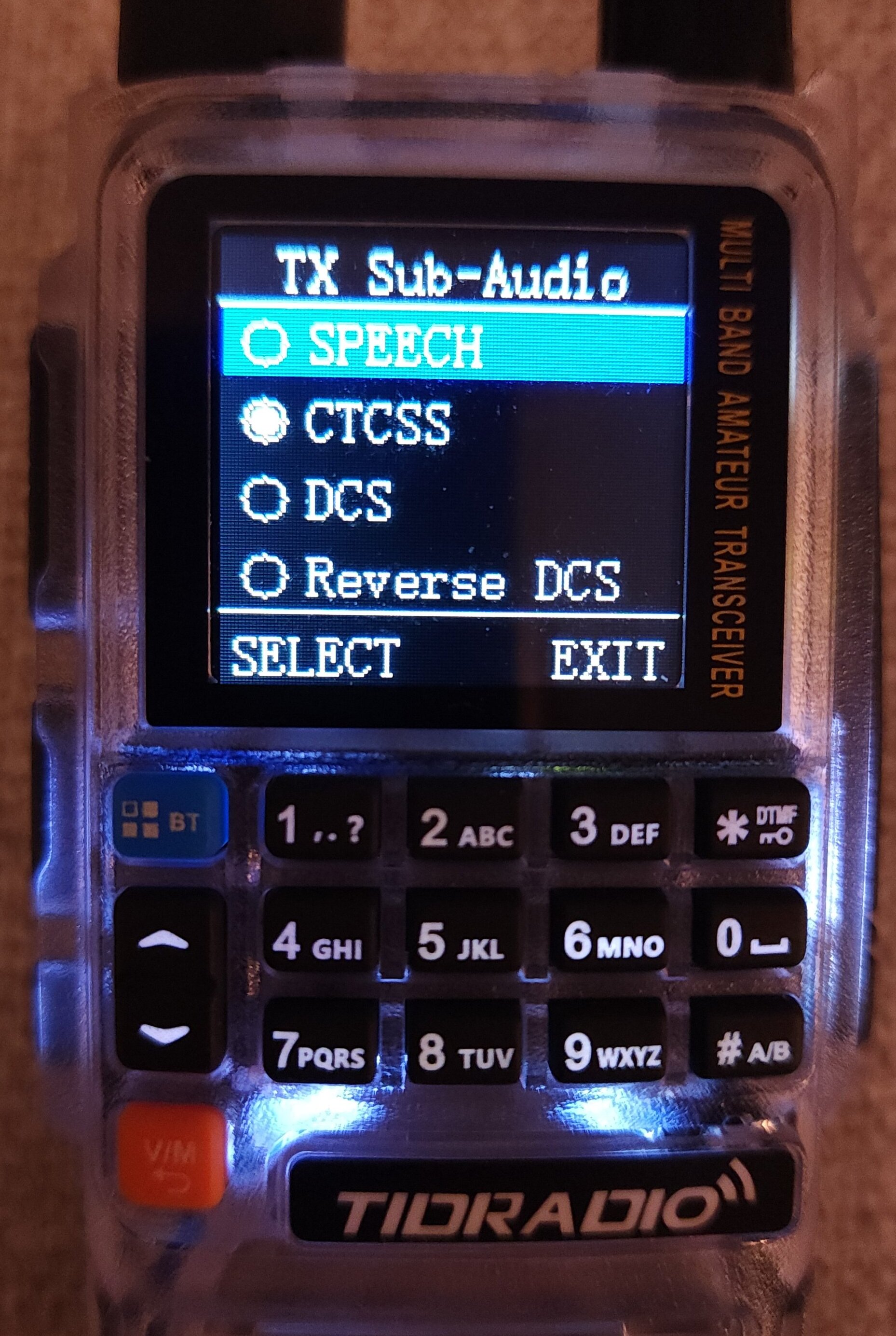

Back to the subject of how much effort has been put into make the menu system easy, here is an example of the revamped transmit sub-audio menu:
full

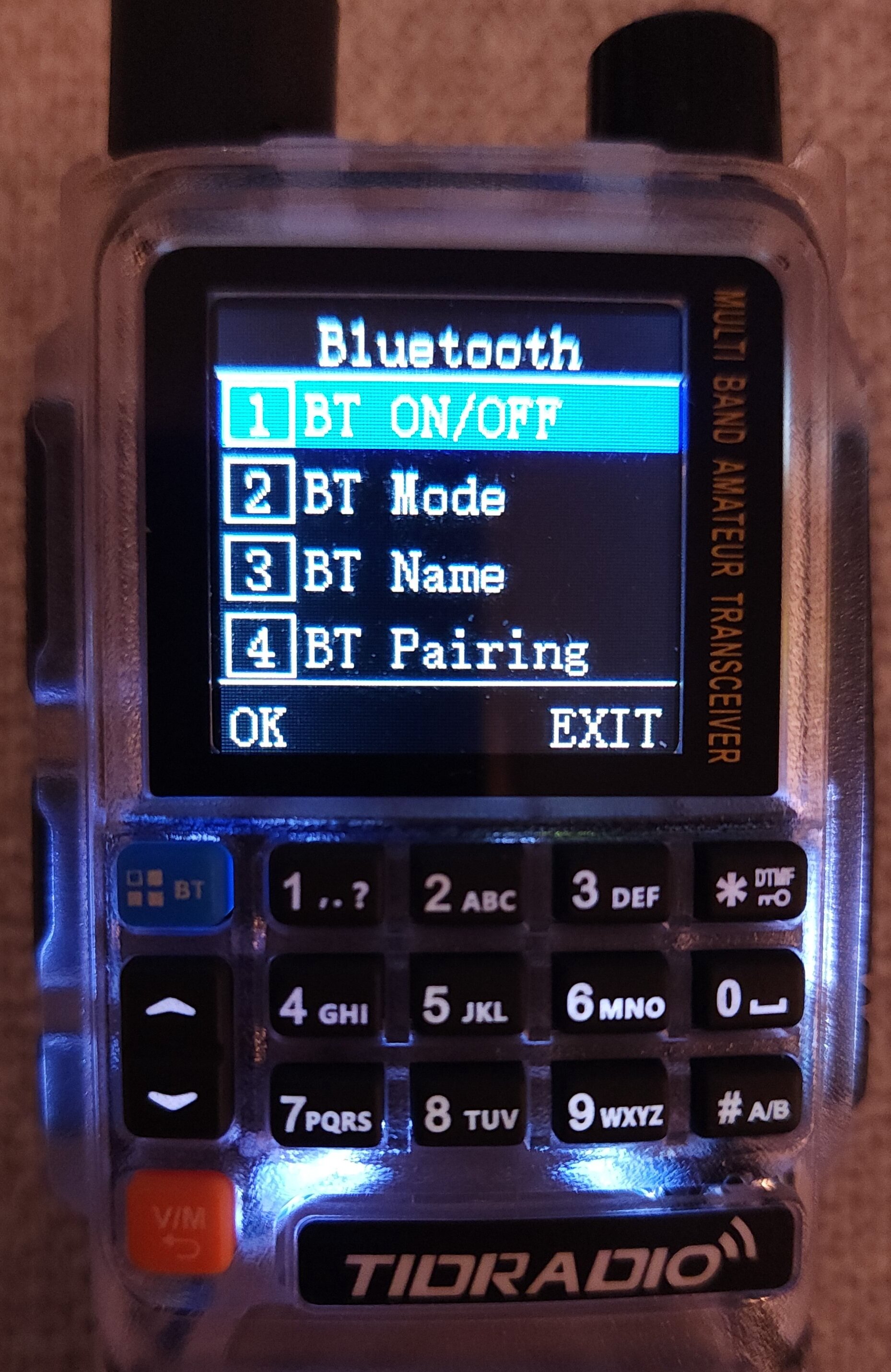

Bluetooth Features
Bluetooth in the TD-H3 is used in a variety of ways, including speaker/mic accessories. As of the time of this writing, only Tidradio bluetooth speaker/mics work, although there may be plans to expand the supported brands and types of devices as firmware is updated. Pairing and using the bluetooth for normal communications is easy enough, although there is a slight audio delay between the bluetooth device and the radio, which is perceptible if you turn the volume on the radio up at the same time the bluetooth device is active. This isn't a big deal for casual conversation between a couple of stations or on a directed net, but it is not very useable on an extremely busy, free-for-all repeater like we have here in Southern California. Tidradio has already released one firmware update that helped reduce the delay, but I'm not sure how much else it can be improved.
