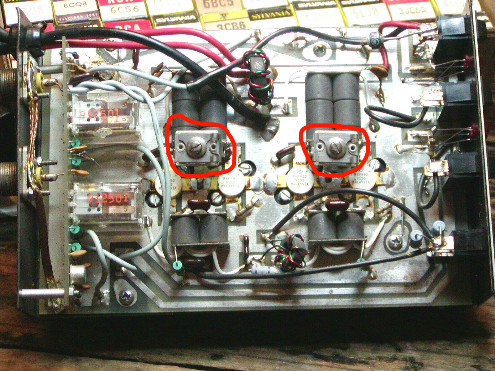

Hi, what's the exact function of this caps?
This thing have swr issues at low power levels, but when I increase the drive from the radio and power start to rise, the swr from amp to antenna starts to go down.
They are part of the output tuning. I'm not certified to give a better explanation.
IMO each 2 pill section should be tuned independently before they are combined and a fixed value capacitor installed. That way everything is balanced. That may have been done at one time but as soon as someone gets happy with the screwdriver all bets are off. The trimmer caps are ok but people can't leave them alone.
Your swr issue sounds like oscillation and could be because the amp isn't tuned properly.
