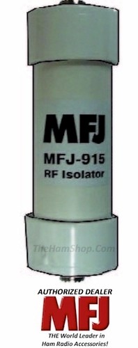

I use one of these. It is an isolator
https://www.ebay.com/itm/MFJ-915-1-...WrAjw:sc:USPSFirstClass!40219!US!-1:rk:6:pf:0
