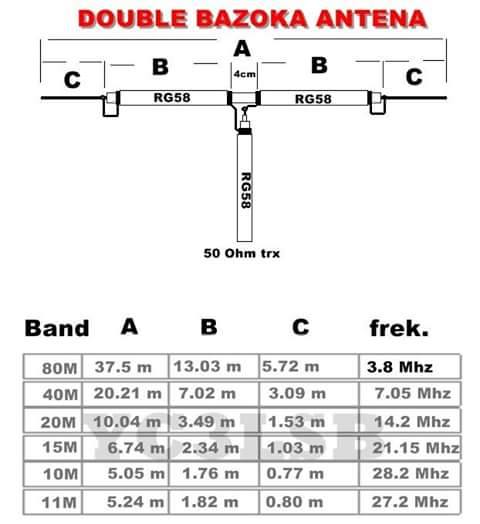

Riverman71: If your looking to run Horz antenna in attic. You might try a Double Bazooka antenna.
They can be less affected by metal and junk in close proximity to elements than others...they are normally broad-banded also and easy to tune once you get them in place. However do not try to tune them in a different location and then change mounting,
They work the best when tuned where final location is set,
Just a thought...They work as an Inverted V or "L" or Inverted "L" set-up also...so pick the best spot away from most "Junk" and give it a go.
All the Best
Gary
http://1.bp.blogspot.com/-eoi-ayMP4As/VdSt5ggX9HI/AAAAAAAADiM/lTP5NPXS_ng/s1600/001-antena.jpg
