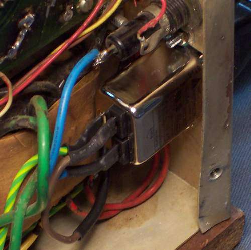

I have developed a fondness for the IEC power socket.
Especially the ones with a noise filter attached.
The ones rated for only 3 Amps are not expensive if you shop around. Upside is that if the customer loses his power cord, a new one is as close as the nearest Office Despot store.
Just got in the habit of upgrading the 2-prong cord. The later 3-pin socket is a problem, nobody sells the cord to fit it. More than once we'll see something like this. A new socket is the only safe solution.
This can be a bit laborious, cutting the hole. I cheated and bought a Greenlee punch back when they were under 300 bucks. It's still paying for itself.

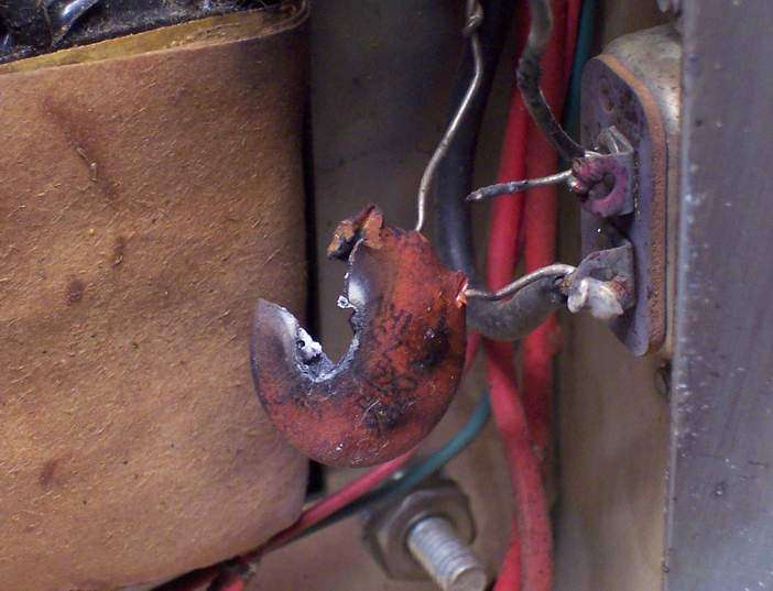

I need some good pics of the concrete resistors. Mine has them a little screwy with 2 twisted together going straight up. Any help would be very nice. That mess and just a few resistors is all that has been done to mine. Valves of course. Thank you.
concrete resistors.
They are wirewound types. The body is ceramic, not concrete. Not that it's a big deal.

13561 1st version with vox. Point to point. The rat's nest. Thanks for the come back!
Using a ceramic disc cap for C700 creates the risk of discovering a "microphonic" capacitor. Not in the sense of picking up noise, but emitting a 'buzz' in step with your voice level heard inside the radio. Tram used the plastic film cap because it won't make any noise. The ceramic dielectric in most disc caps can become a tiny piezoelectric loudspeaker, vibrating with the amplitude of the RF passing through it, making noise from your voice audio.
Never did figure out how to predict which disc caps had this bad habit. Just learned to use a film cap like the factory did, but with a higher breakdown-voltage rating. They stay quiet.
