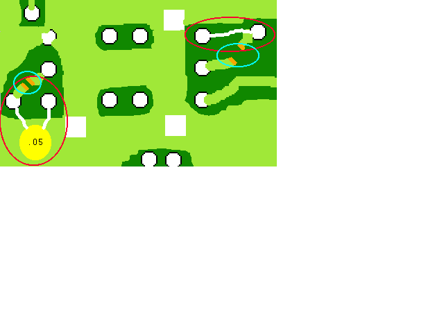

I suspect it too... I have found a few other version of the broad band L37 mod and they DO NOT include the .05uf cap
I seen the mod with the cap.
Anyone know why?
