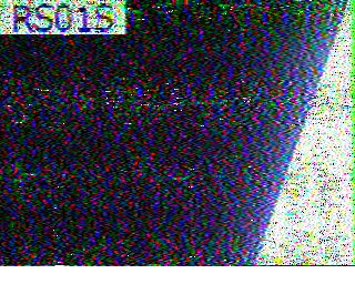

Yes I think I got my doppler file straightened out, I had a mess but I think after some testing I finally got it all where I need. ARRISAT has been a real pain trying to get a good SSTV picture, I just need a good high pass I guess.
