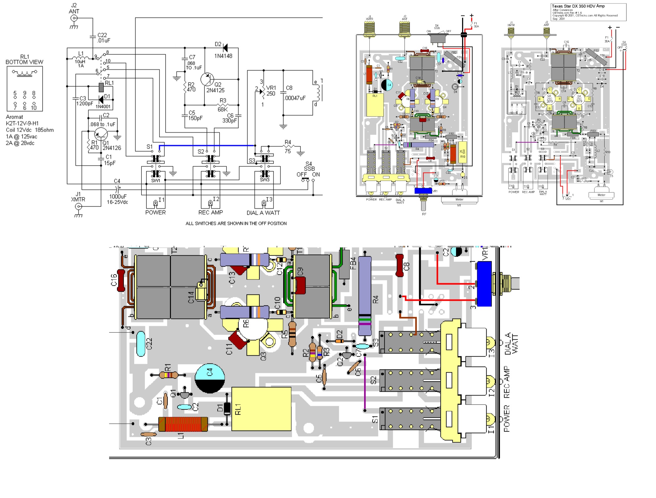

I have a 350HDV here that is clicking over to xmit (meter light turns on) as soon as the power switch is turned on. I replaced the keying transistor and the problem still persists, but if the keying transistor is removed, then it will not key itself up when the power switch is turned on. I was suspecting the relay, but it does click back and forth as soon as the power switch is cycled. Anyone ran into this before? Nothing seems to get hot at all like a short, but I am unsure as if yet. I was told it does make power out, just has no receive. No receive us of course due to the relay clicking over as soon as power is turned on.

Are you saying that when you push the power switch to ON, the relay "temporarily" keys up, lights the meter light, and then immediately unkeys and goes back into normal standby ???

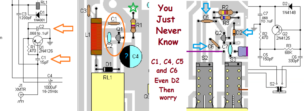

It's been my experience that Q1 and Q2 "circuits" need to be checked.
One can click the relay, but both need to be checked and the Diodes and the Caps connecting them to their "Sense" lines too.
The RF amp section - when spiked can short out and the relay clicks on because Q2 thinks Q1 is on and conducting - even though its' Receive - so even bias from the amps own "amp" can bleed back thru and turn on the relay because Q1 is thinking something is present on it's sense line...
Check and swap out C1 15pF to be sure...
Seen more than once a spike in the Amps relay - is enough to weld the plates of even the output caps together and act as a short...
This may be the condition - you've spiked a cap or blew a diode.

Ranch55, no, the amp clicks over when the power button is pushed and stays keyed up as long as power is applied to it.

Shorted Q1 is incredibly common. Didn't start seeing this failure until radios with RCI-style modulators became common around 30 years ago. When the audio is turned up, the negative modulation peaks become long pulses of "no carrier". This causes the keying transistor to spend too much time in between being fully turned on and fully turned off. When the tiny 2N2907 transistor is turned on by a steady carrier, it has a very low voltage drop across it and runs cool. But when it spends too much time 'in between' fully on and fully turned off, it acts like a resistor and gets hot. But only until it fails as a short and keys the relay as soon as power is applied thereafter.
We found that putting a small electrolytic capacitor in parallel with C2 when Q1 is replaced would stop this. A value between 4.7 and 22 uf does the job without making the relay take longer to unkey.
Got in the habit of putting a 10uf cap across C2 in every Texas Star we see, as a preventive measure even if the customer had no keying-circuit trouble. Much cheaper than the headache of a customer who has trouble down the line.
