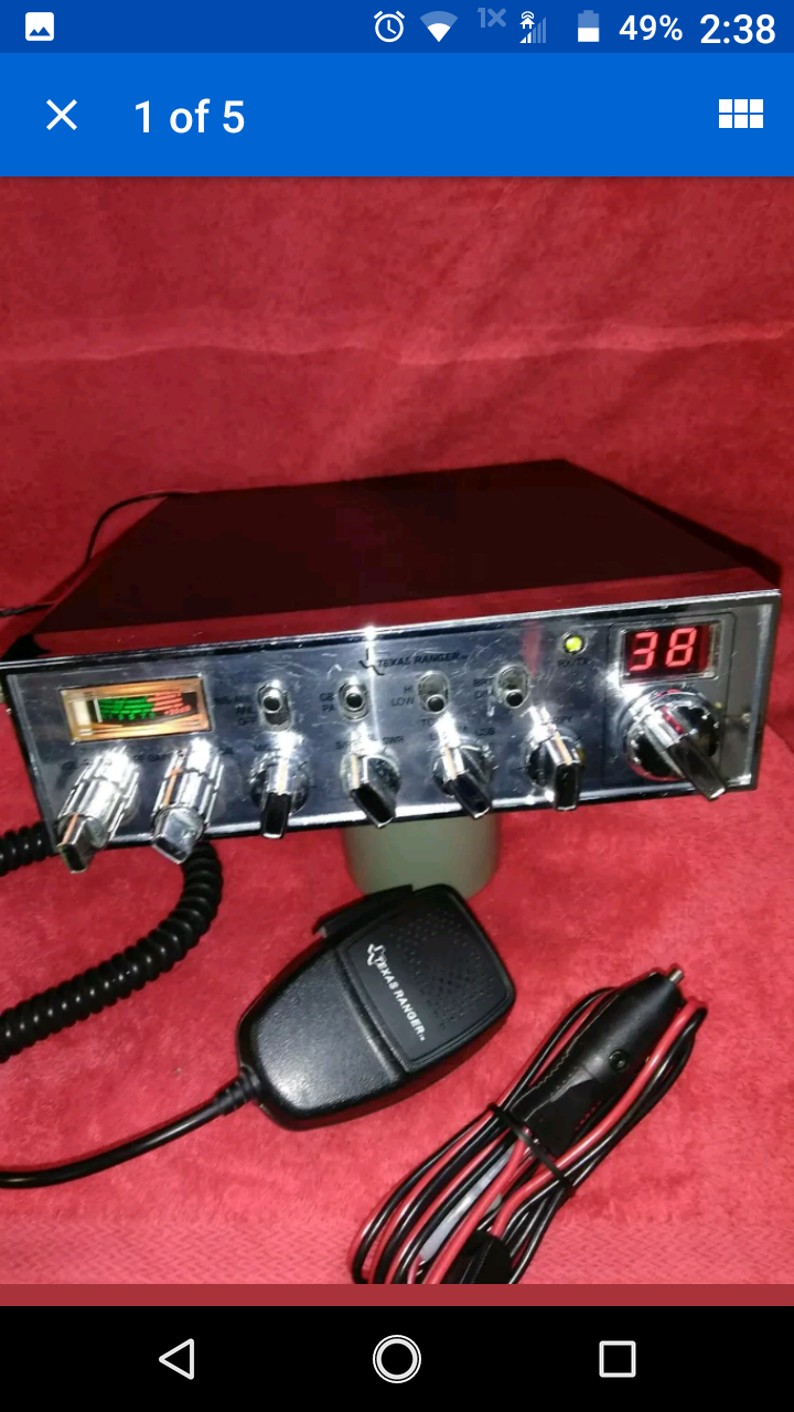

Well I broke down and ordered a Ranger TR-296 today. Seller has scope and such gear (ham) and setting my AM deadkey to 1.5w for me as well as reconfirming frequency stability. Only mod was clarifier opened and aligned for TX/RX..
Has a 2SC1969 final in it and nothing clipped. So swing should be normal.
He is also going to send me the PEP swing as well with the 1.5w dk in place..
