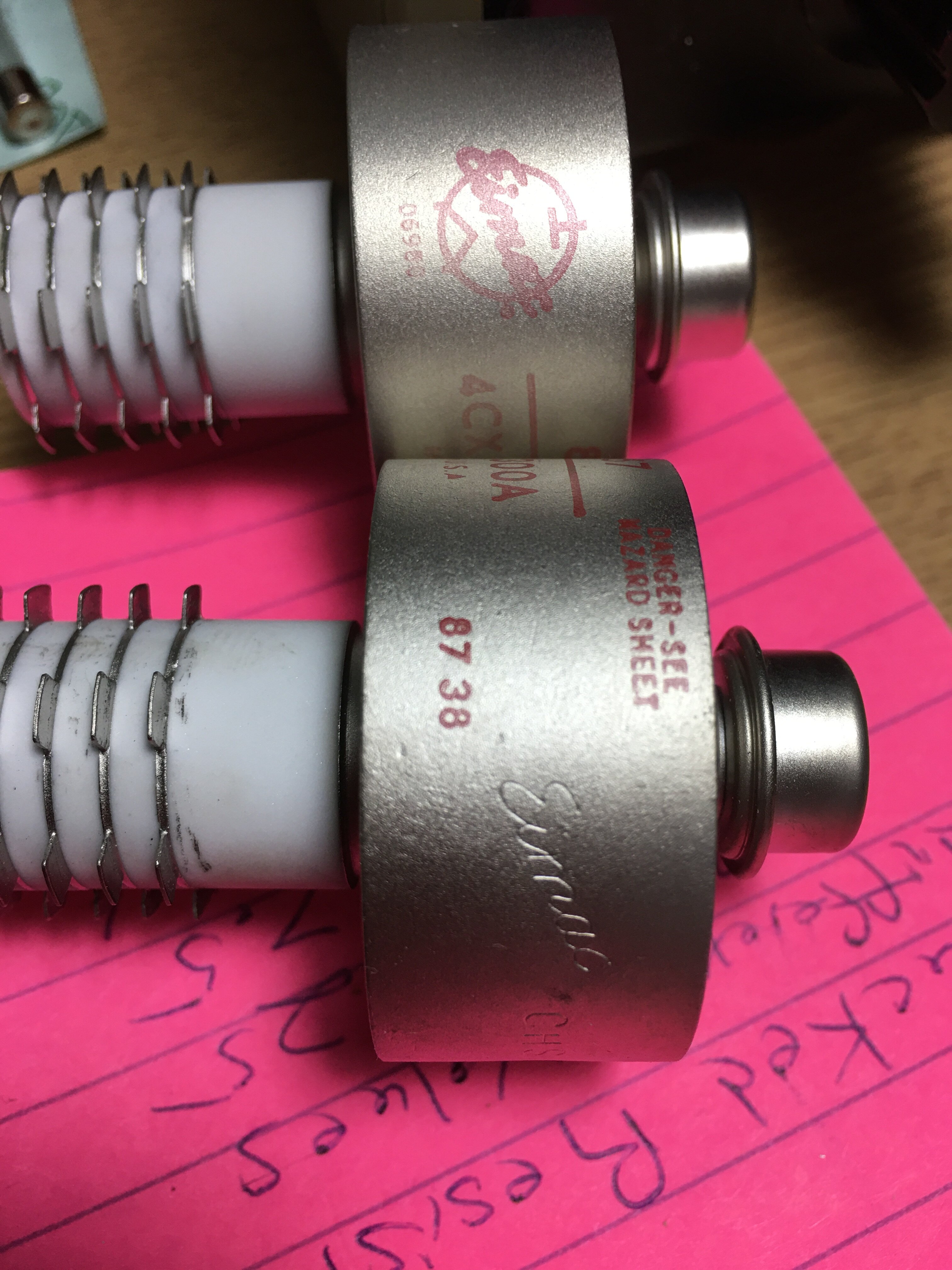

I got the volts & currents squared away. About to install two “new” 4cx300a I got from 2 different eBay Sellers. I used an old pair of 300y's to do rough tuning.

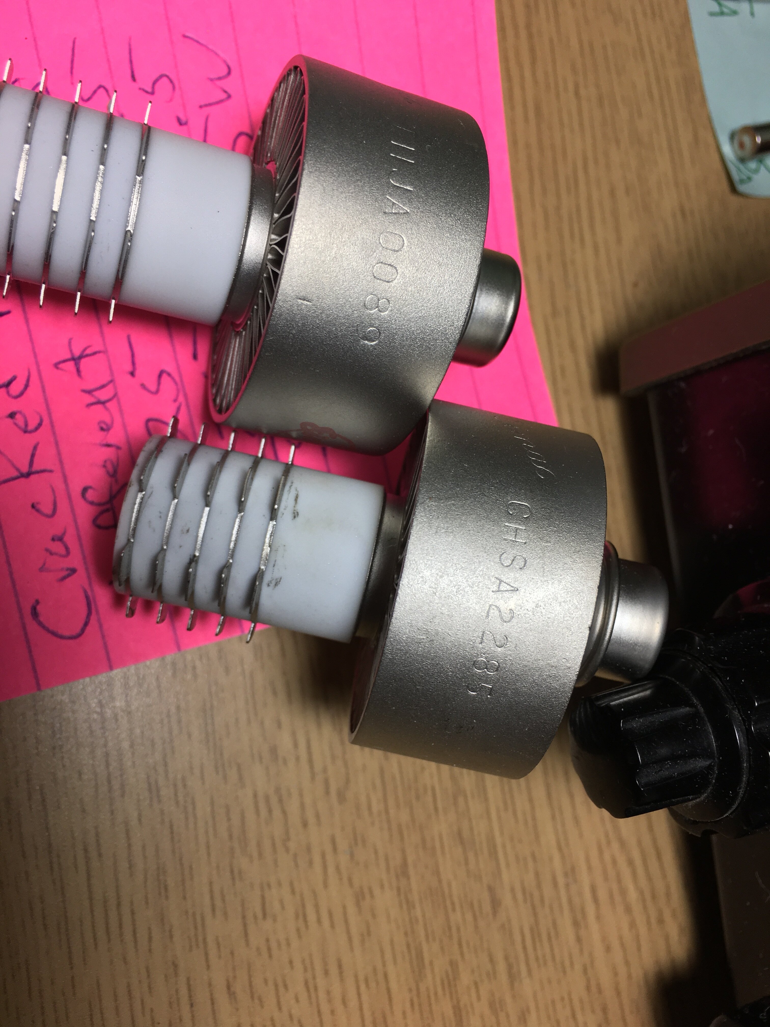

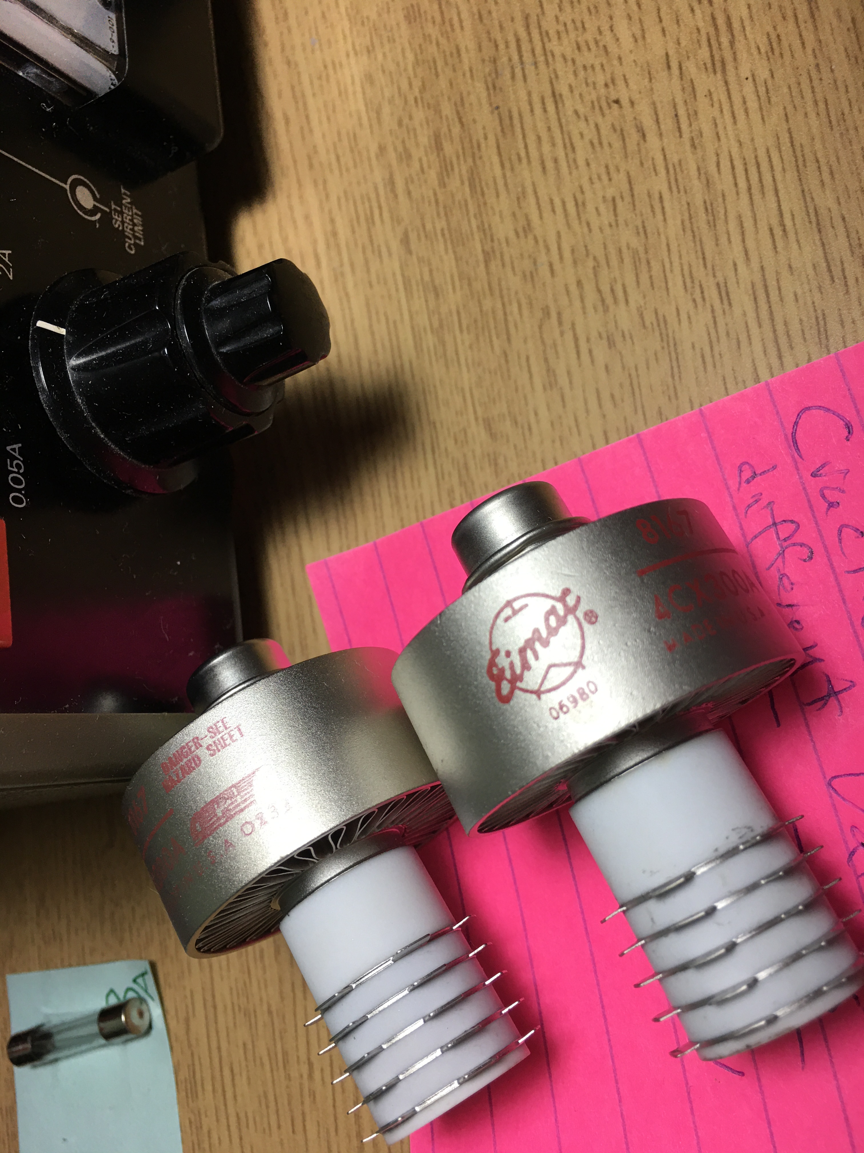

Filament V tweaking (6v) had me learn the Buck-Boost wiring of the AL-572 transformer, it provides more V options than I expected. Previously, I followed advice from someone already familiar (Thank you). I’m ready to install the “new” 300a’s paused to read the tube markings. One has no scratches and appears unused. The other tube shows light pin-tab marks as if it was once in a socket but otherwise appears new (no anode marks or no heat tarnish, etc). Pictures below.
Stamped in the metal: CHSA2285 and THJA0089. Printed in ink: “87 38" and “0234". Best guess is 1985 & 1989? There’s also a graphic printed on one tube that I don't recognize. I thought maybe "CPI" but CPI was not founded until 1995. IDK, relics perhaps. Anyway, my sockets are getting cold. Time to start the burn-in period.

Thank you,
I've been running the Fils for several hours. Had to rewire blower and chassis fans so I could adjust speed, noisy amp for sure. A few hours to go then I'm back to RF testing
Thank you,
