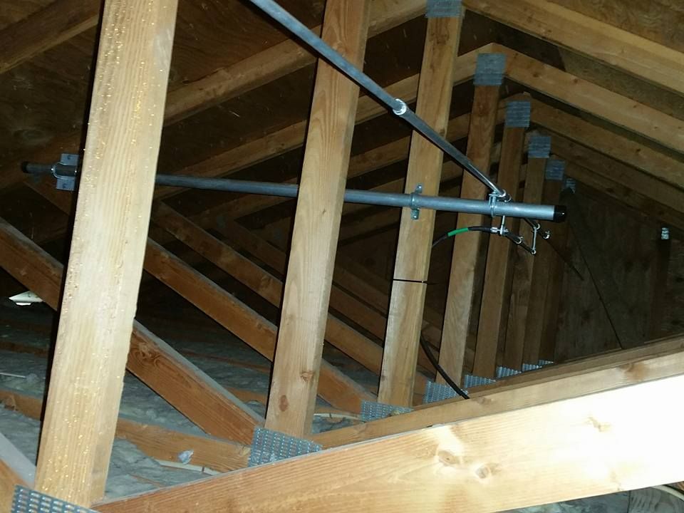

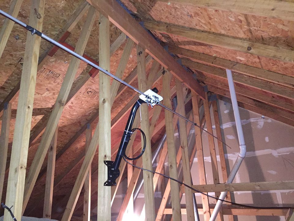

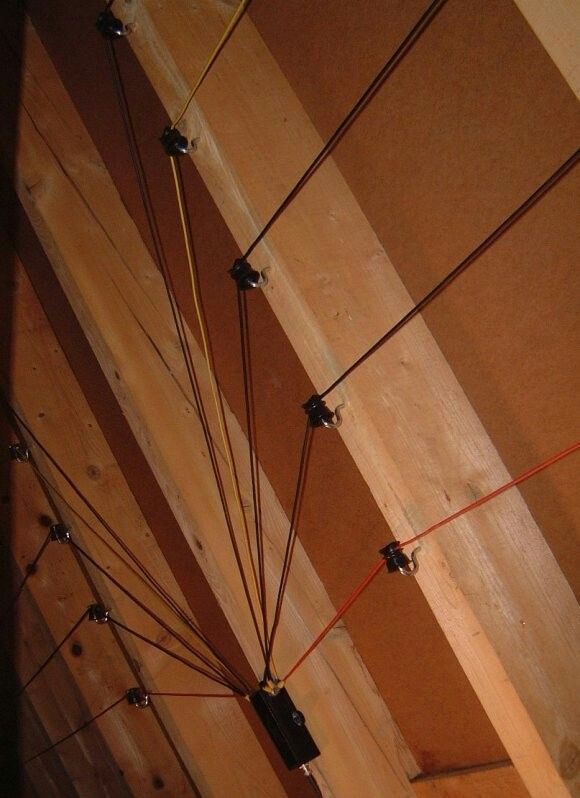

A few Nicely done Indoor antennas ....
WOW,, those are nicer attic installs than I did. I put my dipole in the attic with 1x1 wood poles (left over from last fence repairs) so that I can move the tips. Without any changes to the wire lengths SWR is way down 1.2 to 1.5 range. I guess getting the antenna away from wires and metal was a good thing.
