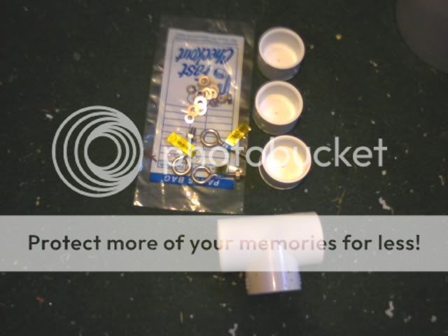

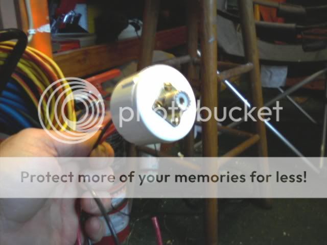

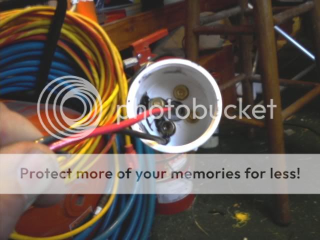

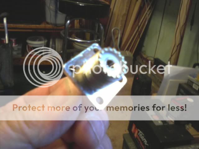

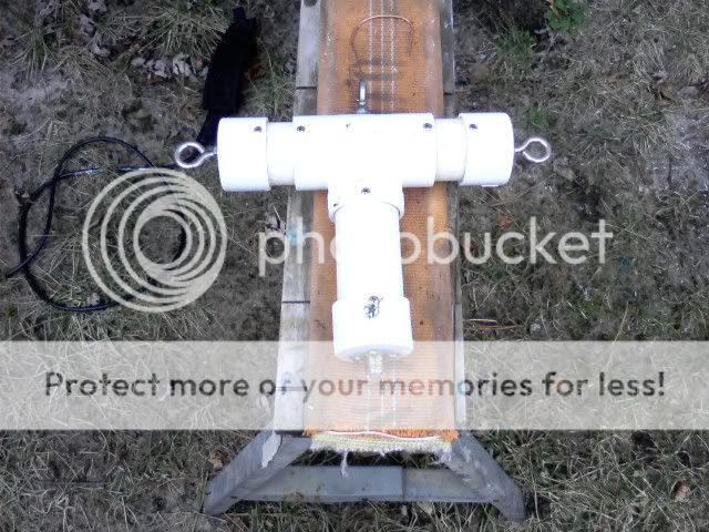

I got the hardware assembled today, and took some photo's of the project so far.The whole assembly was glued with PVC solvent cement, and reinforced with #8 X 5/8" stainless screws to keep it from pulling apart.
Once I get this jury rig up in the air, I'll take some photo's with the good camera and post them here, with a report on the antenna's performance....
