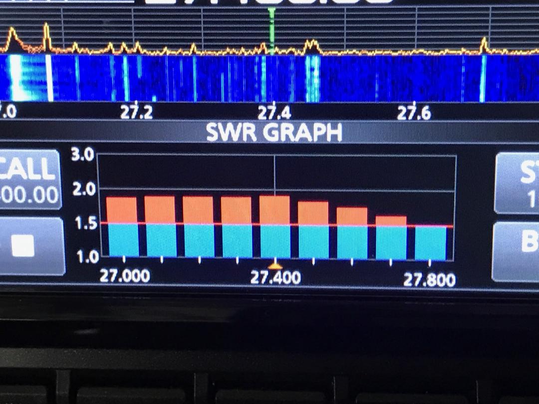

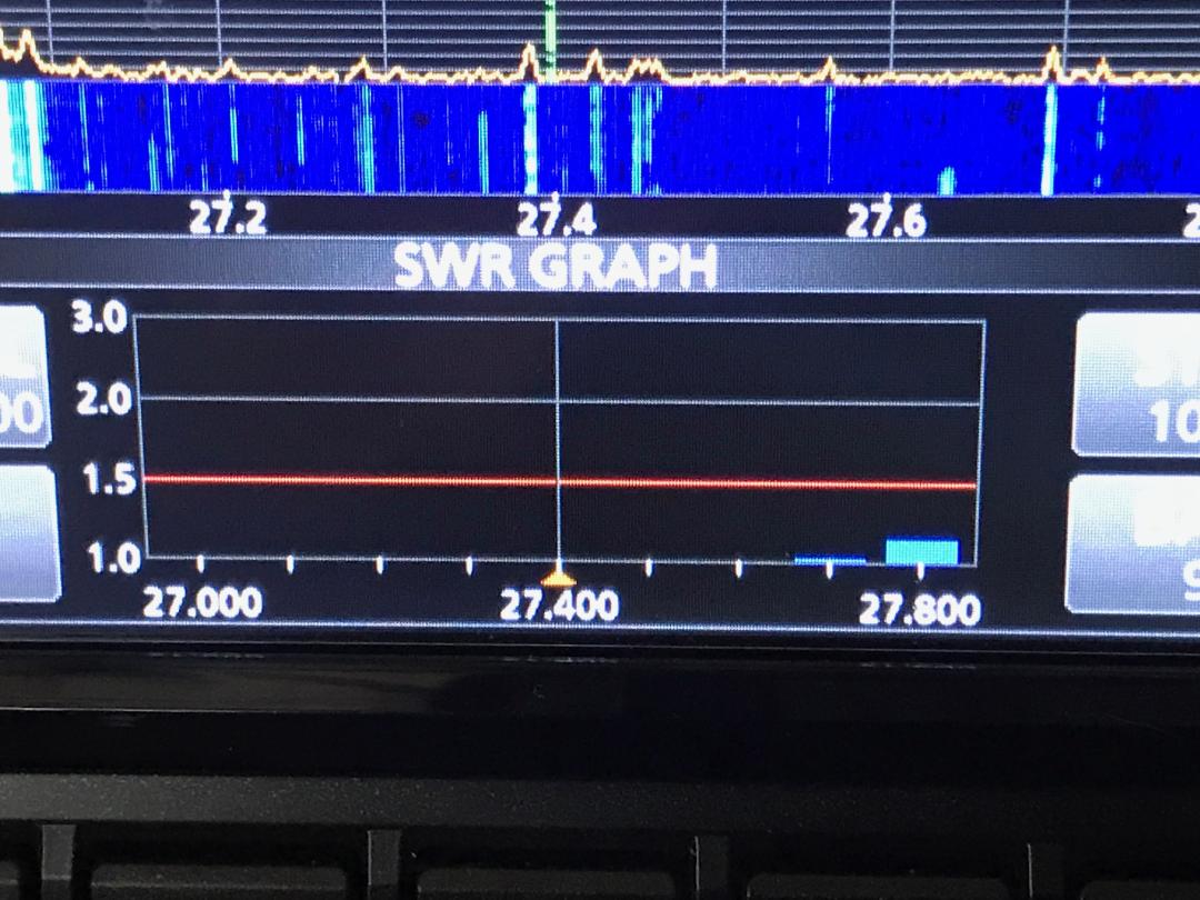

Was having no issues running the amp for 2yrs, this problem started this summer and this is the current fix i have for the problem. I have no choice but to tune with amp on. Hope this will answer these questions.
This pic is with amp inline and off, (radio tuned to run with amp on)
This pic is with the amp on
