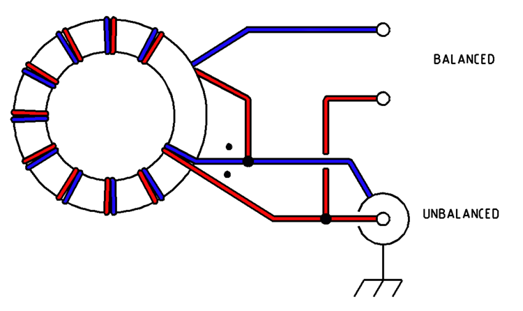

What is a short at DC isn't necessarily a short for AC/RF.
Here's an example of a 4:1 Balun. As you can see it appears as a dead short however that is only at DC.
Some radios you'll get a short from center pin to shield and you will on a lot of antennas with matching circuits and DC grounding circuits.

No I don't and I don't own a 980. I pulled the pic off of a website. There are others on this forum that could guide you through this. I was just curious as to what was going. I'm still learning about radios myself.
