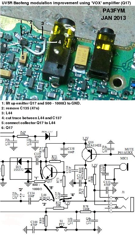

I always found the UV-5R's modulation very low. There is a mod to increase that and make it so one doesn't have to yell into the radio.
Baofeng UV-5R Modulatino Mod
That's cool! If those radios were worth enough to justify it, I would offer that as a mail-in service. That's a 5 minute job. Maybe if someone had 10 of them that needed modding, might be worth the postage.

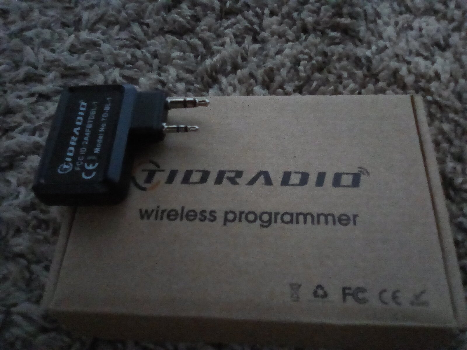

I did the steps to unlock GMRS radio on mine but haven't programed the channels in yet because I'm afraid of making a mistake and not knowing how to reverse it. I'll get there someday when I have time.
I have this Bluetooth programmer thing that I picked up that is good for these, download the free app on your phone and you can upload everything in one shot.
It was about $12
