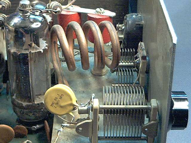

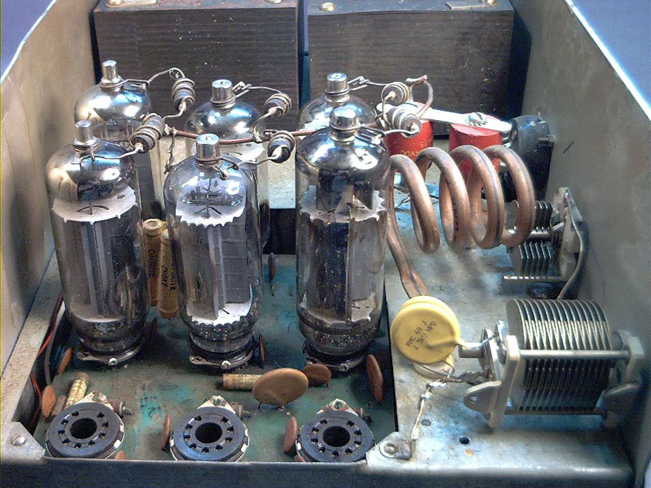

Found some pics. They're old enough to buy a drink. They're from a XL1000 we converted to high drive, removing the driver tubes.
The output coil is quarter-inch copper tubing. The Load control didn't have enough capacitance. There are two 68pf 2500-Volt disc caps in parallel with it. That brought the peak on that control nearer the center of the control's range.
That looks likely to last a minute with just 6 finals and no drivers.
Nice and simple.
Do you remember what the drive was on that set ?
