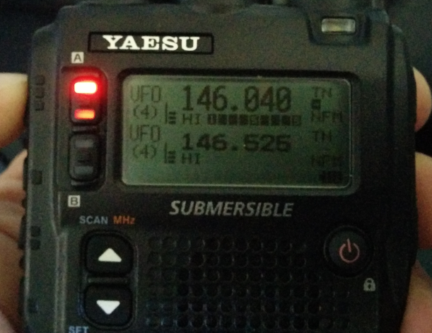

This is the picture I just took, shows the settings.

Congratulations on getting your ticket! It looks like everything is set right to me. You might not have a strong enough signal for anyone to hear you well enough to answer. Do you have a longer duckie, or a slim jim you could put on? Or drive closer to the repeater so you can see if you can hit the repeater better?
73,
Brett

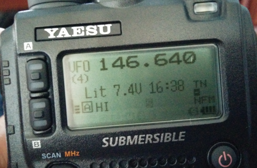

I haven't contacted anyone yet in the local club. Don't know how to, unless wait for monthly meeting. Here's my setting. Confirmed settings seems fine. Freq set to 162.2
