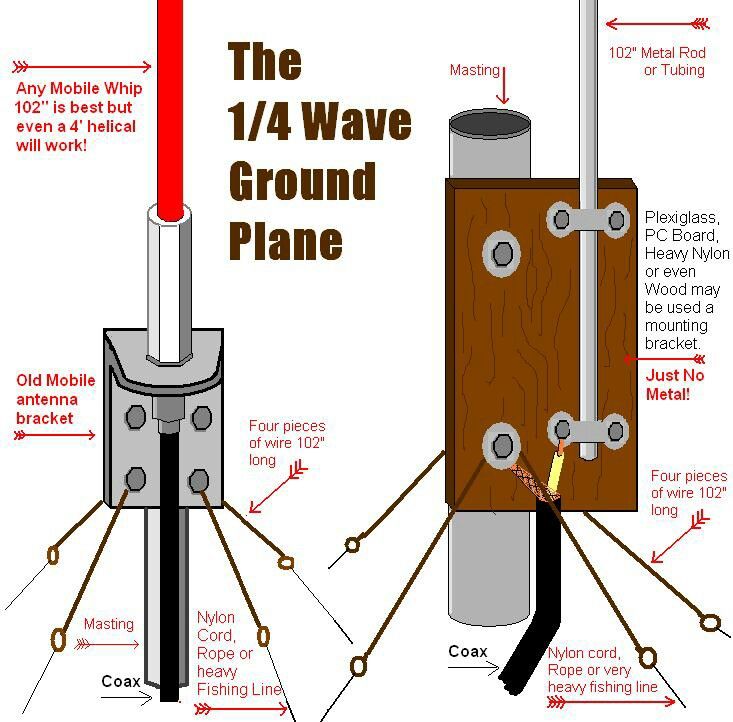

There are some YouTube videos that might get you started in the right direction or give you ideas on things to try, antenna building is pretty simple with wire or aluminum poles, the dimensions are critical and it gets more complicated with matching baluns, a good first antenna is a 1/4 wave ground plane
