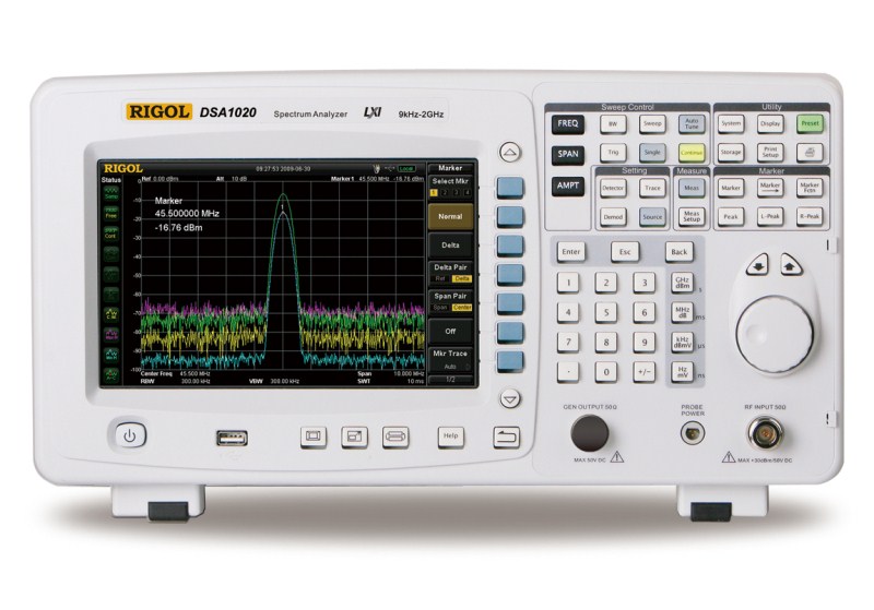

I wouldn't worry so much about an expensive watt meter. Yes it is a good required reference tool to help keep an eye on your AM carrier so you don't blow up your PA section or amp, but it only shows part of the story.
Now a spectrum analyzer is the Truth Sayer when it comes to see how much power you can put out AND keep your signal in a usable bandwidth on a specific frequency. The beauty is that you will start to literally see your signal bandwidth increase (widen) as you start to overdrive your system. That increased over driven bandwidth and related off frequency spurs robs you of power on the frequency you actually want to talk on. Plus the unwanted spurs ultimately tax your amp if you run one.
I understand most casual CB operators will probably not fork out the cash for a spectrum analyzer, but the prices have really, really dropped over the last few years so they are now within reach.
