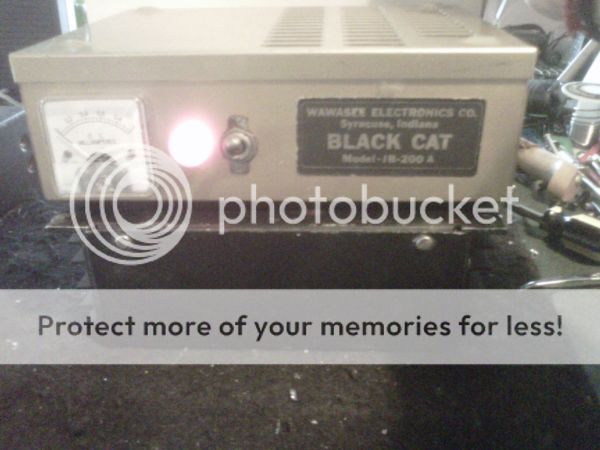

I have been looking for a Mobile Tube Amp for my 1970 restored pickup. I just found this amp just a 45 min drive from my house. The seller says it works great plus its in nice condition. Not knowing diddly bout tube amps...will I be please with this amp as far as performance? (again wanting to be period correct for my truck).
Thanks
That is a mobile amp. There book says its 6 meters takes up to 4 wats drive on am the current drain is 3 amps the two units weigh 6LB togrther. This info is from a Wawasee book.

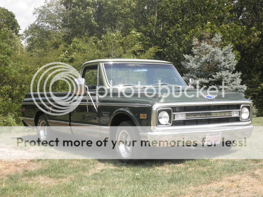

Ummm . . . Nice truck . . . But where is your 'period correct' 108 inch stainless steel whip?
Good Question. I have a NOS Antenna Mount (70's) for the truck. I was concerned the Wip my hit my truck. Not a god thing.;)

If I remember correctly, that amp uses either a single 8950 or maybe 2 8950 tubes. I have sen both. Not a lot of power. But a small compact amp for its time. Not a lot of watts either. Maybe a couple hundred. Been a few years since I have seen one in operation.

Hope your right Crusher (8950's)....but remembering those old "Black Cats" they also used the DREADED 8417's....
Even when the old shop was open (My Elmer and myself) in the mid/70's... We bought factory cases of 6JU6's & 6LQ6's but only purchased 8417's when someone paid upfront...they are not much different now price wise....
When you can find them....for a reasonable cost....
I do not even have "one" anymore....:thumbup1: Someone Really had to have it!!$$$...

The Black Cats of those type use the 8417 tubes. And yes, they are rare. However, you can swap in a 6550 tube and get similar performance for a fraction of what you can purchase an 8417 tube. Most large music stores and guitar shops will either have these tubes in stock, or be able to order one reasonable.
