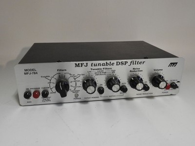

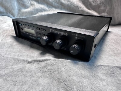

West Mountain Radio aka Clear Channel, Bhi, Scaf 1(technicaly not DSP), MFJ DSP, Realistic DSP(SSB and CW), Time Wave "chose best model for your use"!

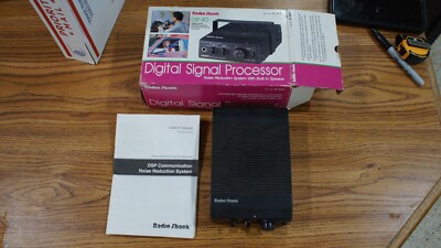

I researched the DSP units recommended by forum members, and was impressed. Hate to say this, but too overpriced ($300 -500 dollars) for me. Or, like the Timewave DSP, Radio Shack DSP40 or MFJ DSP, are no longer available new.
