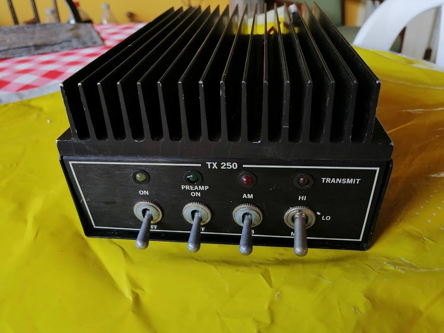

I recommend the TX 250 or Tx350. Built by Steve Canfield back in the 80s. Hard to find, and not cheap if you do find one. But great amps and bulletproof. First set of amps with the heat sink on top where it should have always been, they used 2879 and RF120 transistors (RF120s the best)
Man... That looks great! One could only hope to get one for a good deal. :) Thanks for chiming in.

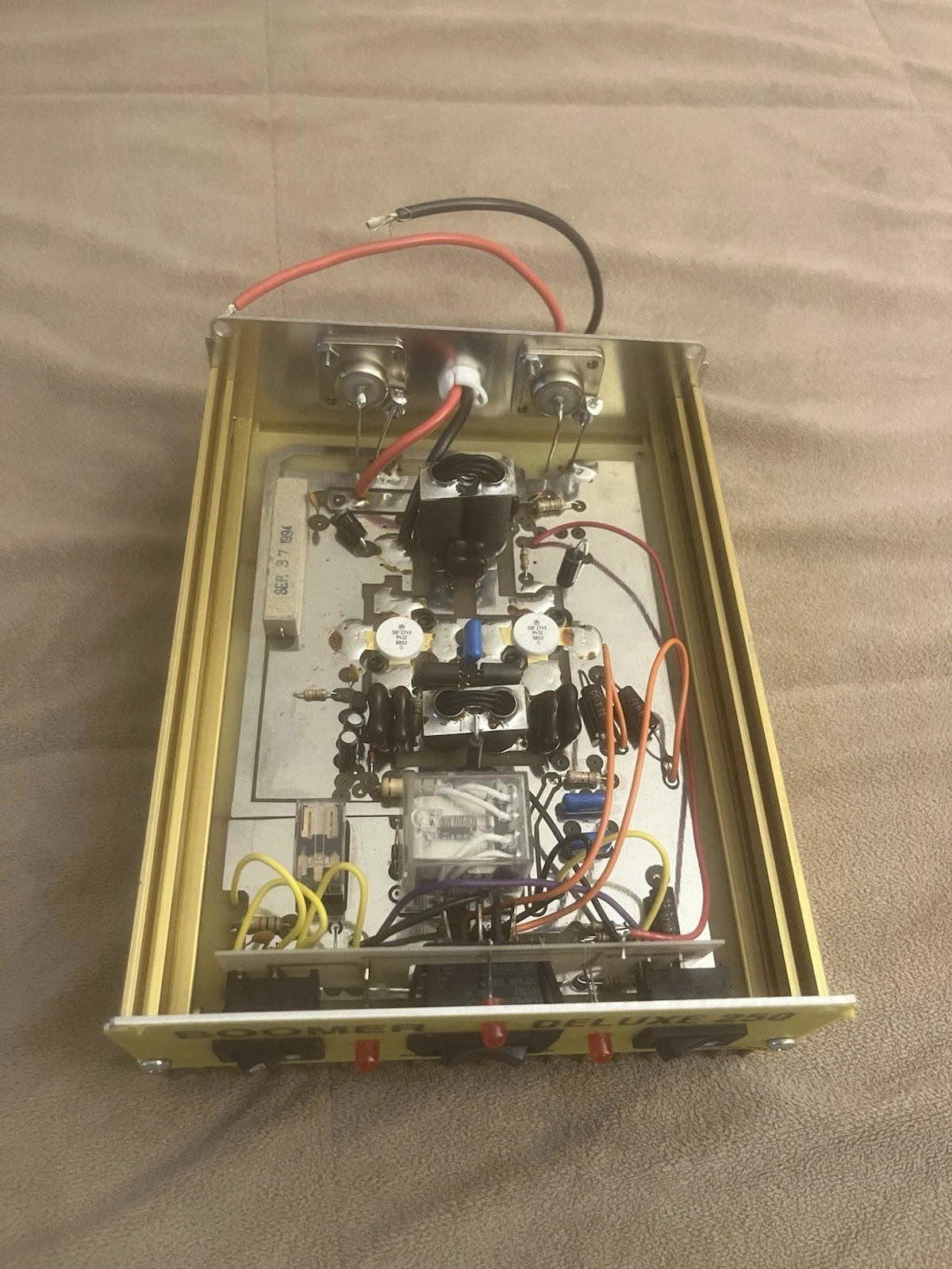

Damn.. I mighta pulled the trigger too early. :( This isnt it, but the yellow colored one. No sign of it being a Class AB1?
This is one of many vertical transformer amps built that has a simple bias on the board that has been disabled.
If you look at the input you will see a choke from the top of the input transformer to ground, effectively killing the bias.
This was done because when building them they found that the amp was very unstable.
If they would have fixed the bias and added negative feedback to help lower the gain a little bit they would have been a decent amp.
They made a lot of 4 transistor amps like this as well....
Jeff
