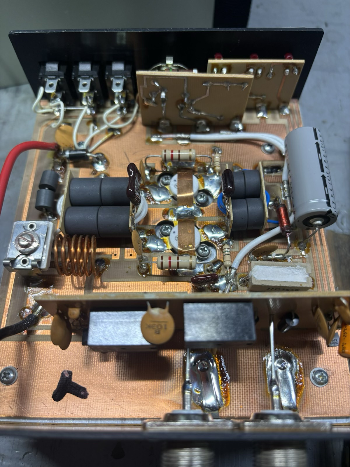

I run a MX-P50m amplifier with my KX2 when needed for SOTA activations. 40 watts output when not over-driven.

Messenger (biased), Texas Star, Palomar-Boomer-Galaxy, Commander (Palomar) are some of the ones I have used over the years. Most, if not all have been modded in some fashion that they could be considered home brew. Never a complaint.
