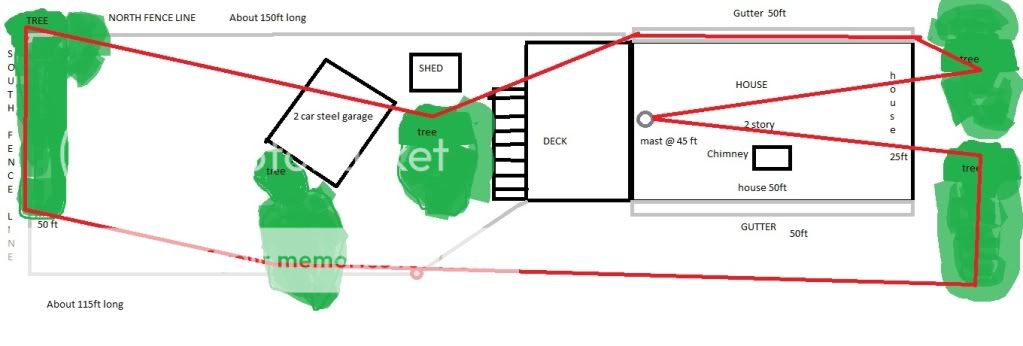

the other option is to shoot the wire into my neighbor's trees and / or shoot it over the rail road tracks at the back of my property... but it would have to be high enough to avoid the trains...
plan for 160m loop layout (wire in red)
Hmmm . . . not sure that sharp angle on the right side will make this work . . . maybe consider a 80m loop and locate it on the left side of the diagram instead . . . keep it away from the steel garage . . . that should work; especially @ 45 ft high . . . but if you have enough baling wire . . .
well I could bring the mount at the mast out a little bit and not tie into the tree in the middle of the picture as for the steel garage it will be at least 20 ft above it
Put the loop at shown on your picture,
Be aware of the length of the wire, a few inches/feet could make a difference when tuning.
