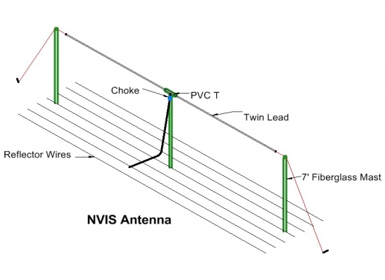

The only thing I can think of to add would be to setup a dipole and try NVIS with it, but I would not hold my breath.
Its certainly worth a try. Make a dipole up and put it up about 10ft or lower. Make up some wires the same length as the dipole and lay them on the ground below it as follows - ignore the twin lead part, just make it from single wire.
Reactions: Deleted member 337
