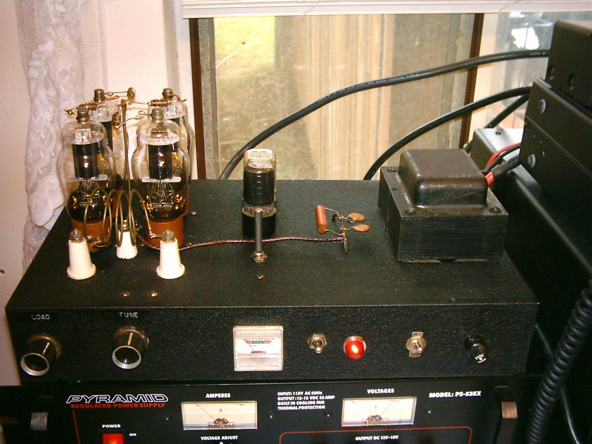

Hi,
Could someone possibly tell me what Amplifier this is ??
I was told it is an Elkin, But I don't know. I can't find anything on it. It runs a small driver tube, cant see any numbers on it. And 4 807s. Really nice shape. I'd like to know all I can about it. Please Help !!:headbang
Thanks in advance!
JWhawg
Elkin 4 tube?
Seen that pic on fleahooha.
Hi,
Thanks in advance!
JWhawg

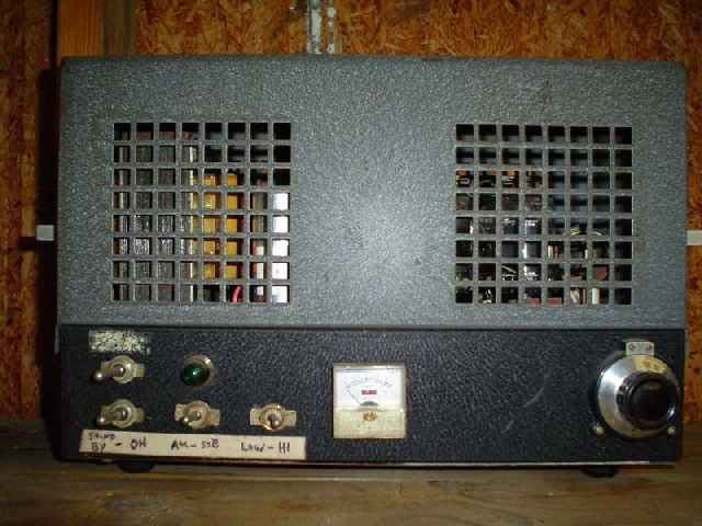

It looks like it was built yesterday and it has that "Elkin" looking cabinet.
I cannot see where the tuning control for the first stage is located but, it was designed for radios from the 4 watt era.
Expect about 500 watts out.
PS: If you wanna know more about it, take some more pics of the inside and if you can, take some voltage reading; then, I can probley give you better than guess-timats.
As Slam Dunck said it is an Elkin case. But Ray at Elkin did not make his cases. At one time they were made by a company in Texas. So there are quite a few Elkin look alikes out there. Most of the Elkins of that era wire link coupling and used 1625 tubes. Later they had 6QD6 then 12DQ6 and last the combination 12DQ6 driving 8908's.
If you could show some inside pics that would be helpfull as determining it's capabilities.
Thanks for the Replies !!

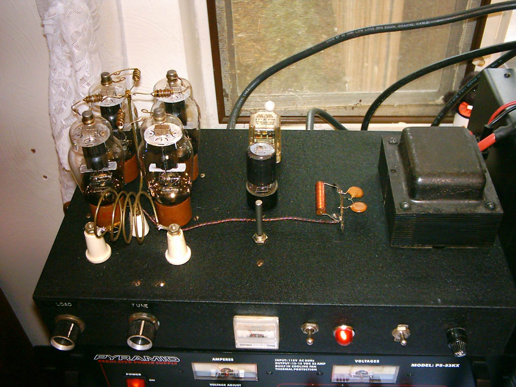

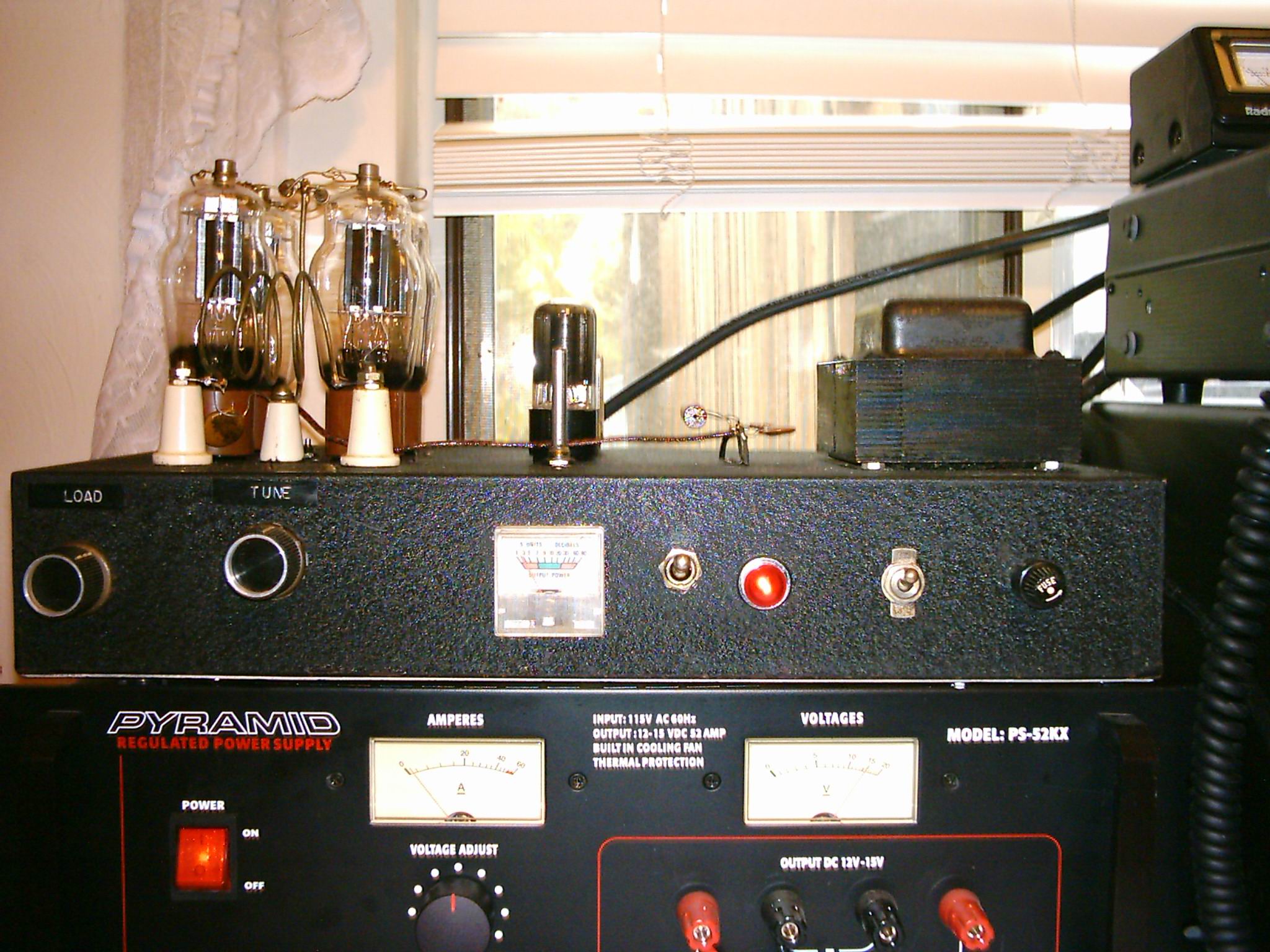

Here are a few pics of the inside. The small tube is a 6v6. The others are the 807's. There is a small pot right btween the 807 tubes, I would think that would be the adjustment to "equalize" the tubes?? Another large shaft sticking up from the deck. I think its a knob. Maybe to a capacitor or ?? for adjusting What ?? I'm not sure, I have not disassembled the case Bottom. It also has a KRP14DG 110vdc relay on the deck.
Hope this helps someone deturmine what this amp might be.
Thanks again!
Joe

To the left of the transformer on the deck, there is a choke; this is the B+ (Plate choke). There is a wire running west from the choke to some point and then it goes vertical to supply B+ to the tubes (Where the parasitic suppressors are all tied together).
The Tank Coil is between the two porcelain insulators and is tuned via the variable capacitors under the deck.
The 6v6 is part of the keying circuit used to close the 110 vdc relay.
I take back what I said about it being built to be driven by a 4 watt radio; it is a single stage amplifier and it will accept high drive.
The power transformer looks kinda small so, adjust the expectations for hi power accordingly.
