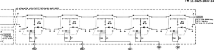

Ok, so the life of a hobbiest. I am aligning a radio and having trouble with the receive alignment. I play with everything but it turns out that my HP 8660C signal generator is not working correctly. When I go from -80dB to -70dB the signal drops out. It's a battleship of a piece of equipment but it may be time to replace it on a budget. What are you using that would be considered a budget buy?

It is just a radio, try fixing it. Since it works on -80dBm, all of the synthesizer stuff works. That narrows the problem down to the attenuators and the switches between them. I bet there's a schematic out there for it somewhere.
This is where one of those carlson super probes or other audio tracing probe would shine. Set that thing to output modulated AM signal and follow it until you lose it.
Ok, here we go, found it. The attenuator schematic was in a different manual.
A13 is the attenuator module and it does use relays.
See how with no attenuation, the output is +10dBm? That means to have the output set to -80dBm requires 90dB of attenuation, or 2 of the 40dB attenuators and the one 10dB attenuator switched in. If going from -80dBm to -70dBm makes the signal go away, it suggests the relay that bypasses the 10dB attenuator is bad.
To test my bad relay theory, see if you can set it to --100dB (two of the 40dB attenuators, the 20dB attenuator and the 10dB attenuator in line), should have signal, and then go to --90dB (which would bypass the 10dB) and see if the signal disappears.

So here is the update for now. The attenuator is bad. The relays act a lot like a solenoid and one of them is bad. I did order a replacement off eBay and it should be here this weekend. We shall see. These HP higher end generators are built like a spaceship. Holy smokes is it impressive......
