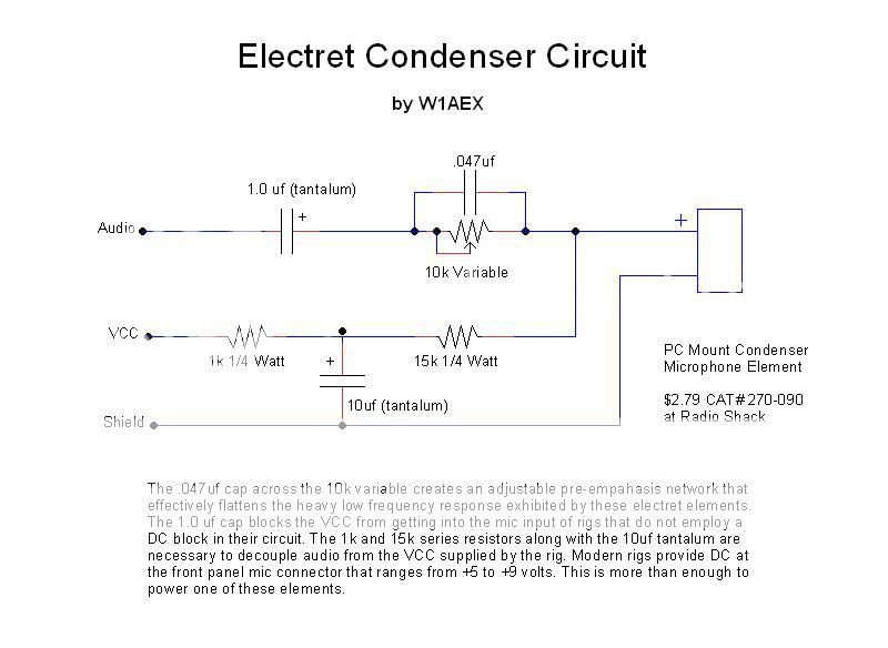

Or he could save a few bucks and build the microphone himself from scratch...

That is very similar to how I do it but I normally do not use a variable. I just try different resistors until I find the right one for my voice, mic element and the radio. A variable would be a lot faster and I can see where customers would like it too so you could easily tune it to anyone that buys it! My voice is not too far off from Darth Vader's.....LOL I hate the sound of my voice I think I sound like an Ape but other people tell me I have a nice speaking voice. So you will never see me doing any mod to get more bass in a radio! LOL I wish I had more high's in my voice especially on the radio! My voice would be great for Broadcast Radio but CB is not broad cast radio! LOL
