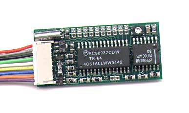

Some of those 10M repeaters need pl tones to open. Is it possible to add tones to a radio that never had them? ie. Kenwood TS-940? It has FM, but I am not sure I could add a tone board to it or not?
you could but it might be alot of work?....:blushing:
[SIZE=+7][FONT=Verdana, Arial, Helvetica, sans-serif]TS-64[/FONT][/SIZE]
Microminiature CTCSS Encoder-Decoder
Features:
  • The latest and smallest programmable CTCSS encoder-decoder for use in FM transceivers.
  • Select from 64 preset CTCSS tones between 33.0 Hz and 254.1 Hz using six PCB jumpers.
  • Tone stability is crystal controlled with an accuracy of better than 0.05 Hz.
  • The time-out timer may be programmed to eight different intervals.
  • Receiver High Pass filter and busy channel lockout are included.
  • Generates "Reverse Burst" and P.T.T. Delay for squelch tail elimination.
  • Hookup is made with color coded wires, microminiature plug and socket.
Specifications:
  • Size .78" X 1.70" X .25"
  • Operates from 6.0vdc to 20.0vdc @ 8ma.
  • Decode sensitivity is 15mv. RMS
  • Operating temperature range is -30°C to +60°C.
  • Encode output level adjusted from 0v to 3.0v.
  • Squelch control transistor can either be switched ON or OFF with PCB jumper.
TS-64 Encoder-Decoder
