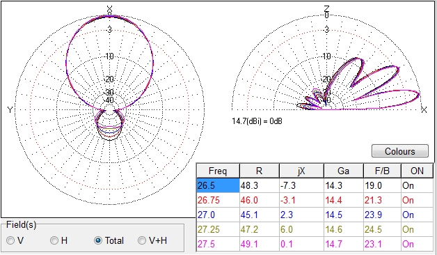

I am definitely not limiting myself to these three options. Rather, they are just the ones I know about now and am evaluating. Is there a good commercially available directional antenna available on the market that does not use a gamma match? My knowledge of the technical details of antenna engineering is very limited.
Thanks.
No idea for US market, but in EU most of them are direct feed.
For example: http://gb312.pl/?page_id=1325
200$ plus shipping.
