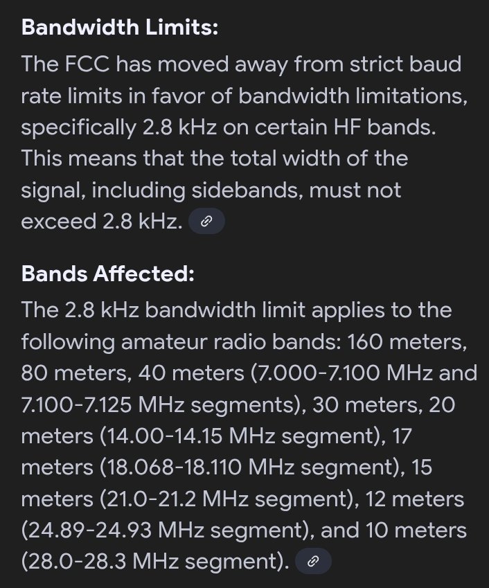

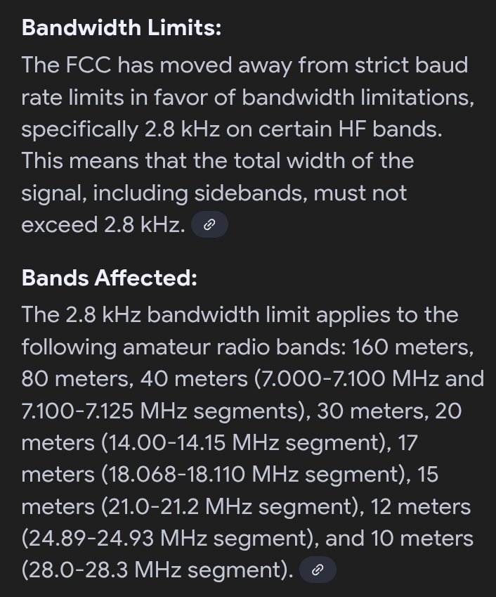

This FCC requirement is specifically related to DATA transmissions only, and not voice.
(I'm not in the USA, so I'm not sure what the USA voice bandwidth requirements are).

News​
Bandwidth Limits Replace Symbol Rates on the HF Bands, Other Bands Open for Comment​
12/08/2023
The Federal Communications Commission (FCC) published new rules adopted last month that replace the symbol rate restrictions on the HF bands with a bandwidth limit of 2.8 kHz. The new rules go into effect January 8, 2024.
The bands and band segments affected by the rules change are those authorized for data transmission between 160 and 10 meters, exclusive of 60 meters (where no change was made).
In adopting a bandwidth limit in place of the baud rate limit the FCC agreed with ARRL that some limitation is necessary because "without a baud rate or bandwidth limit, data stations using a large amount of spectrum for a single emission could do so to the detriment of simultaneous use by other stations using narrowband emission modes."
Note the words "Authorized for Data transmission " in the above quote that is missing from the previous post
