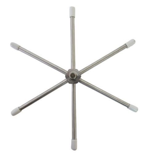

I take it this is the device in question?
I was having problems with antennas on top of my toy hauler. Looked into this mysterious device that claims to improve the antenna.
Through study of "Reflections ~ by Walter Maxwell" I found that the radials are not actually long enough. Radials need to be at least length of antenna. Not physical length but wavelength to increase performance. If you have a 1/4 wavelength antenna the radiators need to be at that same length for practical purposes. More radiators the better. It is possible to try to use more radiators at shorter length to improve GP effectiveness.
Lets say you have limited space radially, add more to increase surface area?
Back to the roof of toy hauler which is aluminum which is really a poor conductor. I fabricated a radial system out of 1" carbon steel box tubing. A much better conductor for the purpose. I made sure that the hub made contact with the shield side of coax. meaning I placed the isolation bushing on top of the hub so the actual antenna was not conducting with the GP radials. Length of radials was 4', with 4 radials. Result was not favorable enough to notice. Then installed 8 more radials out of heli arc welding wire or tig wire. Not much better. By extending the 1" box tubing radials out to 1/4 wave length or more only then did I see improvement.
After all that work, it looked like something out of H.G. Wells ~ War of the Worlds had roosted atop my camper. Hideous to say. It was not practical solution to my needs. Took up a lot of real estate, and could not be transportable, which was the goal.
If you research adding radials to the base of towers you will find that TV stations require 160 radials or more. Why? Counterpoise. You need surface area of good conducting materials for good counterpoise. That's why the center of your roof on vehicles is the best spot for Omni directional Antennas.
That neat looking thingy to attach to your antenna is not effective. Might look cool and boast improvement but that is erroneous information. It rates right up there with the StarGunn Antenna. Which is not practical or mathematically correct in antenna. You have to build a mathematically correct antenna to match the wavelength you will be operating on. Then tune the darn thing.

I love that PDF Redbeard, thanks again for posting it, very good info and discusses lots of misconceptions regarding antennas and SWR. I have a Sirio 2016 base antenna that's aluminum and is 18-feet tall, placed on top of a 25-foot telescoping mast, and it has 16 radials. It had good reviews on e-ham.net so I purchased it, seems to be working really good, not sure if the radials are doing much but I think it looks bad ass! I think mobile installation is a different story when it comes to ground plane kits which are most likely insufficient. The device in question (at least the one I have) is below. Similar to the other but has 2 extra radials. Below that is my base antenna. When it gets nicer out I'll try to raise it few more feet so it completely clears the top of the roof.
