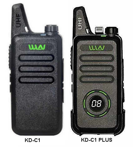

I was glad to see the channel display upgrade to my favorite UHF HT. The receive sound quality on the original KD-C1 is phenomenal and the new PLUS version doesn’t disappoint. I never thought a $15 Chinese HT would sound better on receive than any of the top 4. Other manufactures should take notice of whatever speaker / audio amp combo the KD-C1 is using.

On the KD-C1 you will have difficulty determining what channels are active in scan mode without a readout, therefore I rarely used it as a scanner. There are better options for scanning, much faster scanners too, but the new PLUS version at least makes that feature more viable. The PLUS version did some other upgrade features like scrambling and VOX, but I don’t have any need for those features. Simplicity is their strong suit, and I hope they keep them that way.

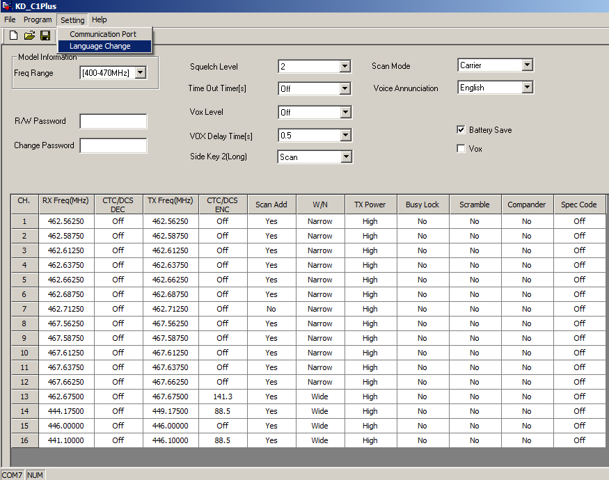

There’s one thing I forgot to mention before about the new plus version. The installation software and program was all in Chinese. Once installed, out of frustration I kept clicking on all the unknown options found among the pull down menus across the top. I soon hit on a button that got the result I was hoping for, everything in the program instantly changed to English, better yet the program saved that setting and continues to stay in English. Usually any language option is chosen during the initial installation. Hopefully they will get that issue fixed before too long.
If anyone needs further assistance with this radio, feel free to ask.
Unless you can read Chinese, this is a screen capture of my Plus setup that shows the location of that language button.
Unless you can read Chinese, this is a screen capture of my Plus setup that shows the location of that language button. View attachment 31014
