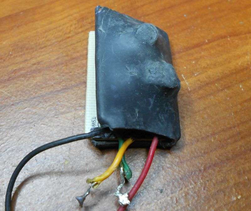

Here's a CB accessory that was a plague on the land 30 years or so ago. The Workman RF Preamp module.
Was a small circuit board with four wires, enclosed in a hunk of heat-shrink tubing.
At least they didn't encapsulate it in black goop.
Once installed, there is no relay to bypass it. Always on, can't be turned off. Not if you want to hear anything at all.

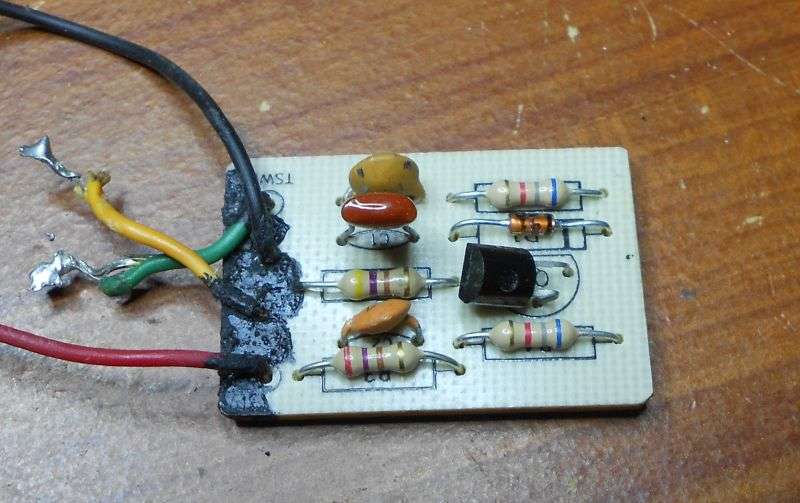

Pretty simple circuit. One transistor, one diode, three capacitors and four resistors.

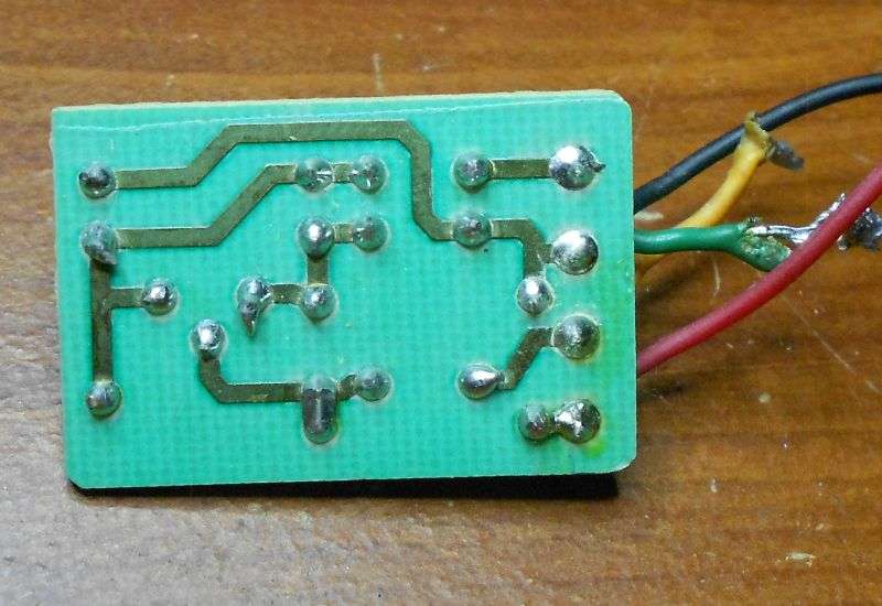

Solder side looks kinda simple.

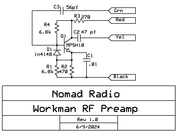

The schematic isn't too complicated, either.
The way the MPSH10 transistor is turned around on the board suggests it was designed for a transistor with a different pinout. No idea what type, but a long list of parts will work in this circuit.
