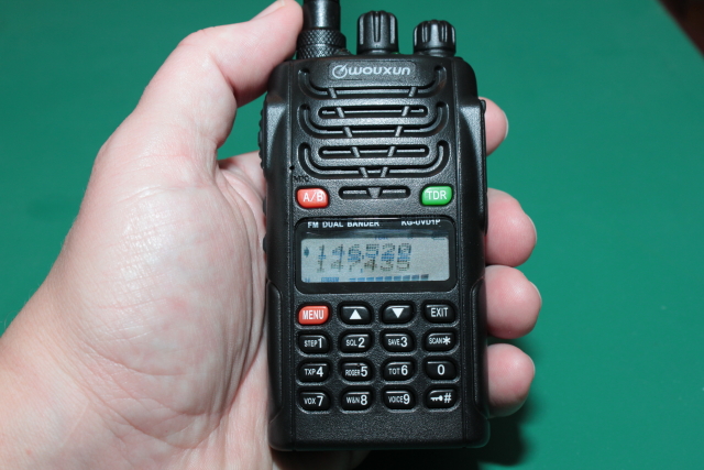

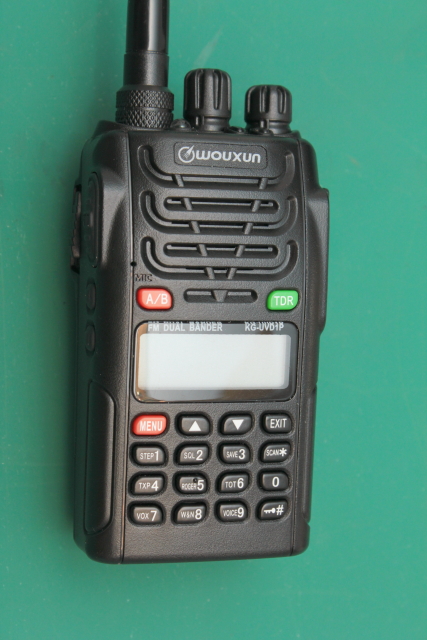

I'll first describe the physical characteristics before discussing the functionality of the radio. Here is a close-up picture of what the Wouxun HT looks like:
You can see that the button layout is very typical of most HTs in this basic, no-frills class. Most of the buttons are self explanatory, with the exception being the "TDR" button, which turns dual band on and off.

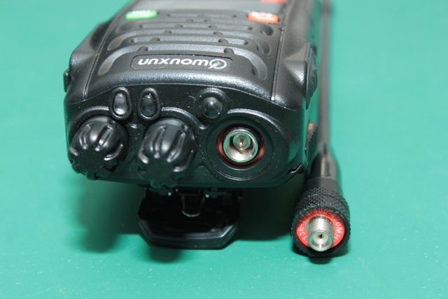

One of the first things most people will notice is that the antenna connector is not the typical SMA connector that we usually see on the mainstream HT's. The connector on these radios is the reverse SMA normally found on network router antennas:
You can get adapters for BNC or regular SMA if you wish to use a different antenna.

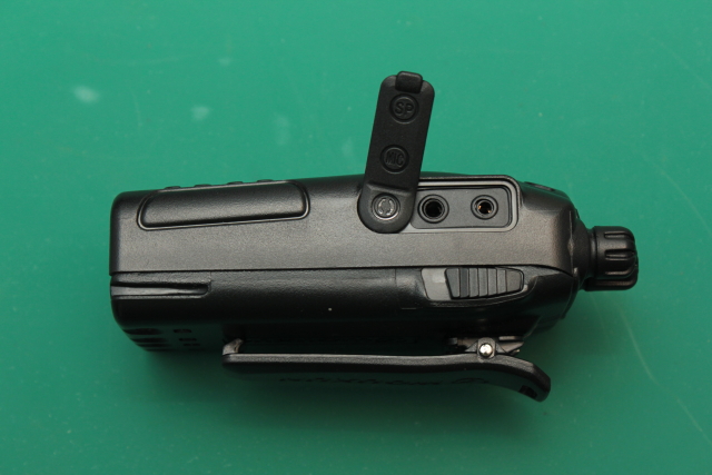

The right side of the radio is where the headphone and speaker jacks are located. These are the exact same configuration as the Kenwood HT's, so any Kenwood speaker/mic headsets should work fine...mine did.

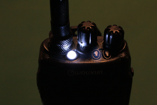

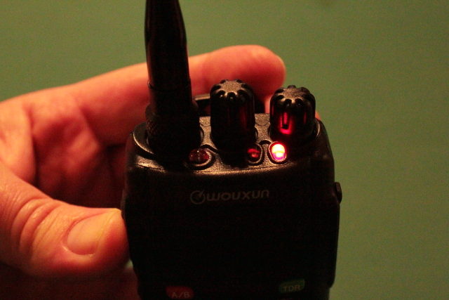

There are LEDs on top of the radio that serve a couple of different useful functions. The two LEDs to the right are for bands A and B. They turn green when receiving and red when transmitting:
Receiving:
Transmitting:
The larger LED to the left serves only one function: a flashlight.

Here is a picture of the radio in my hand to give you good perspective on it's size. You can also see that the display is simple, but effective.
