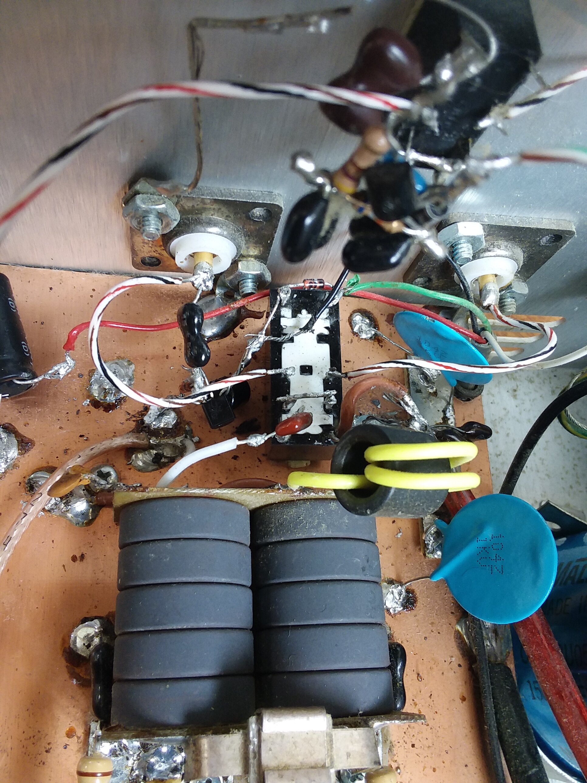

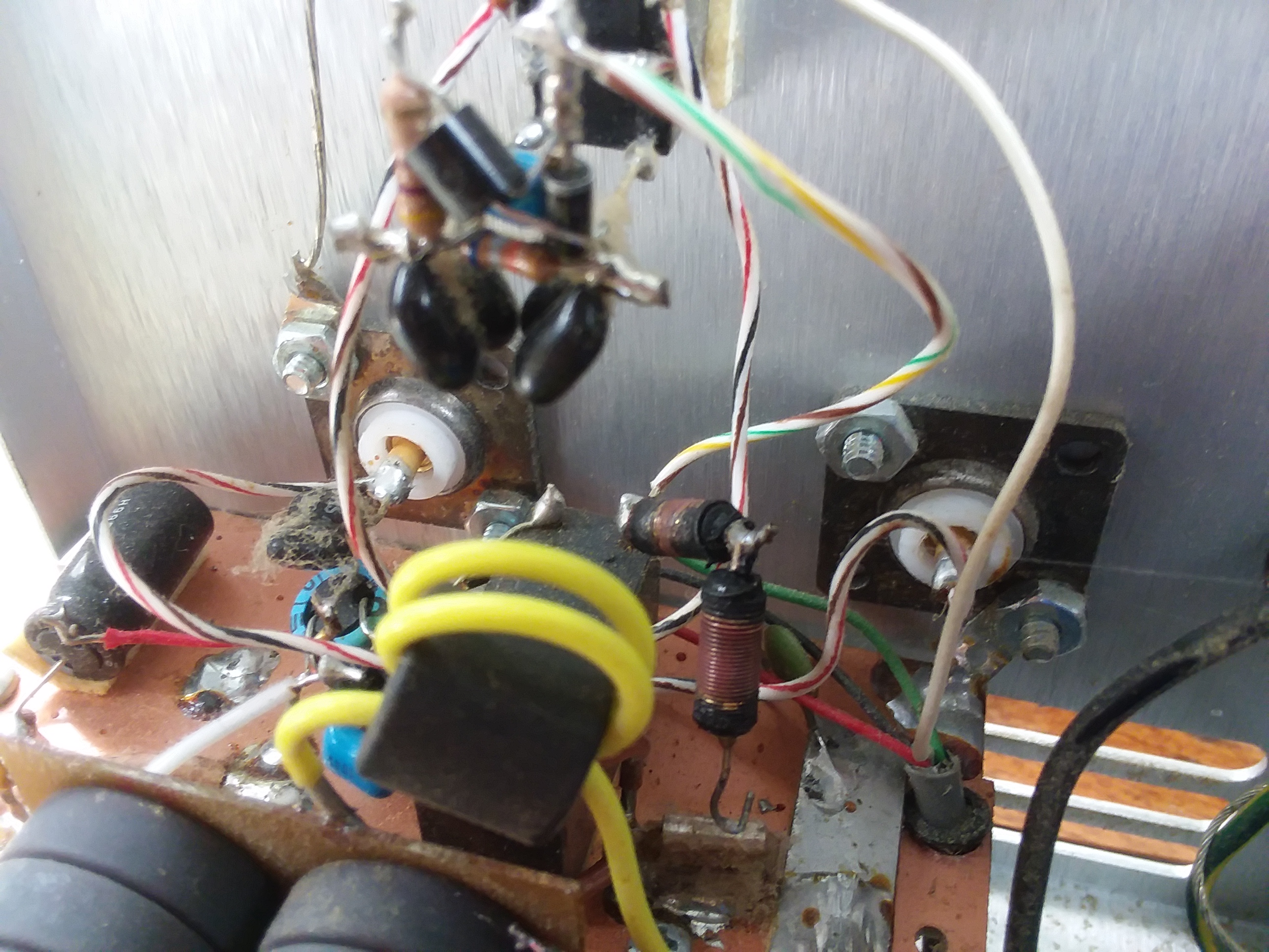

Hello all, I have searched, watched, and read as much info on this amp that is out there for weeks, and i am more confused than when I started. Quick story, I bought the amp as parts on order to steal the pills for a Texas star, that was a successful swap, it's initial problem as seen in 1st photo is that it burned the rf chokes off the relay..before pulling pills I used a 10uh Texas star choke across hot side of relay to bias terminal, immediately would sizzle when I turn the amp on..no rf..so i disconnected bias, preamp, output trans wire one at a time with the same results, so then I gave up and stole the pills. Since then I've rebuilt the key circuit, new relay, put a nice pair of hg's in there, I don't plan on hooking up the preamp...i also put a diode across the coil, it keys well...but where and what rf choke should I place across? What might blow the choke? The ab bias circuit maybe shorted somewhere? What should the bias cap at relay be in value? It has a .1 poly at moment, is that correct? Anyone out there with a clear pic of their black label base relay with this setup? I thank you all in advance for any input, 73's from 2 OP 095

Two things come to mind here, it appears that the circuit is injecting the 12V bias through the keying relay. In order for this to function properly there must be a DC blocking cap inline to keep the DC from directly shorting. I can't really tell if there's one from the picture. I usually use one at the antenna side as well as the input. The other thought would be the voltage dropping diode, if it were to short out you'd see the same result. The choke value isn't critical as it's just blocking AC, I'd use something around 2.5uH - 5uH.

Thank you Rick! That's the info I was looking for, oddly enough I finally found a useable pic online, wired it correctly, and boom!! Surprisingly with the awesome hg's I put in from eighteen electronics this baby fell right in tune with slight reduction of output tuning cap, awesome swr's!. I have a feeling the preamp was causing the burning choke, I did not rebuild that, I don't need it, it's only a.c. blocking cap is in the bias, not on input or output, I may put some in in the future, I will guess the same values as an Texas star? I may throw a choke across the relay in time, thanks for that info.. I am very pleased with my 450 watts peak with 60w drive, I don't think the screwdrivers will be back in there for a bit
Two more quick points, if I were to place a new choke, which terminals of the relay would I cross? It originally was hot 12v input to coil to somewhere else, would I span to output tuning cap/post on relay? Also, it never had a reverse diode, so i put one across the coil...
