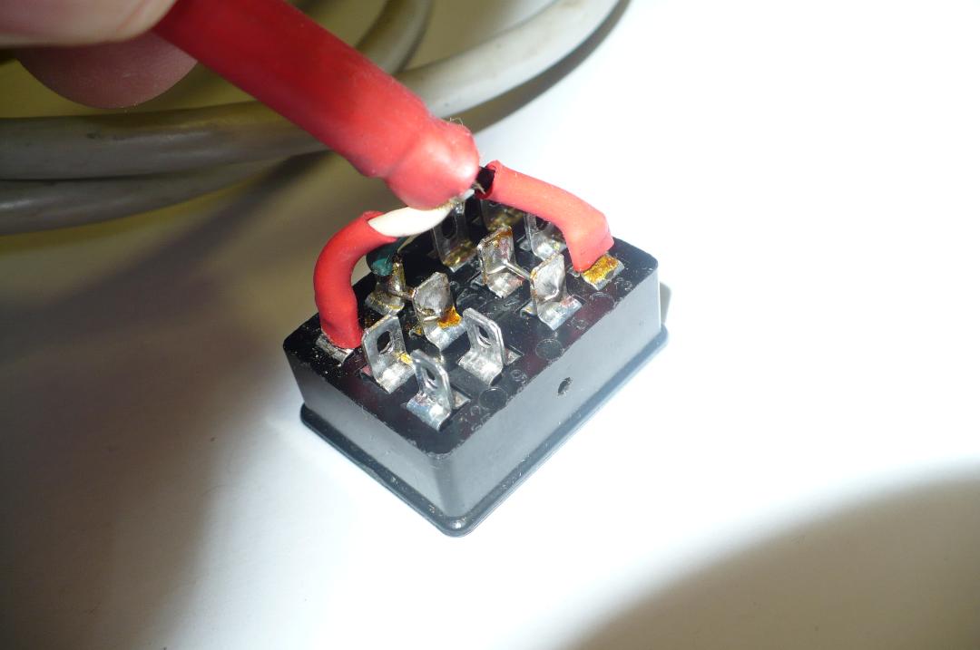

I bought a Yaesu 101E a couple of days ago had a power cord pluged into it . I went home and plugged radio in and poof smoke big time. Replaced 2 capacitors and a board copper ribbon going to them. I believe some idiot wired the power plug for 12v and put a 110v plug on cord. Here is a picture of it for a better opinion yours. I used a power cord from my other 101E but still cannot get radio to work and new capacitors get hot help please.

One common problem has to do with the numbering of the pins. The american-made plug starts from the right, looking at the rear of the socket end. The japanese-made equivalent numbers them from the left.
Or maybe I'm remembering that backwards. Takeaway is that they are opposite.
Might slide back the cover of the 'other' plug that you know is correct and see how they compare.
The published diagram is for the original jap-made plug. If you wire up an american-made plug by those numbers, you get a hookup that's a mirror image of what's correct.
Haven't seen this in a long time, but I do remember you get smoke.

Have a look at the primary hookup on the main power transformer. Should have the "117" taps connected. Parts of Japan use 100 Volts, and if someone moved the wires to those lugs, that would cause headaches.
