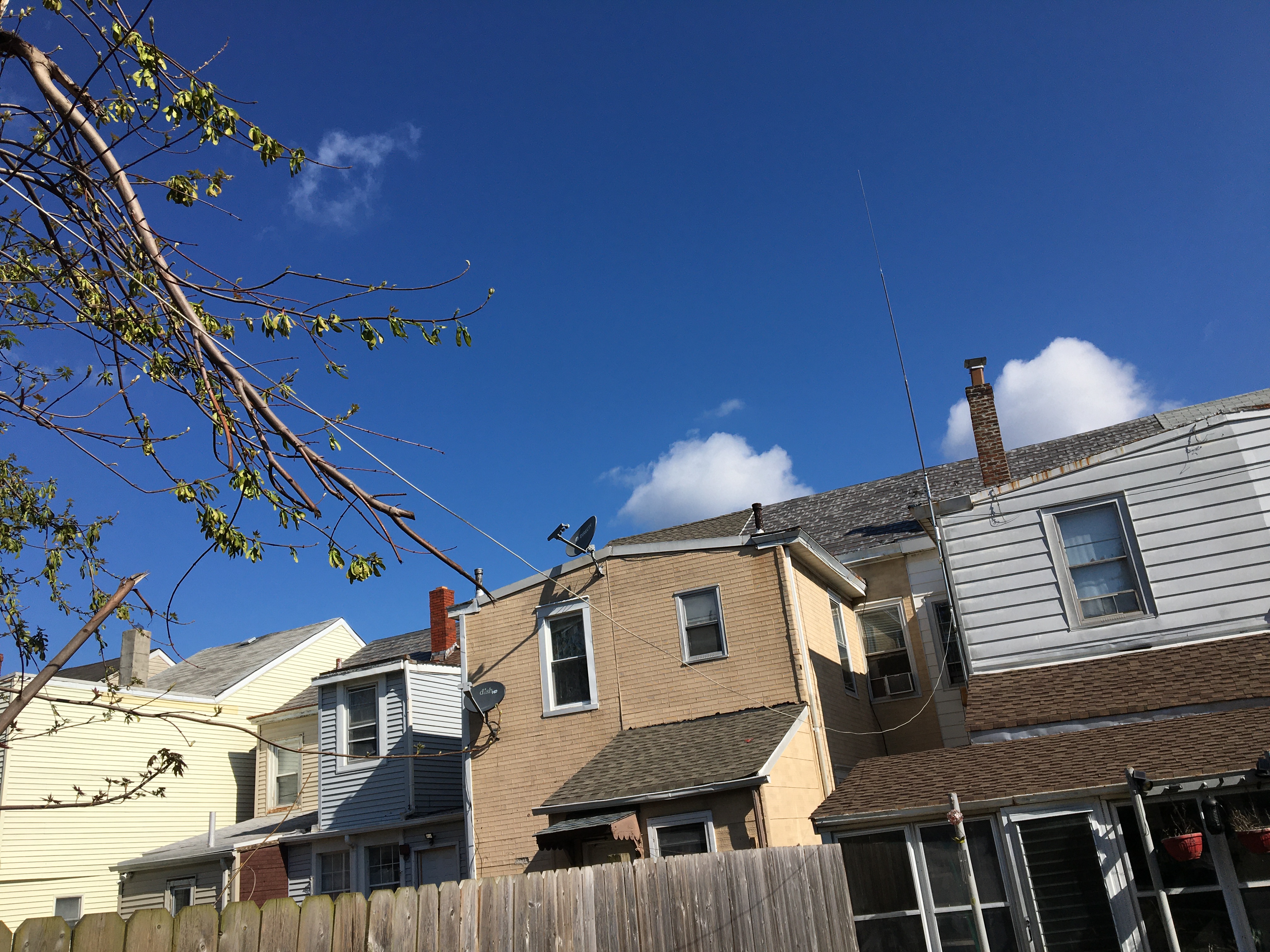

End fed on a slope about 16 feet on one end and about 12 feet on other and 17 foot of counterpoise and 25 feet of coax feedline.

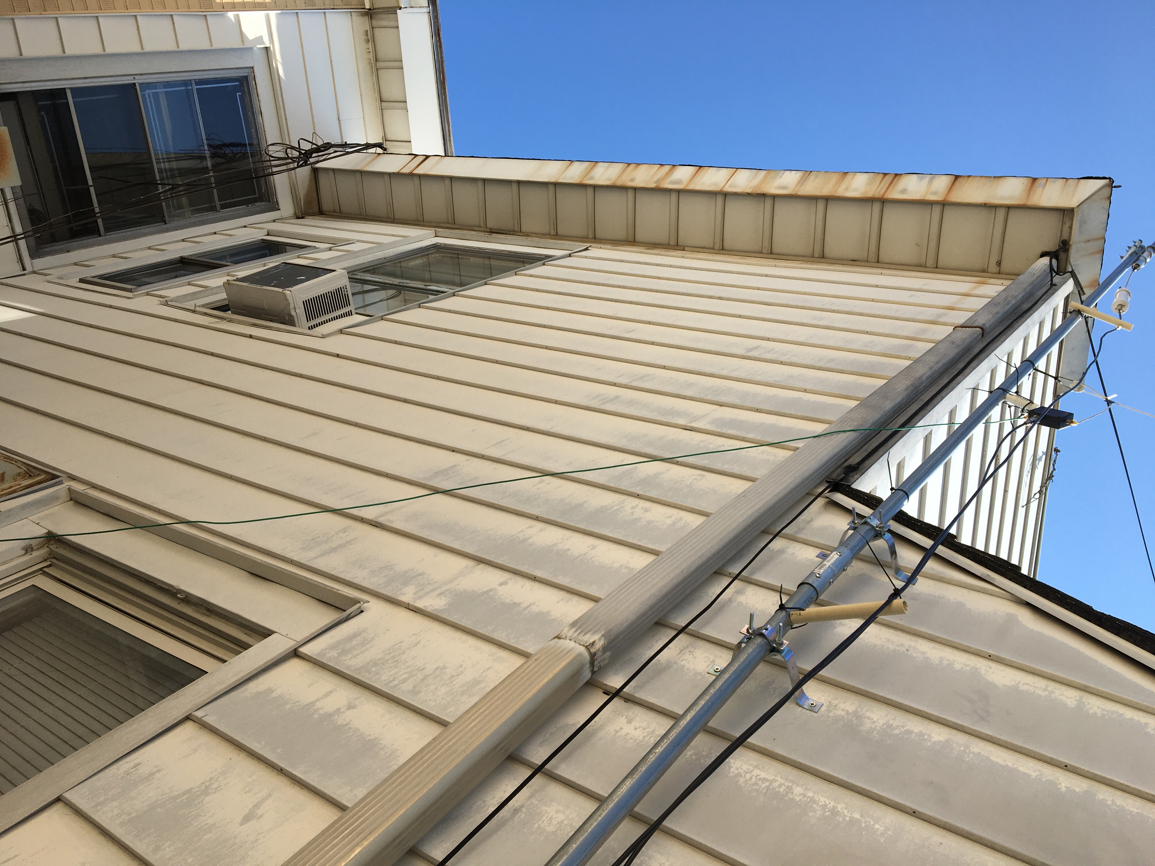

Here's the endfed (9:1). It's about 50 feet of 12THHN and from 14' up on house end and slopes to like 12' on other end to post in yard. Both ends have standoffs. Counterpoise is the green wire (12THHN) and is 17' long.
Maybe the counterpoise since it passes by shack feed point when coupled with ground wire at antenna mast point is causing RF loop??
The tuner likes the floating ground and uses it as a counterpoise. The counterpoise goes away when grounded? or Sounds like grounding it causes a ground loop?
